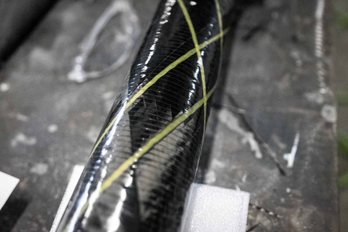

    Hey guys,
    I received this carbon driveshaft last week and was finally able to unbox for a quick product photoshoot.

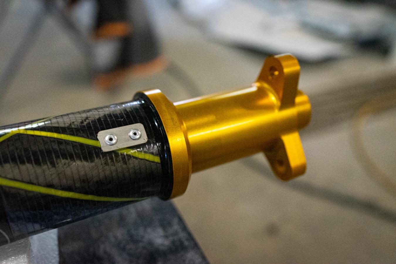

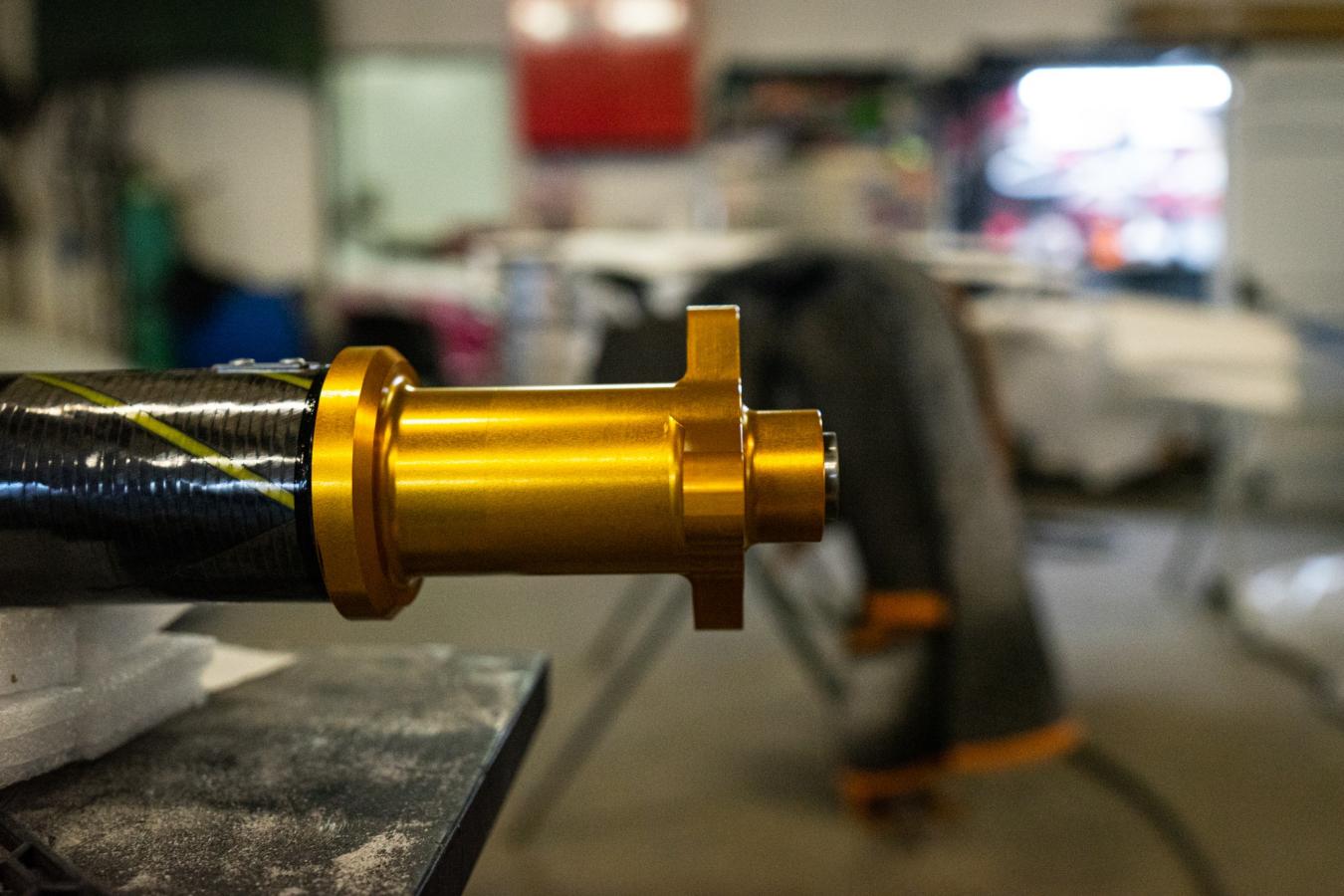

    This carbon driveshaft is made by YFCM Composites in Taiwan, the original patent holder to the self-locking flange since 2015. Thi design eliminates the probabilities of the carbon tubes ungluing from the flange.
    The primary benefits are derived from the lightweight 1 piece design: it improves connectedness to the rear end and slightly reduces initial moment of inertia. Clutch operations are also noticeably easier according to E9X M3 6spd owners due to the reduced flex in the 1 piece carbon construction.
    This retains the use of the OEM flex disc to eliminates vibrations. The driveshafts are balanced beyond 8,000 and use small riveted weights. They are warrantied for 1 year by YFCM.

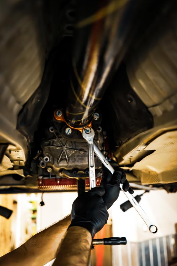

                  The E9X M3 driveshaft got fitted yesterday! E46 is next. Install was pretty straight forward and no surprises.

                            Got to install one of these on an E92 M3, quality piece it would seem, the customer was very pleased and no issues so far, and I'm confident this gentleman drives his car hard/does launches etc.
                            Installation was slightly difficult due to the one piece design and in the case of the E92 we had to move portions of the heatsheild away as to not allow contact but all in all everything was pretty easy.

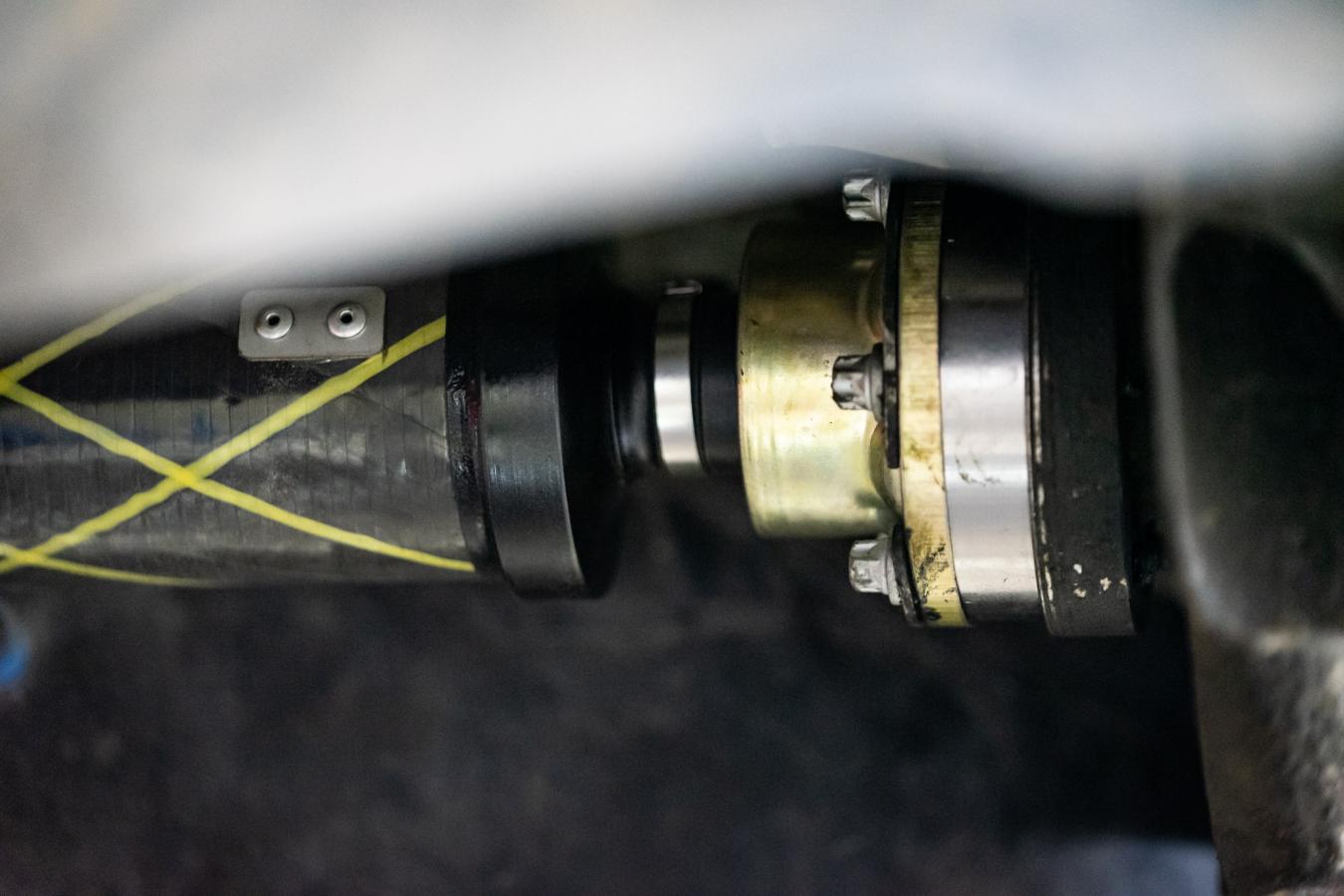

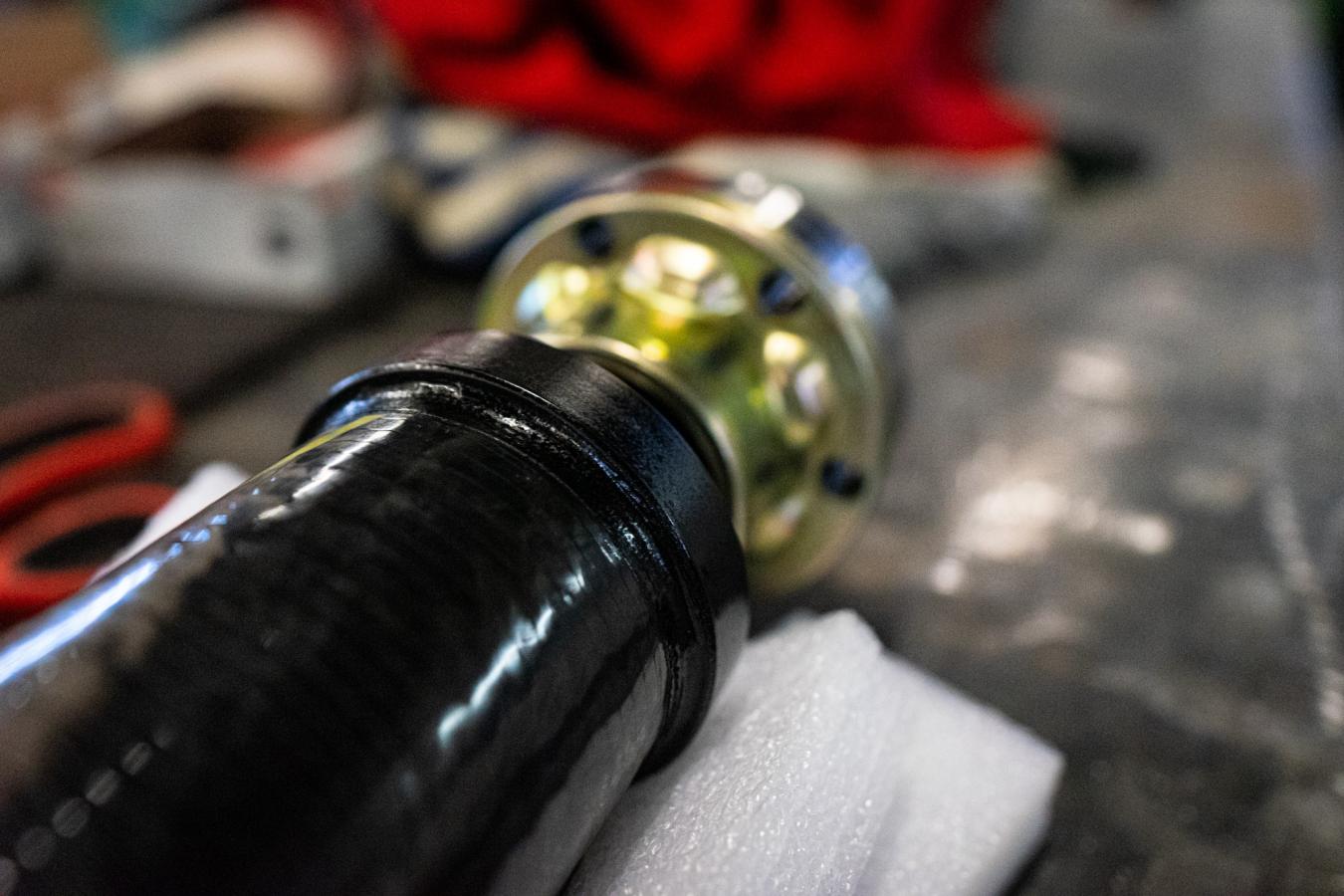

                              Your Guibo isn't installed in the correct orientation. The arrows on the guibo sides should be facing the flanges of the transmission output / driveshaft flange.
