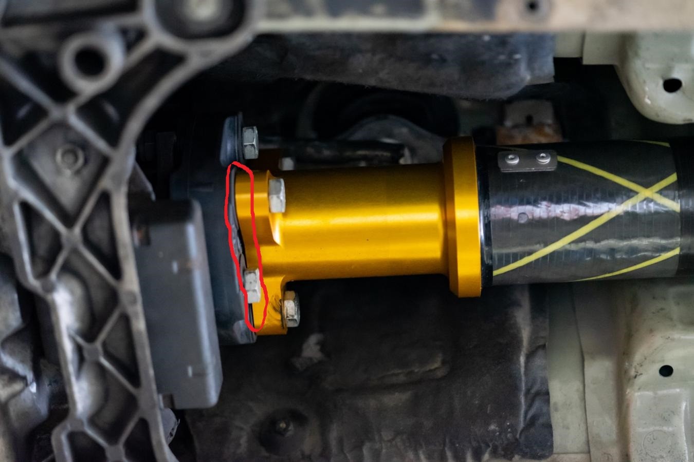

    Your Guibo isn't installed in the correct orientation. The arrows on the guibo sides should be facing the flanges of the transmission output / driveshaft flange.
    Thank you. I'm aware, the guys switched it over afterwards and I wasn't there to snap pictures.

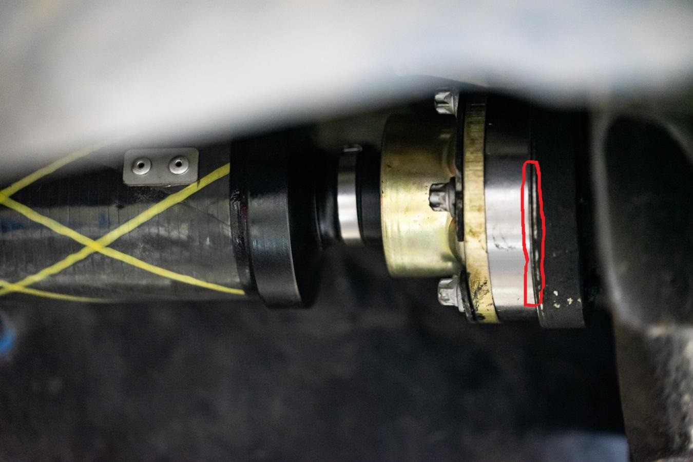

          IIRC, 0.7" longer and same transmission flange.
            I measured 52 13/16" (52.8125") from the front where the flange meets the guibo to the rear where the CV joint meets the front of the differential mount. These measuring points are circled in red in the attached photos.

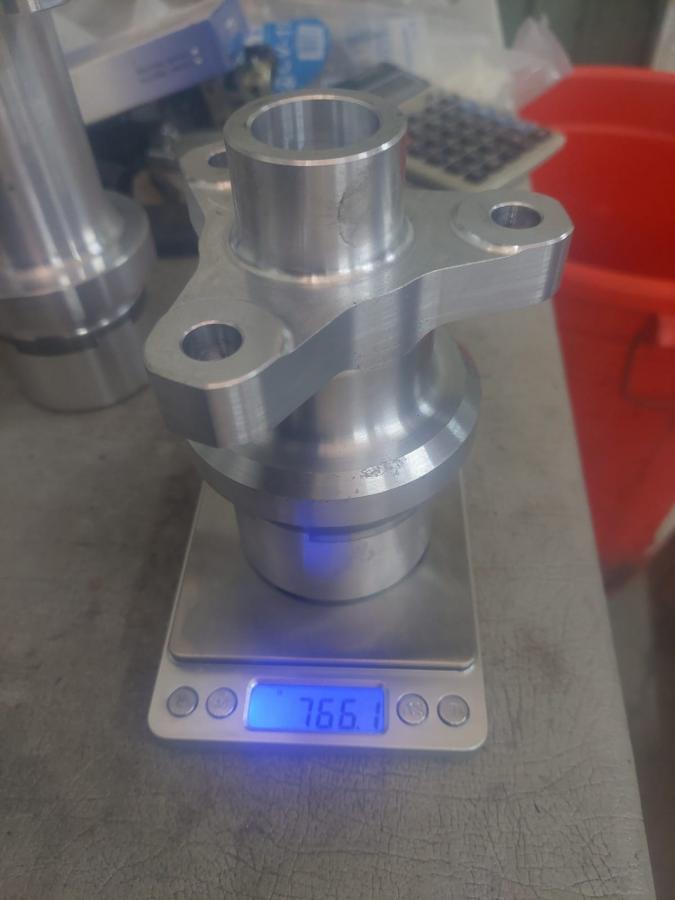

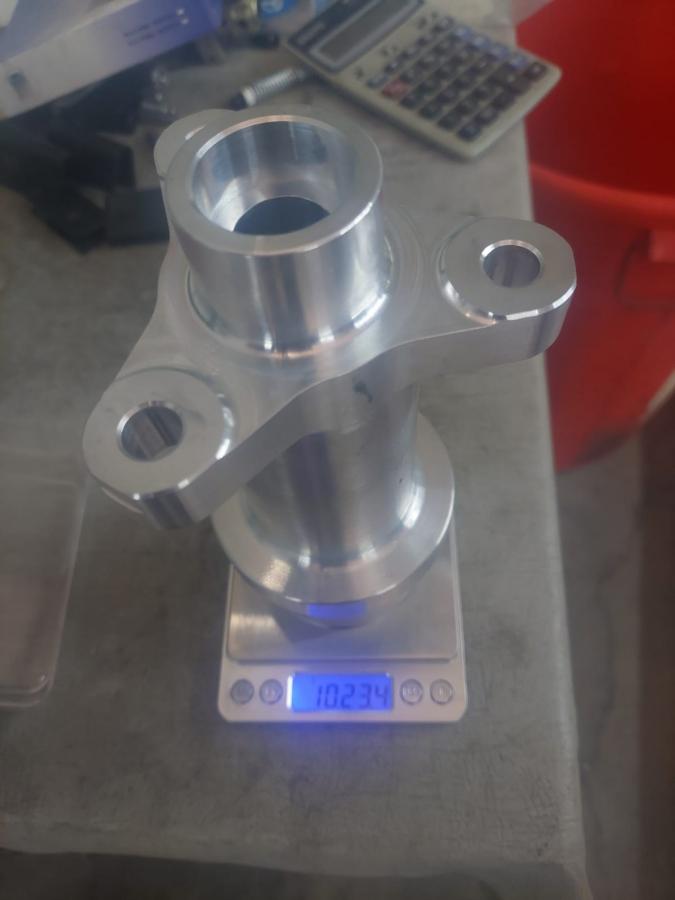

              Thanks guys. If we're running purely 5spd MT without restrictions of the SMG actuator, we could reduce the flange length - lowering weight and cost.
                So...its .7" longer if using an M3 guibo. 1" if using a non-M guibo.
                .7" longer sounds trivial (that's what she said) but I'm sure it adds quite a bit of cost. I wonder if there is a thicker guibo that would bolt on and reduce the lengthening needed.
                  Interesting data point!
                  The weight comparo between the SMG and 6spd flange: +/- 260 grams.

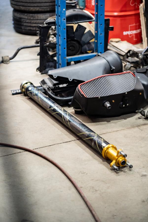

                          The carbon tube is winded . The pre-preg filaments are sourced from Toray Industries in Japan.
                            Yup, filament wound it is called, specific to high torque applications.
                              I finished writing up the installation procedure right here.
                              I will be launching the Winter GB shortly: 25% off is incoming.
