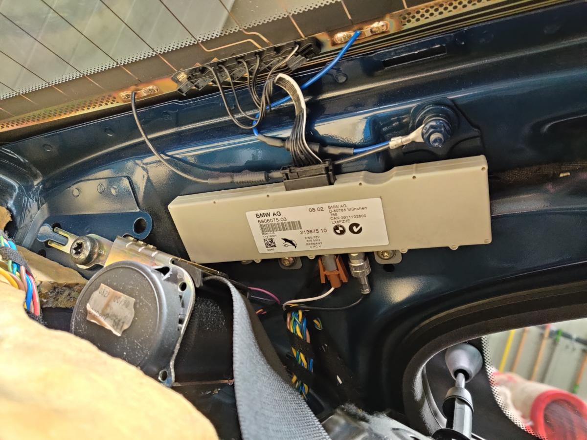

    Looks like this:

      So, I've since replaced the broken pieces in the lock and fixed it. Key locks and unlocks the door and will also lock the passenger door. Key fob still a no-go.
      Next idea is it's the RF antenna in the c-pillar or the gm5 module - any idea which one we think it might be more? I'm leaning towards the RF antenna.​ Is it underneath the sharkfin under the headliner?
      Continue to use the key lock for lock/unlock will break it again. The lock design was intended to be controlled by the key fob.
      I don't think your issue is the GM5, but the RF antenna wiring.
        On the output side of the RF Antenna(the wires that lead to the GM5), there is a wire that will give a signal when you press a button on the key, I don't remember which one of the wires. My key wouldn't work for years until I tested that wire and found that a signal was going to the car, then I realised the issue was with the car, ended up being a blown fuse. Just use a test light, it will be a dull light bcse I think it is a 5v signal.
