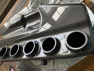

Karbonius Carbon Fibre Stock S54 Plenum
    For the weight weenies the Carbon box will also save about 5 lbs. Stock box plastic is very thick.

      I weighed mine and it is about 8Lb lighter than the stock plenum. The Eventuri is another 2Lb lighter than the standard air filter housing, so 10Lb all up.

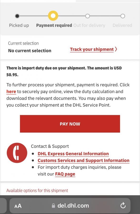

            Completely forgot about the “import duty” fee through DHL…

              50 is nothing, it was 400 for me!!! US guys are so lucky
                  That is 25% of the Karbonius box...😲

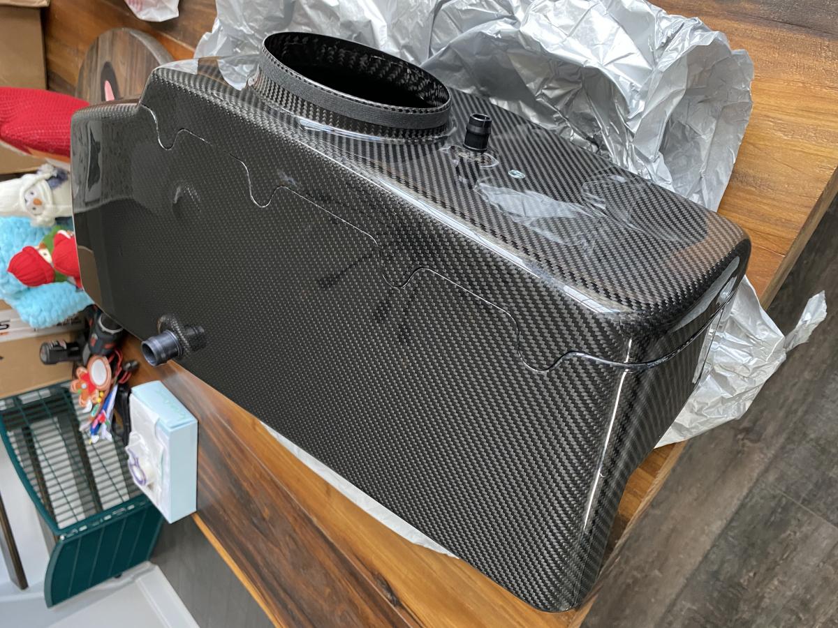

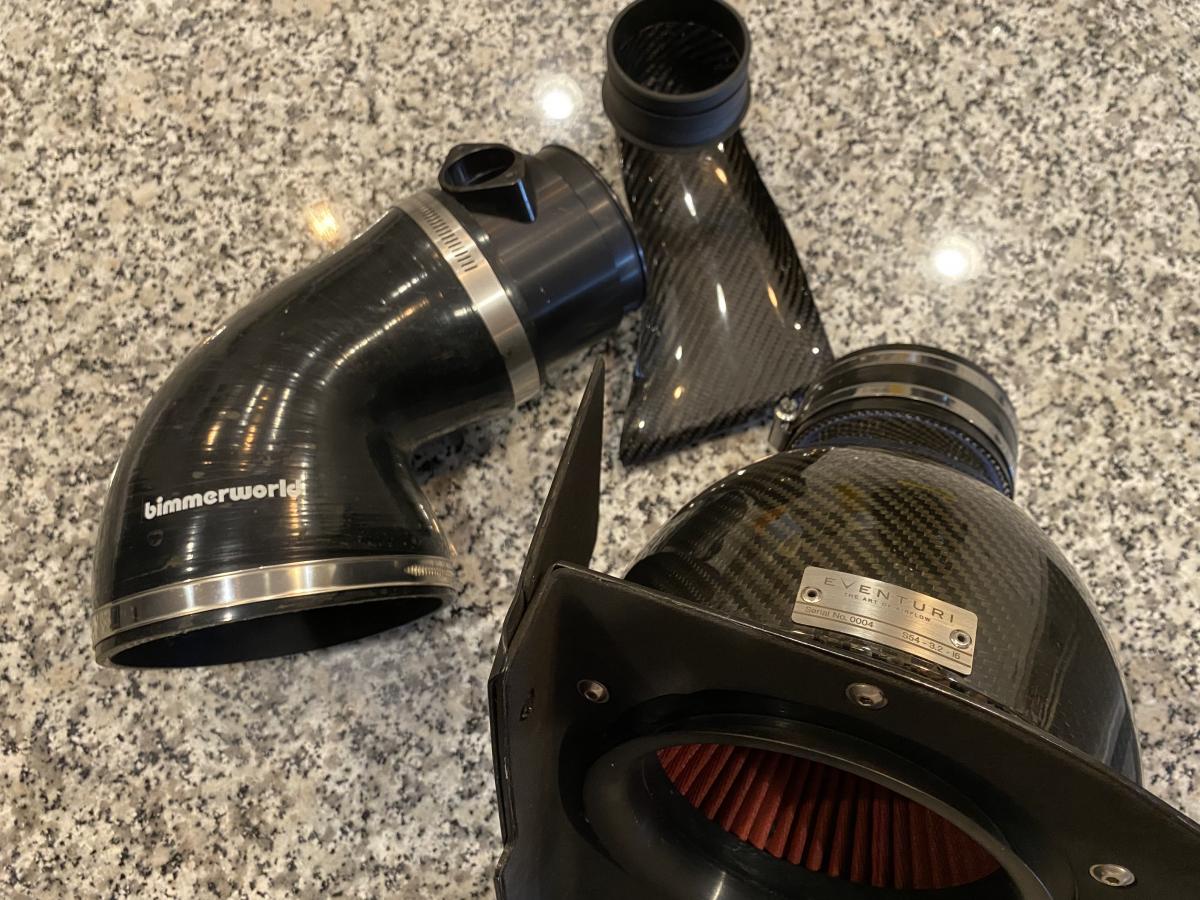

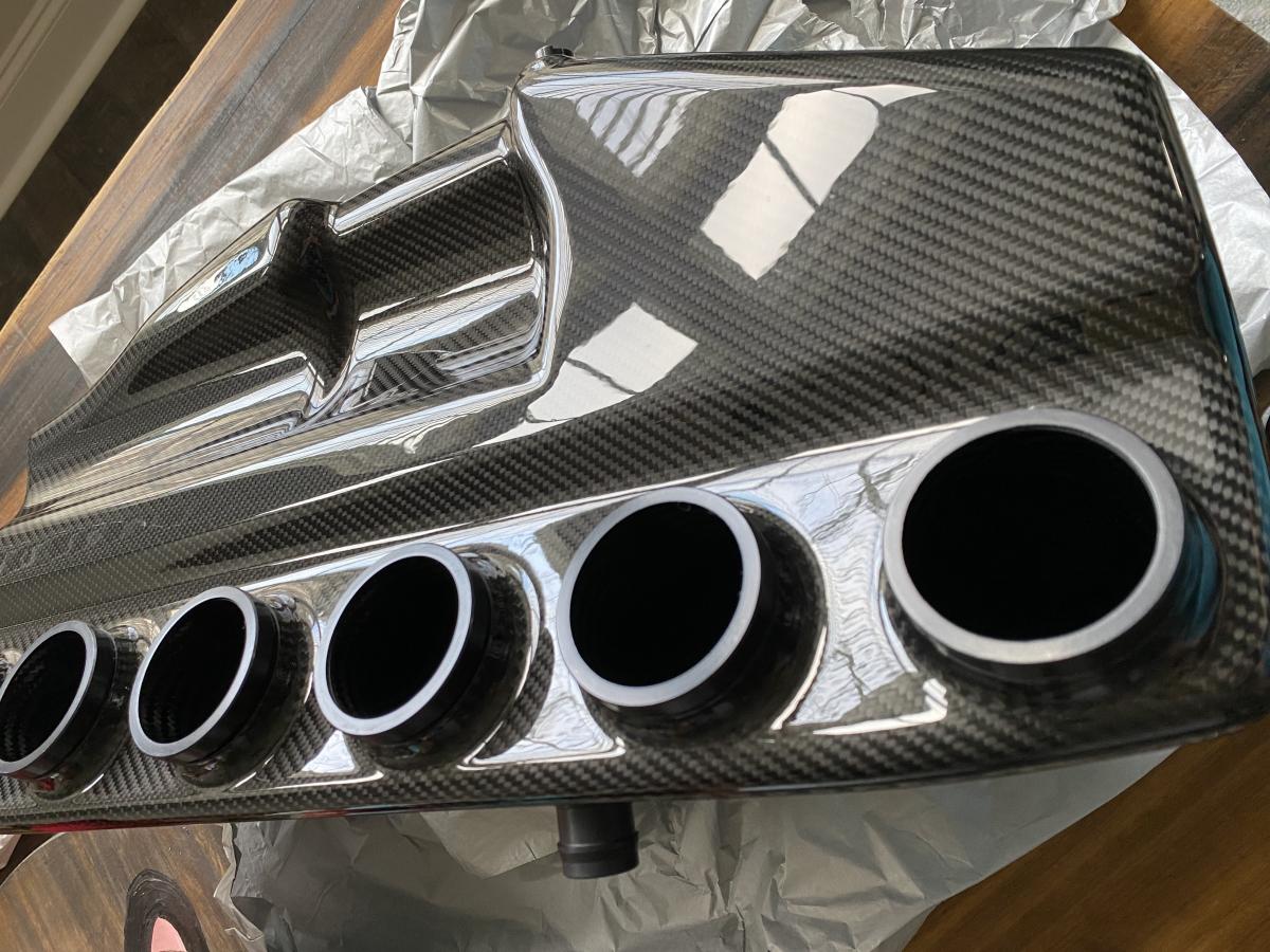

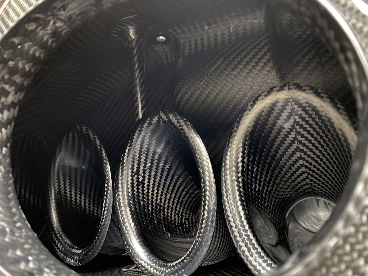

                    Will have to see what people have done to their oil dipsticks but it’s here. Going to install either the Eventuri or Karb box first.

                      I'd recommend eventuri first - once you install the Karb box, you won't have a chance to test eventuri only for comparison reasons unless you remove the Karb box and re-install it again which is a decent amount of work... instead, you can easily swap the eventuri/stock intake....

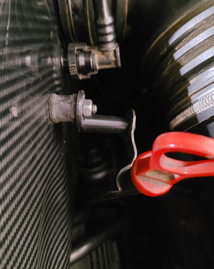

                        I bent my dipstick to the right and made a basic bracket out of random aluminum to hold it to the airbox.

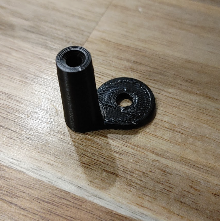

                                Designed a super basic bracket for the oil dipstick, because my aluminum screwed together L brackets unscrewed from all the vibrations and started clanging against each other every once in a while. Super annoying!
                                I hosted the file on my site listing for folks with a printer. Not super motivated to print these out for people because of how small they are and how basic the design is, but can do so for anyone needing one.
