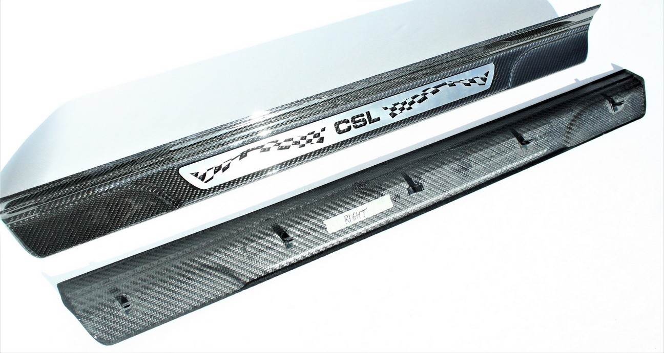

                    Karbonius does something similar to your option 3 with their CF door sills. Probably worth a shot to try and fix the ones you have like you described.
