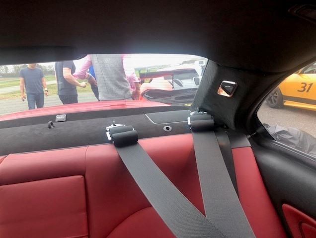

              Does anyone have pictures of what these mounts look like installed? I can't find one for the E46.
                #37
                Mine:

                    How was the fitment otherwise and overall install? Ive removed the deck a billion times so not too worried about that. Sucks this is the only ideal solution for a dual purpose car because I'm trying to get back out to the track and this is the ideal solution for proper harness mounting.
                    I also don't understand this statement "The R-1246 requires longer shoulder harness belt runs than our other harness mounting solutions. Only use the R-1246 in combination with harnesses where the harness manufacturer approves of running the belts 30-40" (depending on seat position) from shoulders to the harness mount points. Not recommended for drivers with seats in extremely forward positions (close to steering wheel), as harnesses may not be long enough to reach."
                    Schroth harnesses are plenty long. I'm 5'6 and my buddy said they should have more than enough length to reach. Hope that is indeed true.
                    Is this BK setup still worth ordering? Sadly am used to having to fabricate things to fit so if its not too bad, I'm very tempted to order. Does anyone have any pics of the installation under the deck?

                      Install is pretty trivial and the parts fit quite well. No complaints in that department. Worth mentioning that you lose the subs in the trunk. I was 50:50 on removing those for weight loss anyway so that made the decision easy. HK audio sounds equally bad as it did before
