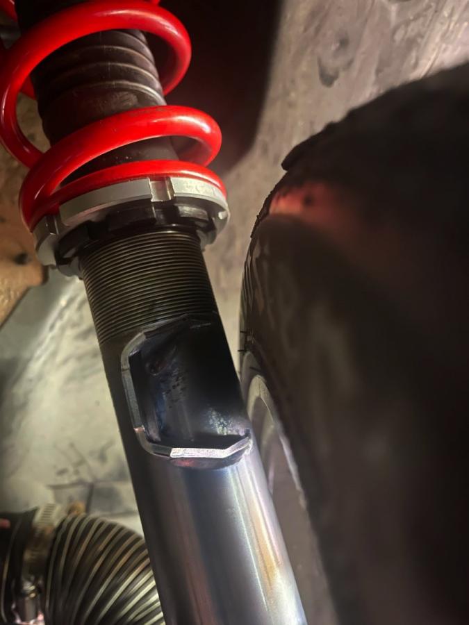

                  Here's what I'm talking about. This is at about 3.6* camber. The tire actually clears the fender without issue at the top of fender (I have flared and pulled the fenders). But the real clearance issue is where the fender meets bumper, which is where the width is really needed. Yes, the wheel is perfectly straight here.
                  It JUST clears here, but I've hacked a decent amount of stuff in there that I would rather not have. FWIW, with 60mm race springs, I only have about 3-4mm clearance on the inside, so going with a higher offset isn't an option.

                      it is.. just. The rim of the wheel is the closest. Again shows in 2nd pic below with another different 18x10.5 +25. There ain’t much room left, especially if trying to run say a 295 square. You may buy a few mm with a different damper body design.
                      Either way, I’m just not sure how much this buys you without the bumper to match. Also, if you’re running a wide enough front tire to need these fenders, then the leading edge of the tire will stick out far into the airflow. A wider bumper would also be of a large aero benefit (see: M3 GTR). These fenders look to be of motorsport or at least clubsport grade and with some (relatively) minor tweaks could be properly functional, IMO.

                        I don't know what that lower black thing is (weird end link mount? Why?), but it's cutting into your clearances for sure.

                          Yeah, end link bracket, ask Moton why it's like that. These are also full aluminium shock bodies so they're a bit thicker. I'll be moving to MCS soon which do seem to have a bit more inner clearance.
