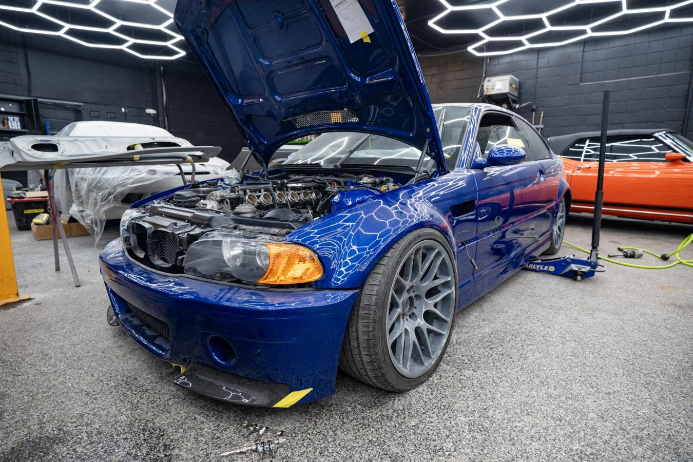

      Car looks amazing!
        I think you can fit a 12" rim in there using certain people's definition of fit bro.
          10.5”*
            Ahah - I can see some trying for sure. I'll be happy fitting a 10" with mild camber spacers, un-cut fenders, and a slight stretch.

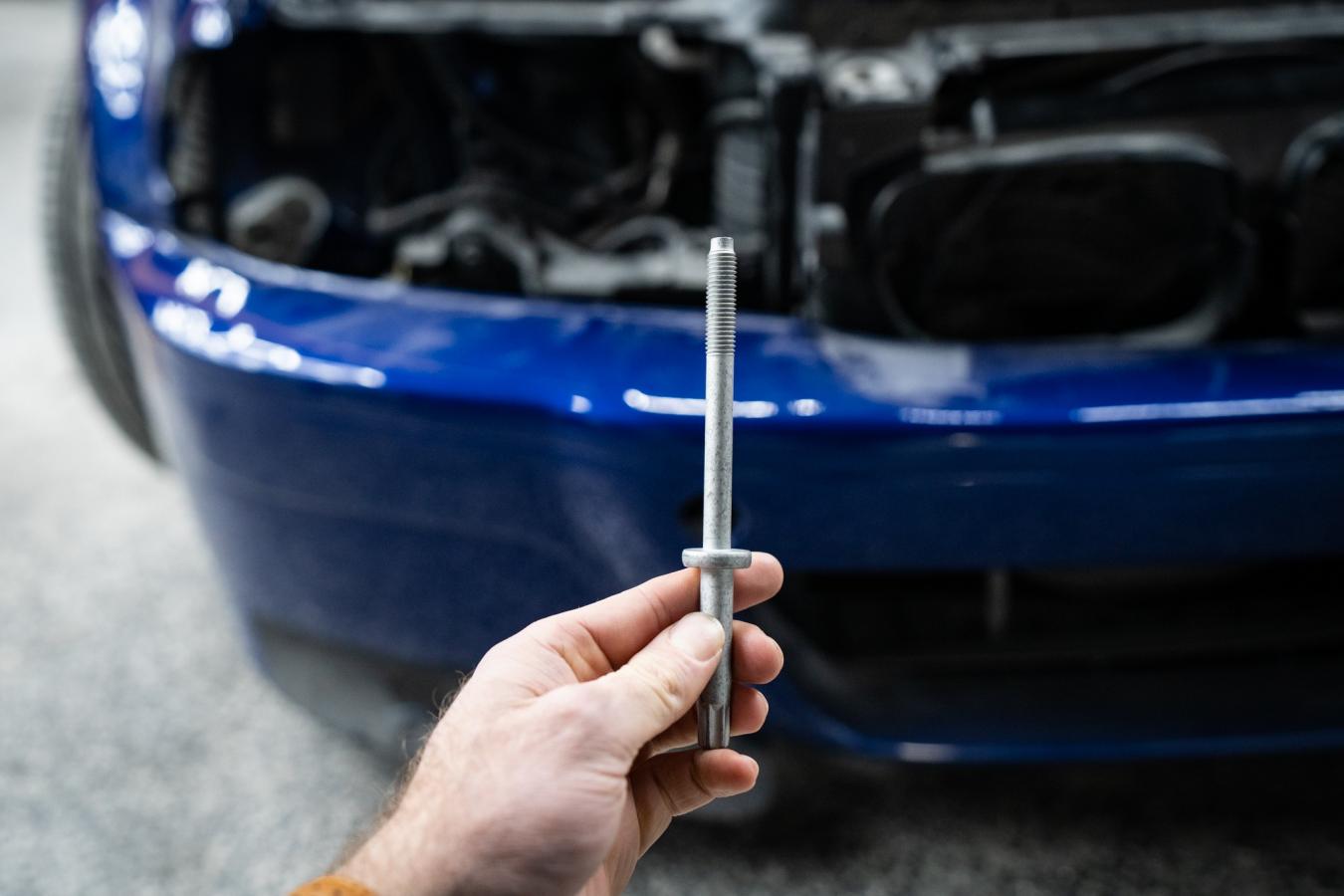

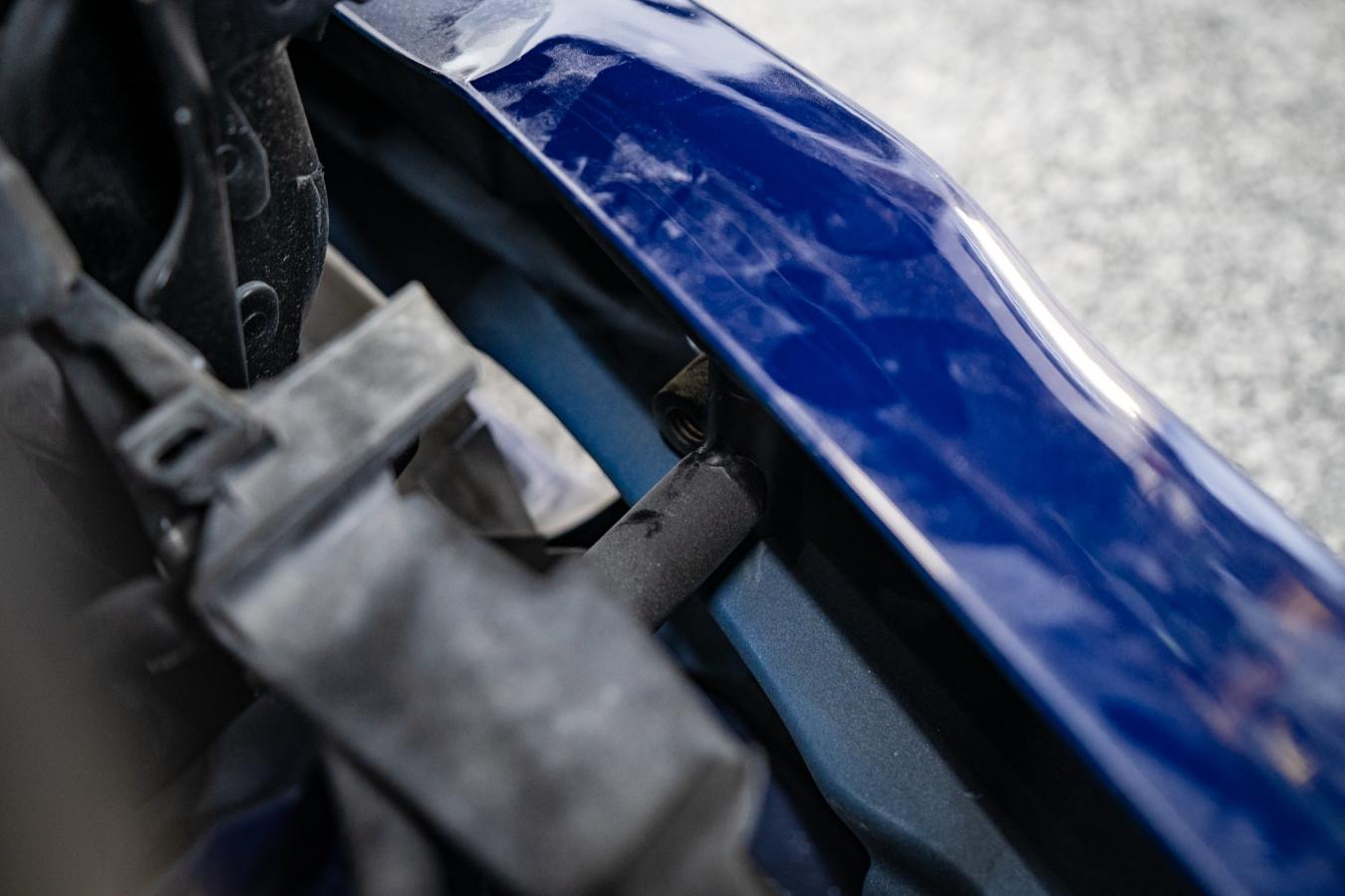

              Progressing on the CSL bumper final fitment and its auxiliaries.

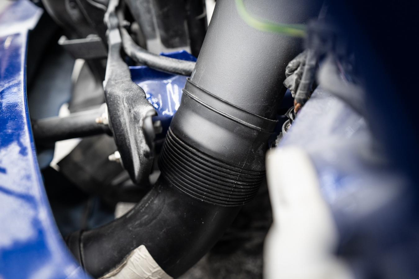

              1. The snorkel grill and inlet tube were successfully test fitted.

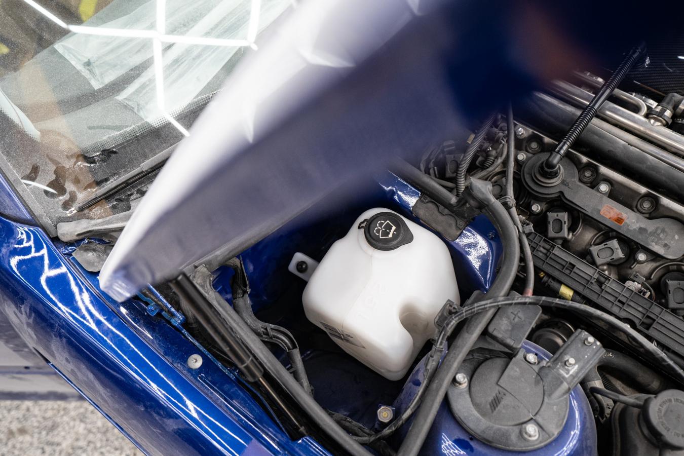

              2. The reservoir relocation from Brey Krause was fitted.
              3. The ASA bolt was threaded through the aluminum shock absorber in preparation for final fitment.
              The splitters have not be drilled yet, and we need to repair the corner threaded insert that got previously damaged for unknown reasons.
              The fenders and bumper will be bundled into a +/- 20% special for Black Friday over next weekend.

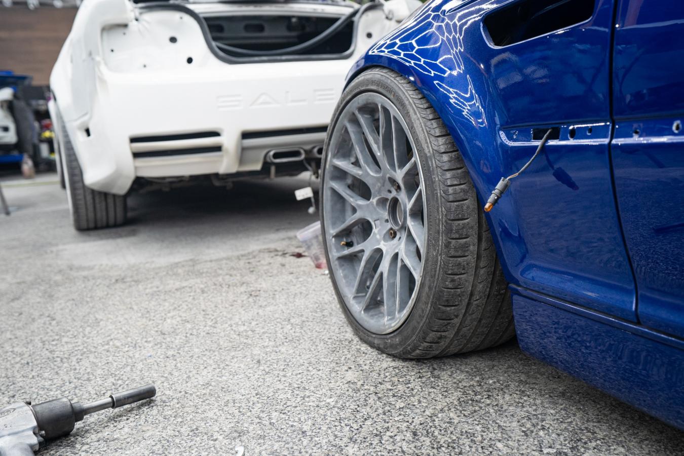

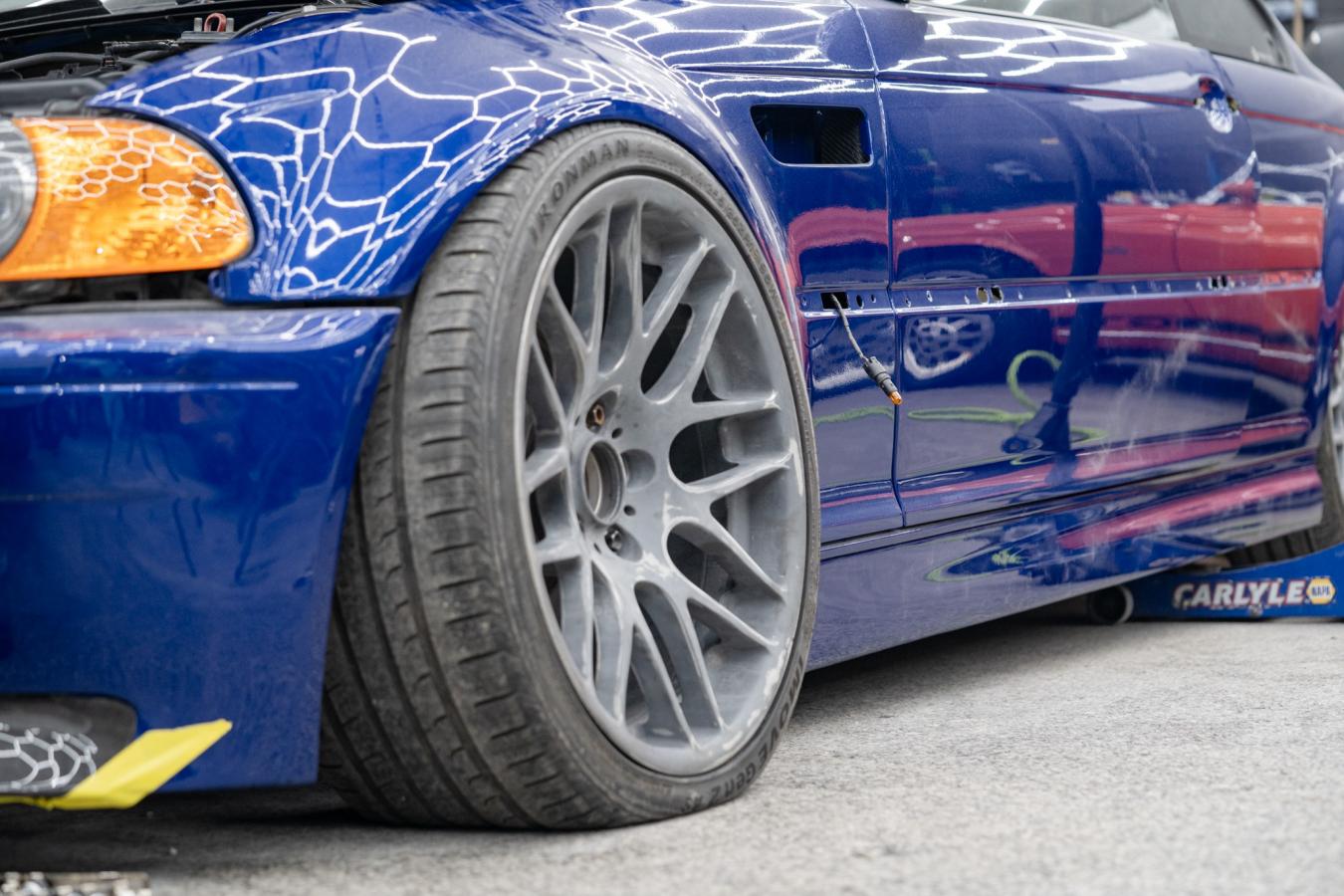

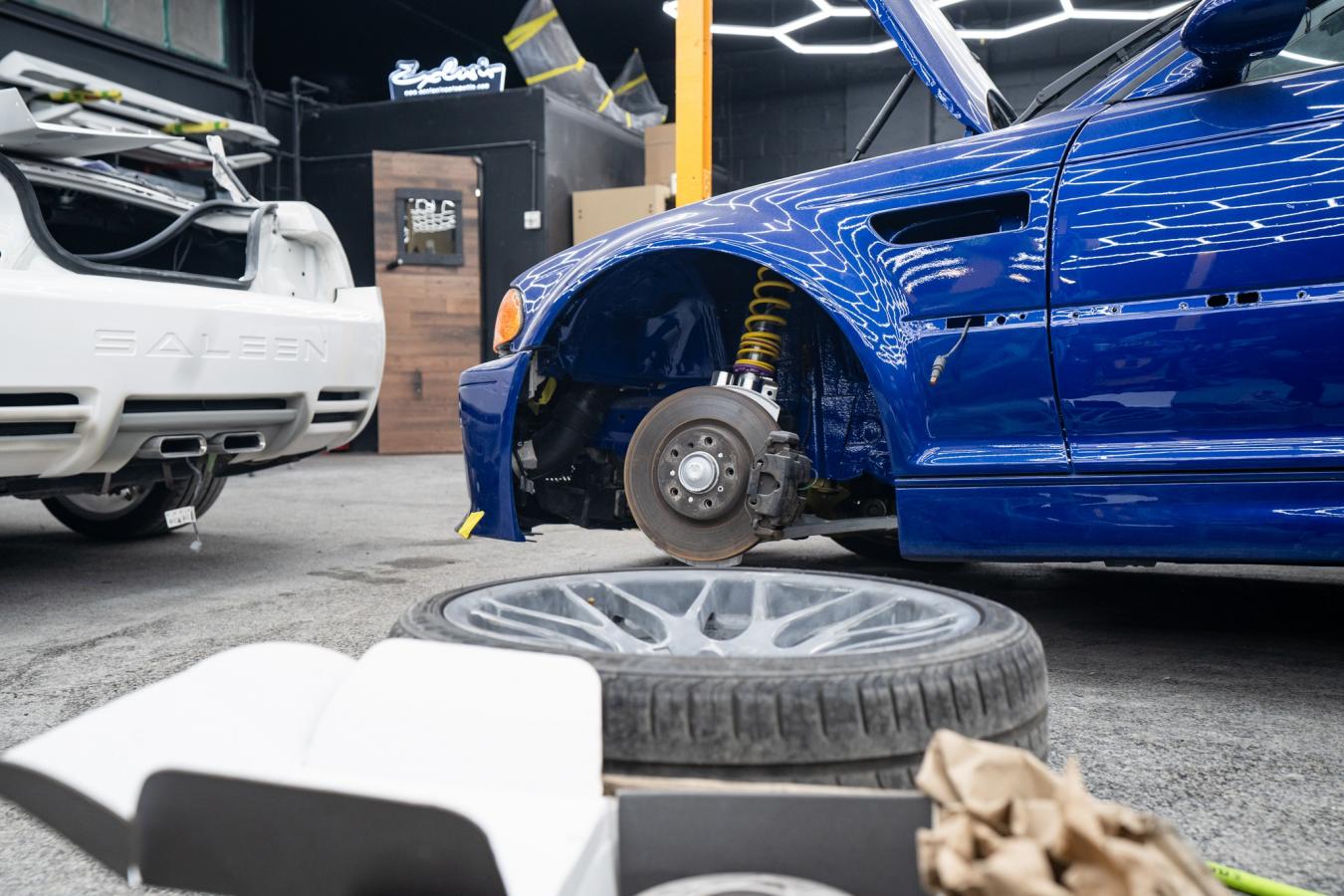

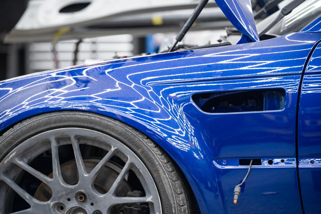

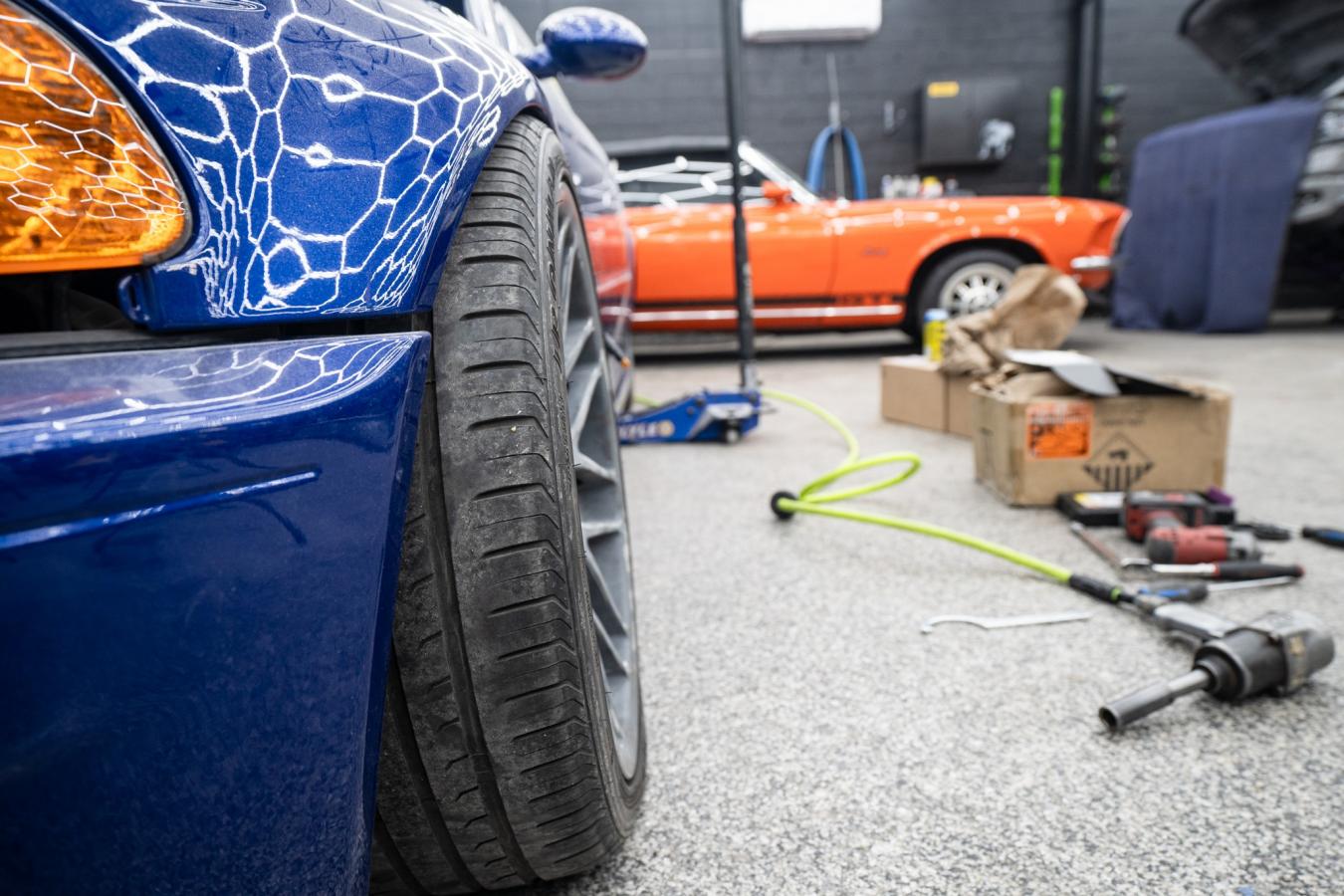

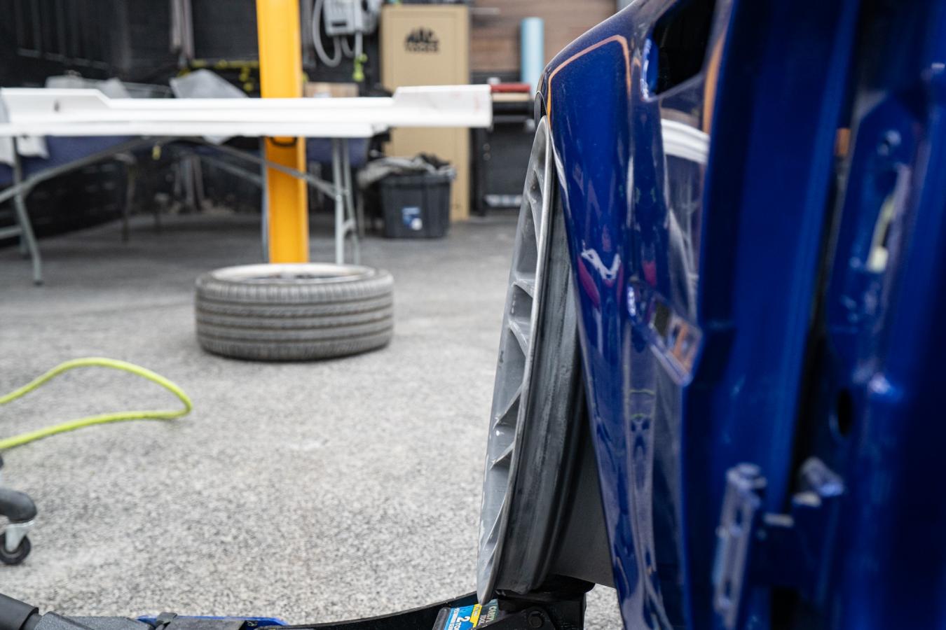

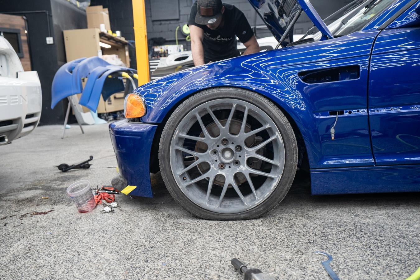

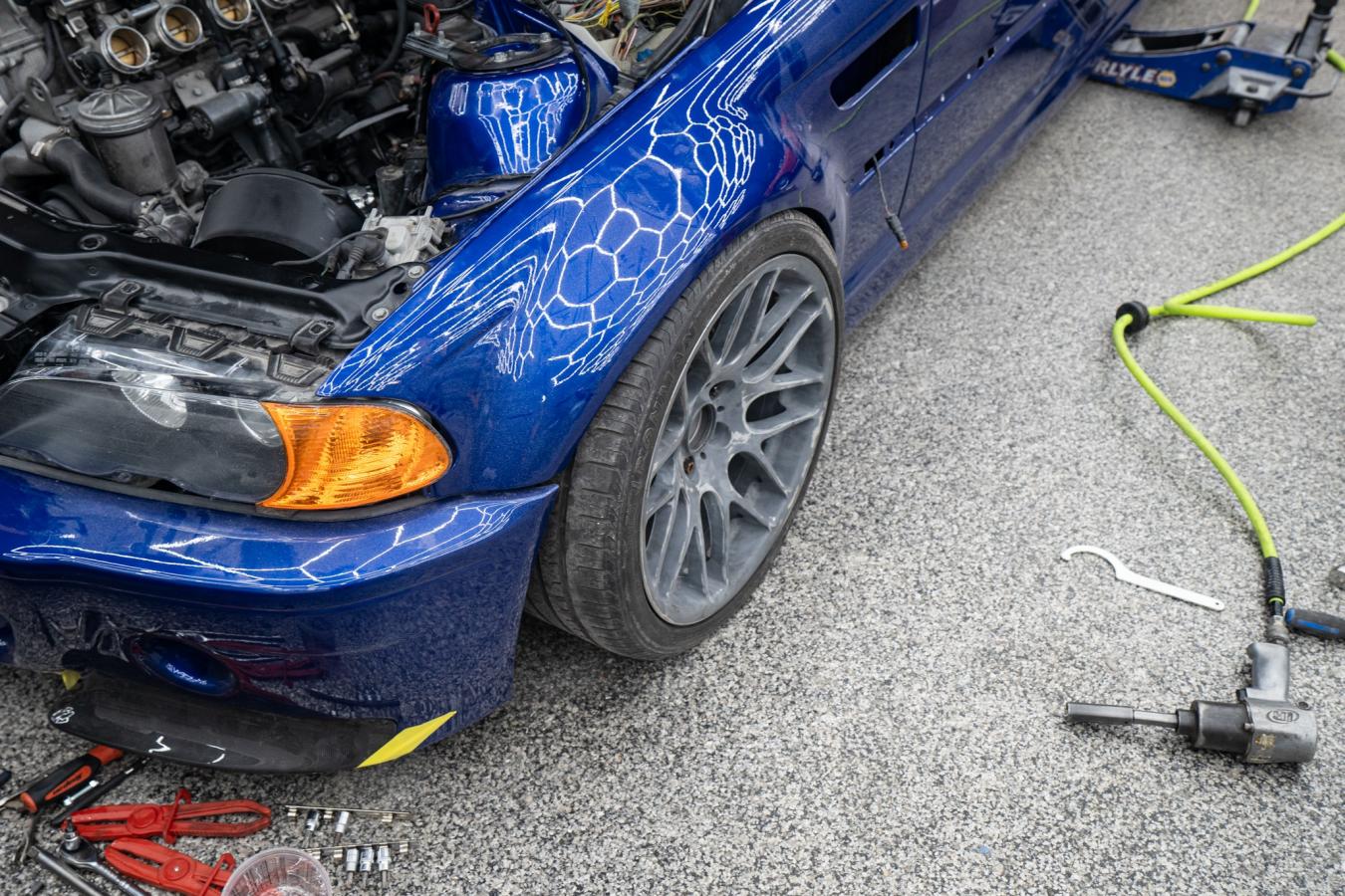

                    Success - urgh not really.

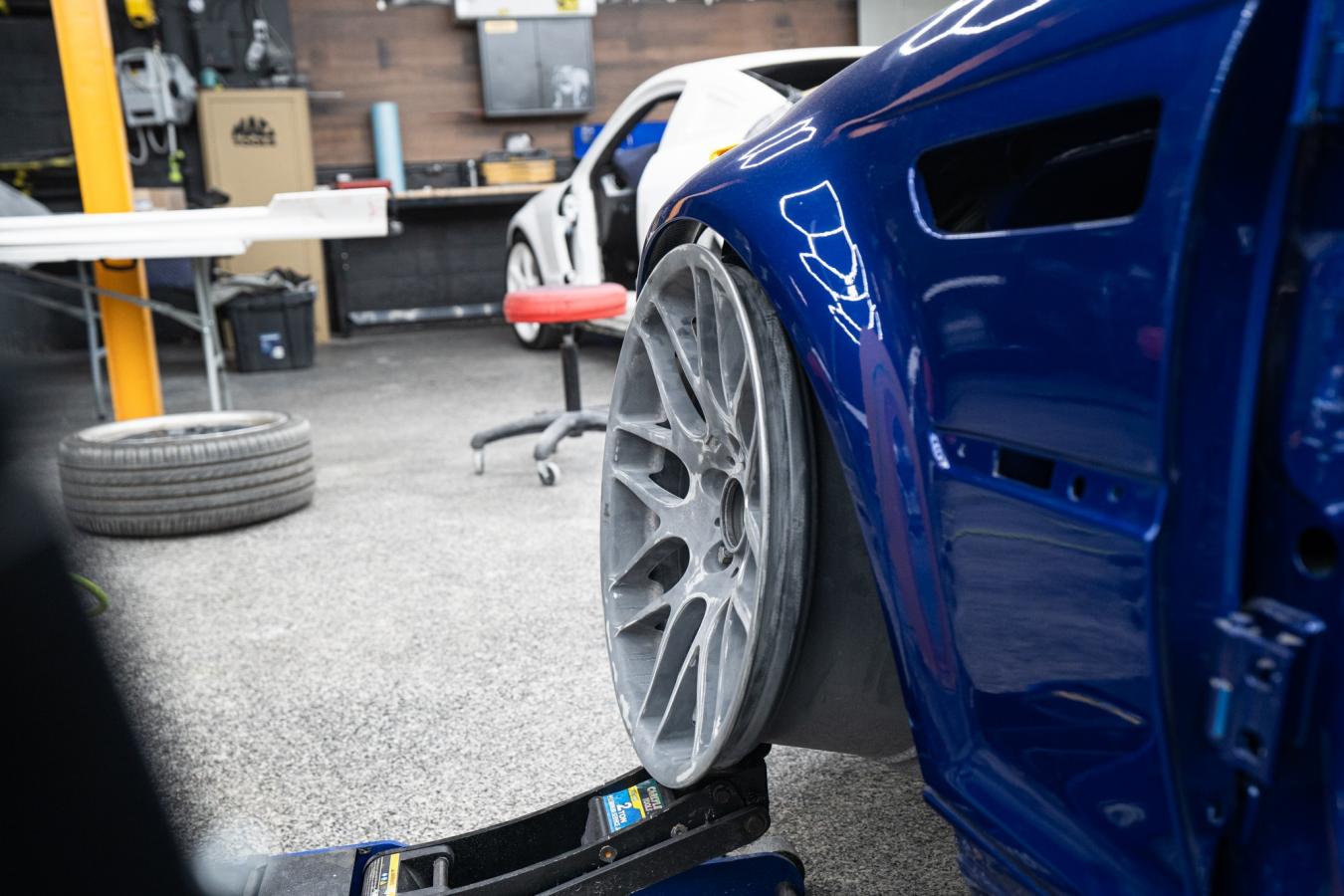

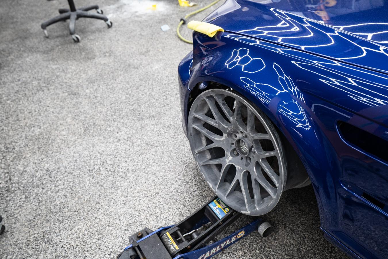

                    Swapped the tires to the CS/ZCP only to find the beads were damaged off the Chinese tires. Still, I test fitted the +30mm spacers - we aren't quite there yet.

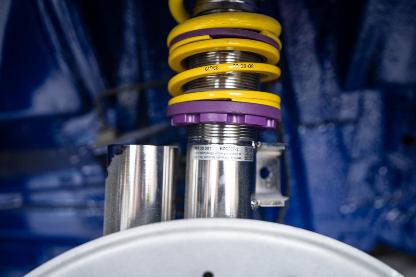

                    I tested these specs with 2x ride heights.
                    • 19x9.5J ET -7 (yes, minus).
                    • 255/35
                    • approx -3.0
                    • I slightly raised the KW CS by 5mm.
                    The tire is too thick, not enough camber, too low still.​ I will revisit this once the forged 163M style are here.

                      Bruh you need 50mm of positive offset.
                      The deflated tire was a nice touch *chef's kiss*.
