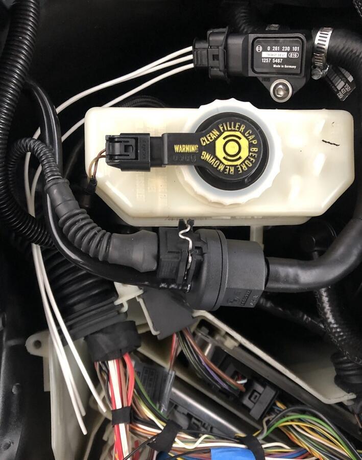

                  Test results:
                  Test 1:
                  Moving wire so it wasn't close to injectors keeping MAP sensor mounted on Kassel adapter.
                  Click image for larger version Name:	20200503_141842.jpg Views:	3 Size:	175.5 KB ID:	20438 Testo:
                  Click image for larger version Name:	20200503_142213.jpg Views:	3 Size:	120.5 KB ID:	20439
                  Test 2:
                  Moving MAP to a different location, I mounted it here because the previous owner had already cut into the Brake Servo hose.
                  Click image for larger version Name:	20200503_150023.jpg Views:	3 Size:	173.3 KB ID:	20440
                  Testo:
                  Click image for larger version Name:	20200503_150327.jpg Views:	3 Size:	103.9 KB ID:	20441
                  I think that says it all!
                  Now this forms another question in my mind, is there any problems created by running the MAP in the "Kassel Location" with those oscillations?
                  The last test case is to collect data from the OE / FSTT MAPS sensor location built into the air rail.
                  Do we have any reason to believe the air pressure is that turbulent and the readings are accurate?

                          I've had the kassel setup for about 2yrs but after seeing this thread, I'm planning to relocate mine to the brake booster area but am looking for the cleanest way to do this. I like Lang's option the best, but would probably need an additional adapter to connect to the oem map sensor. By doing what Cubieman did above, using the Kassel adapter and joining it to the vacuum tube would be the simplest, has anyone tested the effects of mounting locations? I read somewhere that the sensor needs to be mounted with the nipple pointed downwards for pressures to remain accurate.

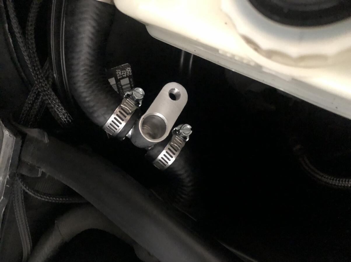

                            Lang adapter:
                            https://store.langracing.com/s54-map...fi-conversion/
                            CubieMan:
                            That picture is of a different style adapter than the Kassel and was only in that location for testing purposes as the previous owner had already cut the brake servo line there.
                            I later installed the MAP right by the brake servo, that is the cleanest installation as the cabin air filter covers it almost entirely.

                              Where are you guys getting those nice little adapters? I'm only finding them through UK vendors.
                              There's also these larger sizes. I don't have a booster hose handy but I'm guessing the 12mm *should* work.
                              https://www.lpgshop.co.uk/bosch-map-...-14mm-to-14mm/
                              https://www.lpgshop.co.uk/bosch-map-...-16mm-to-16mm/
