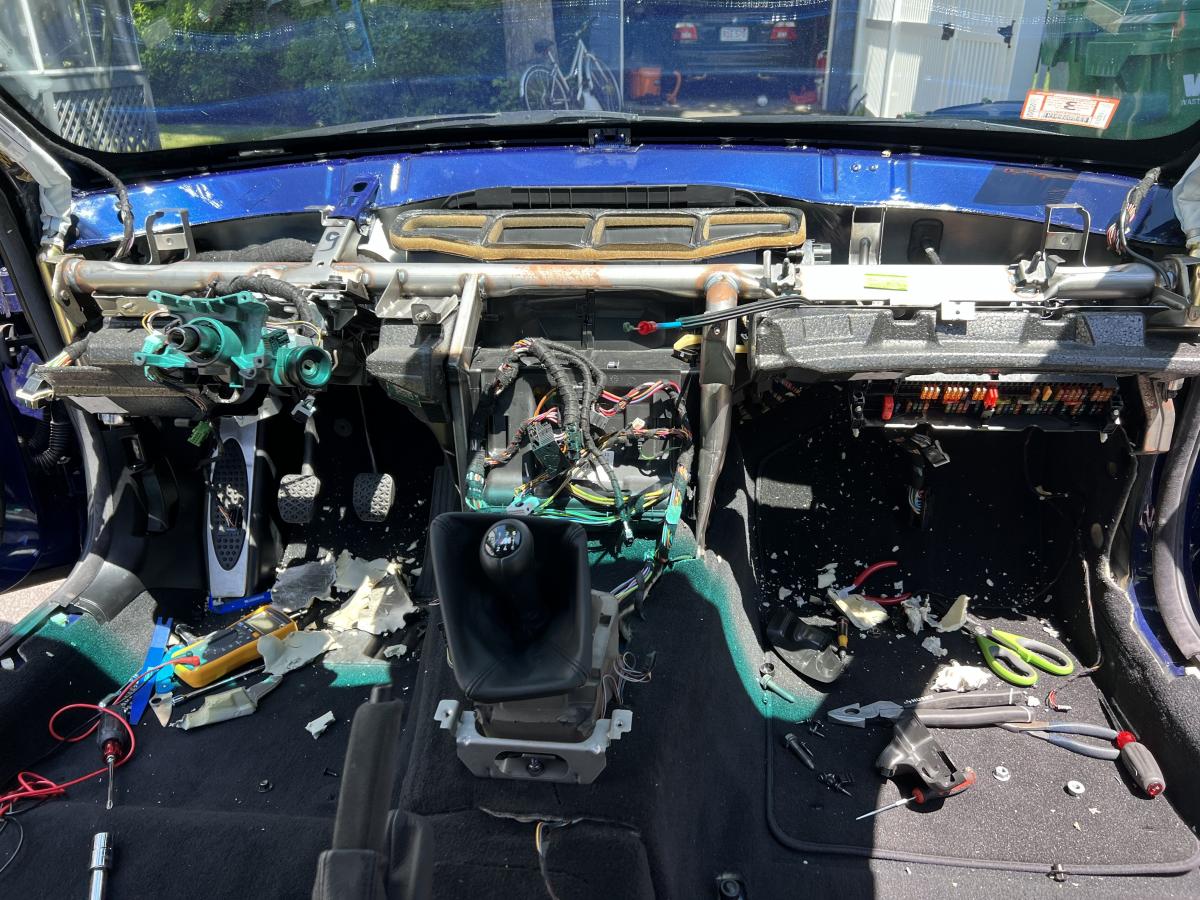

                  Okay boys, that shit is out as much as I possibly can get. I had the dash and center console reinstalled and everything and tore it all back out. It is doable to remove this stuff but it is a horrible job and makes a huge fucking mess. Also causes some seriously bloody hands. I would not recommend it without removing more than I removed in this pic.
                      Click image for larger version  Name:	7046D449-A97C-4C66-B29E-9D99DE804B5D.jpg Views:	25 Size:	210.8 KB ID:	172840
                      Nice! Please report back on the sound difference. My intake is pretty loud, but why wouldn't I want more induction noise?
                      Oh also, did you happen to weigh what you removed? Looks like a fairly big piece.
                        The weight on on that insulation is around five pounds.
                        I wouldn't be surprised if that was the predominant reason for the sound level disparity.

                          I’ll see if I can pull it out of the trash and weigh it all .. might be too scattered around in my bin lol. It’s pretty shredded and in probably 25 pieces.
                          It’s substantial stuff and a very large piece. Goes all the way from the windshield to just underneath the front carpet. I couldn’t get a small piece of it under the front carpet where the transmission tunnel meets the firewall. Five pounds seems like a pretty good estimate to me. Will report back on the sound difference when I can .. car is probably a week or two from being back on the road. Dash and center console is already back in but I’m waiting on the stupid non-sunroof coat hook bracket that I forgot about before reinstalling my headliner and seats 😡
