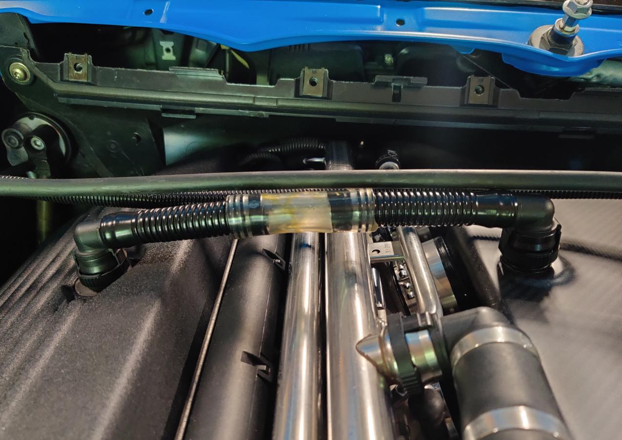

                Does anyone know the ID dimension of the make shift vacuum line/fuel hose that can be used in place of the BMW CSL hose?
                I have this part on order again after the first one showed up damaged, but it's looking like a mid to late June arrival and I need a workable solution before then. I'm worried this temporary nylon tubing I used just to get the car running will not hold up and I need to drive the car...
                I want to say that 0.75" ID will work. The outside measurement of the corrugated section is 0.71" (18mm), but it balloons a bit larger at the plastic fittings (the 90° ones).
                Edit: I could most certainly cut mine apart and measure the fitting, but don't want to do so in case I can't source the right size tubing. This "works" for now, but I'm not sure for how long it will.

                  #53
                  I have 5/8 tubing connected directly to the end fittings (so no corrugated section).
                    #54
                    Exactly what I'm looking to do and what I needed. Thank you!! 5/8" tubing on order!

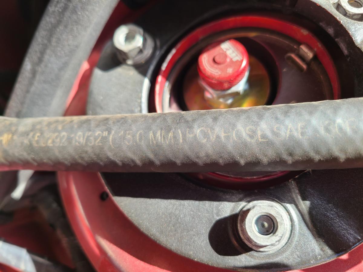

                      #55
                      I used 19/32" (15 mm) ID PCV hose

                        #56
                        You could buy a stock line and use a heat gun to stretch it out.
                        997.1 GT3 Carrara White/Black
                        C43 AMG Diamond Silver/Red​
                          #57
                          Interesting idea... Now I wish I hadn't hacked mine in the first place!!
                            #58
                            Cut off the plastic hose, keep the ends, find a hose that's the right size and use hose clamps.
                            Really easy.

                              #59
                              Cut off the plastic hose, keep the ends, find a hose that's the right size and use hose clamp.
                              Wait which part do you keep?
                                #60
                                The two connectors (NORMA brand) that are at each end of the tube.
