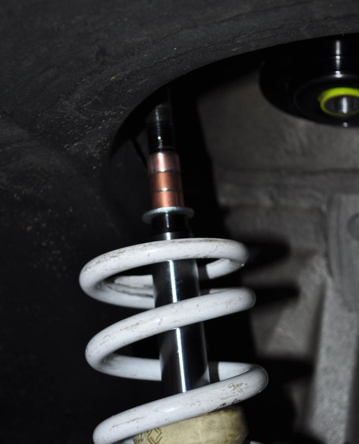

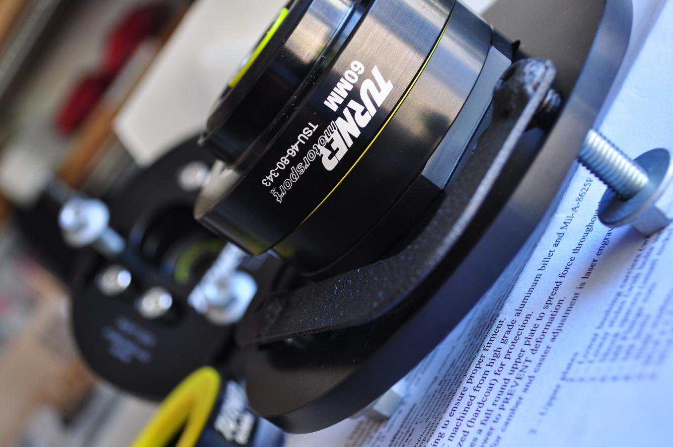

              Just to follow up from my previous posts ITT, I actually found 2 washers that were perfect to increase the surface area for the 14 to 16mm sleeves to sit on instead of just the MCS shaft square edge "shoulder". Thank you r4dr
