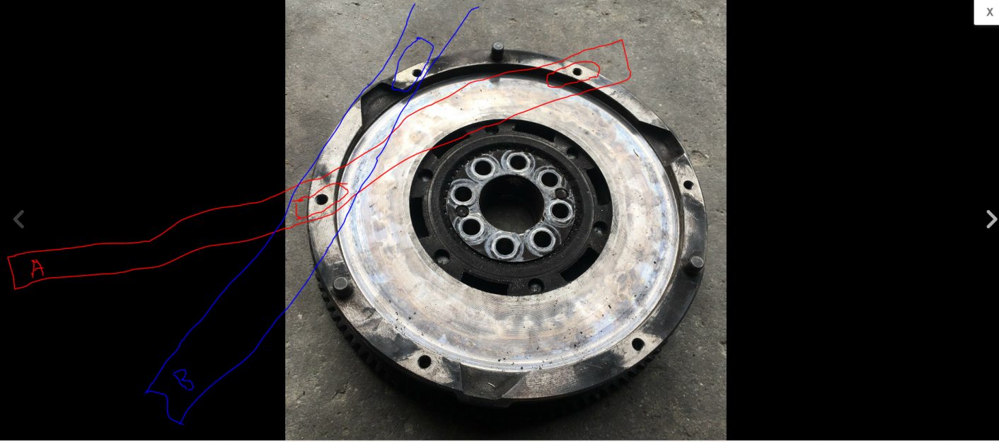

    Curious: engine off the car or on the car? I guess engine off the car, but in this case, it's easy to lock by bolting on a long Unistrut bar on the flywheel using 2 of the PP bolts.

          I would get the unistrut bar at home-depot to lock the FW.

            Forgive my ignorance, but how would I use the unistrut bar to lock the flyweel?
              Am wondering the same thing.
                I simply partly threaded one of the gearbox mounting bolts in a suitable position (one of the smaller lower 3), used it to hold a crowbar up against the starter ring teeth to hold the flywheel in place while I torqued the flywheel bolts to spec.

                  Easier if you have two people, but still doable alone.

                    The bar has long slots. The flywheel has threaded holes for the PP mounting, then use 2 bolts to hold the bar to the flywheel through the slotted holes any way you want, then anchor the bar long end on ground to lock the FW.
                      Use A or B, depends on the location of the slots:

                          A, B, or C (across the FW center). C and A are stronger than B.
