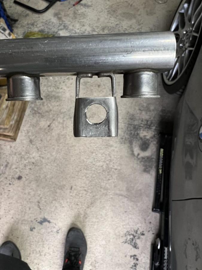

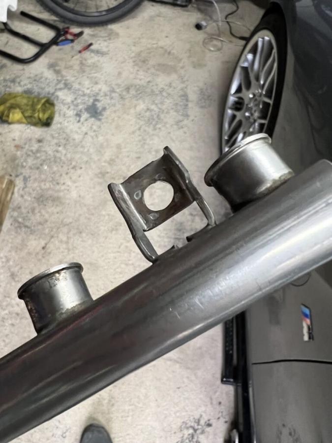

                            Remove the captive nut from the rail and enlarge the hole to give you a bit more wiggle room for the taller injectors.

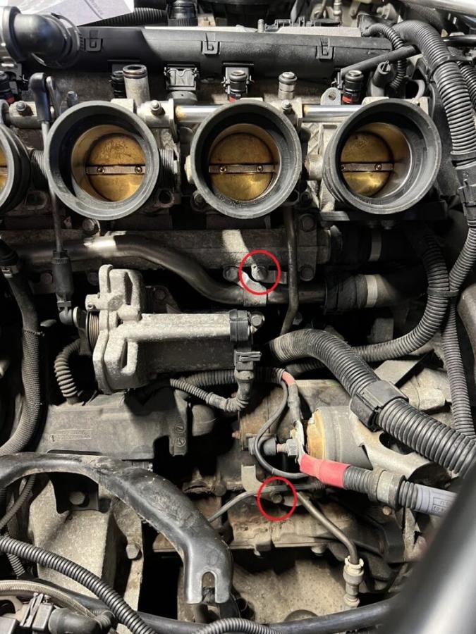

                            Then slacken off the 2 bolts highlighted and pull the fuel feed up and re-tighten the bolts. I added a small spacer behind the tab on the upper bolt to allow it to move upwards a little more.
