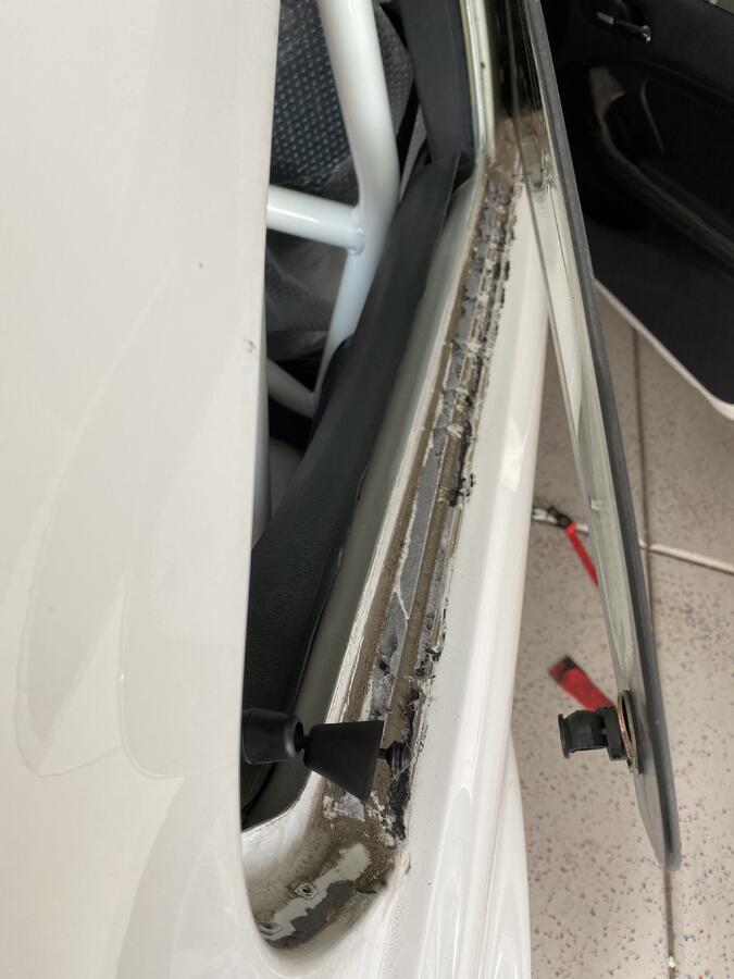

    Just tackled the rear side window finishers today. Took about 4 hours total. What a pain in the arse. I used a heat gun and lots of adhesive remover along with a plastic scraper. Next up is tackling the side finishers.

      To remove the adhesive left by the horizontal trim I tried bug&tar remover, alcohol, Goof Off, and finally Wax & Grease Remover. The wax & grease remover was by far the most effective, but it still took several applications and passes with a plastic scraper to get it off. I also used a heat gun and that helped soften it up.

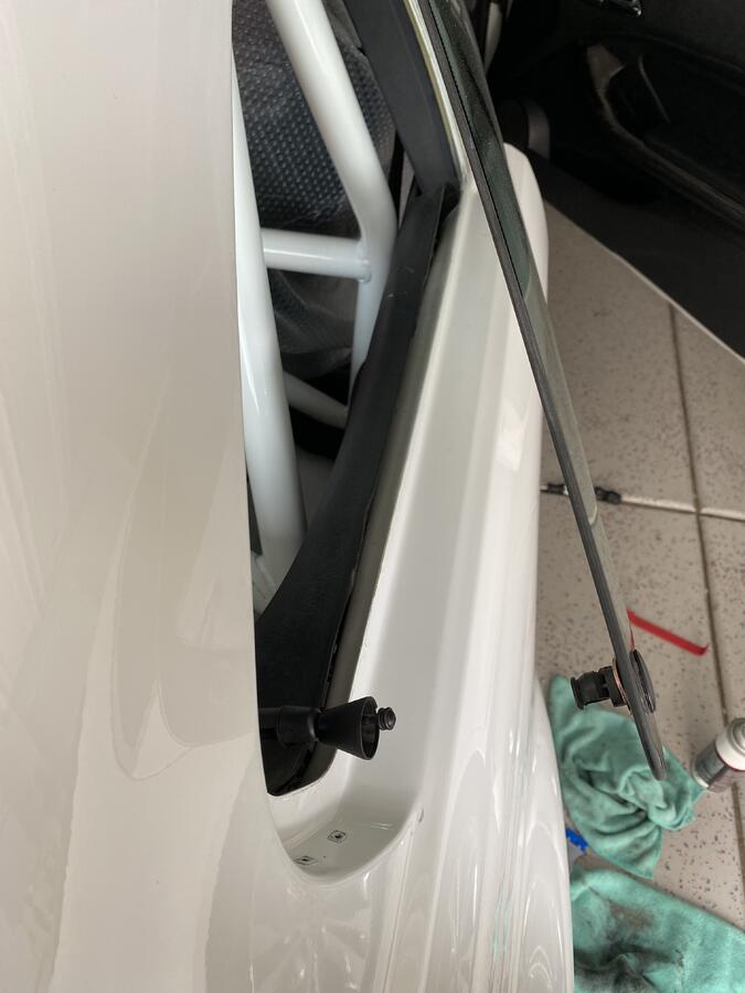

        Finished the side finisher pieces today. I am usually one to just go for the go fast goodies but going a different route with this car. I love how bmw has made it like legos and that you can rebuild the whole dang thing. The adhesive tape on these wasn't as bad to take off as the rear side window trim. I used a heat gun again and peeled off with my thumbs.
          Regarding the adhesive for the side trim: this came up in the previous version of this DIY on m3f.net. Someone in there suggested 3M General Purpose Adhesive Remover and some plastic razor blades. The key is to begin scraping while the old adhesive is still wet with the remover. Within a couple seconds of soaking, it comes right up. Make sure you clean the area after you're finished in the case any remover may still remain on your paint.
            Big thanks to this thread as well as the video references mentioned. Just tackled this last week, plastic razor blades definitely make the job so much easier. I used Adam's TAR to remove the adhesive which worked like a charm: https://adamspolishes.com/products/adams-tar

                                Did the fix on the rear window...
                                Extra advice:
                                -put foam pipe insulation on the gutter strip after removal, so you don’t scratch it, it whips around all over the place as youre working on it
                                -use a heat gun to remove old adhesive tape, much faster
                                -figure out beforehand what pipe (~10mm) to put into the new tubing to stop it kinking and test this off line (needs to be soft and flexible)
                                -my rear window fixings broke upon disassembly, had to put in a temp fixing
