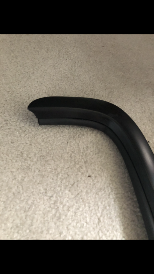

                  #38
                  I used the 3M stripping. Passenger side came out perfect. I am still working on the drivers side to get out a little kink, that is right at the curve. This picture is of the good side.
                    #39
                    Also wondering if the 3M or metro stuff is better. I'm hesitant to use a NOS rubber product if it's already going to be several years old when I install it... what's the point?
                    FWIW The Metro stuff is $10.95 on RockAuto, about $19 shipped.
                      #40
                      I lucked out and had come clear vinyl tubing at home that fits inside the 3M and hopefully will prevent it from kinking. Yes the 3M stuff is new old stock, but seems it feels/looks like new, at least the one I got.. That works for me as long as it lasts 16 years like the factory pieces.
                        #41
                        So I eneded up having to do the driver's side twice, that wasn't fun. I put vinyl tubing in the 3M to avoid the kinking, but found out after everything was all back together that the 3M did not stick out far enough basically everywhere to create a seal. The window closed inside of the 3M, not on it.
                        So I pulled everything back off and using a liberal amount of lube I managed to shove clear vinyl tubing through the entire length of the 3M. This bulged it out enough to create a great seal as well as looking better.
                        Unfortunately that means I had to order another 3M kit as you only have enough to do both sides of the car and not mess up like I did. So I guess if anyone else needs one side done I might have some extra assuming I don't mess the passengers side up!
                        Also, I got quite cavalier about my handing of the long metal strip that the 3M sits in and managed to create a few scratches, that was dumb. Take your time, I did at first and came to a point where I knew it was time to stop but just kept going.
                          #42
                          So as it turns out having the vinyl tubing more or less run the entire length of the 3M was a mistake, it made it bulge out too much were the window won't close as far as the side I haven't messed with. The tubing should really only be used around the bend, ehhh.
                          Also I can hear the window motor working a lot harder to close the the window, so the driver's side has to come off for a third time! Too bad cause it looks so nice!
                          I think if I just run vinyl tubing to approx. the space where my photo ends on the left hand side that would create perfect "bulge" and not interfere with the window closing properly. I gotta have the perfect bulge ya know.
