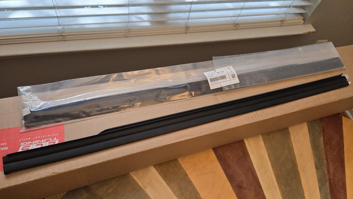

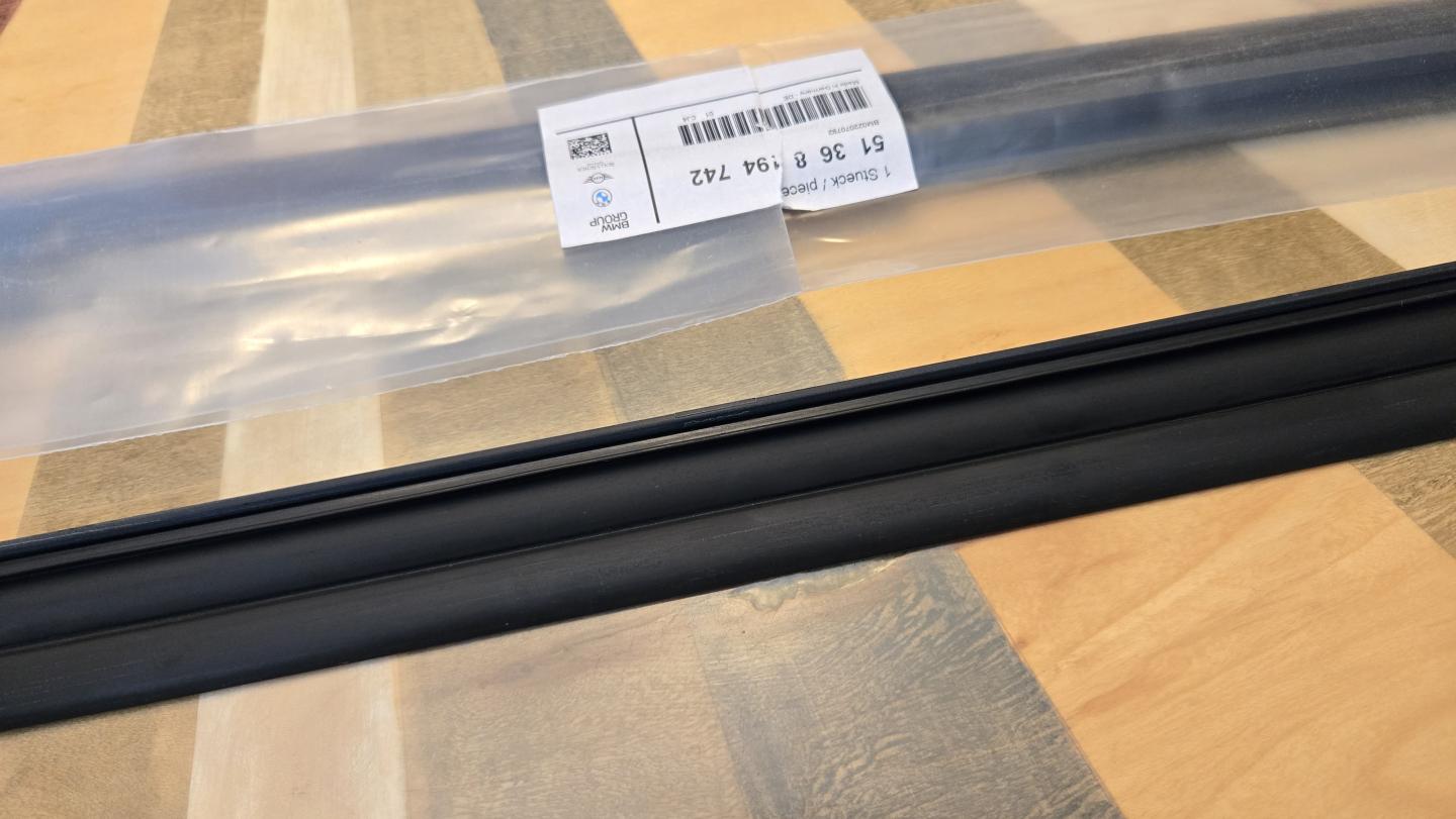

                          Either I'm being dense or these are wrong. Can someone confirm? I couldn't find any other pics of these or issues with them.
                          Ordered these last year and prepping for install now. The tops of both of these weatherstrips have double sided tape on them. It's not just a protection film, it's double sided tape. From top to bottom on the pic: bottom of passenger side with 2 strips of tape (correct), top of driver side with one strip of tape (is this a QC error?), top of OEM driver side.
                          Click image for larger version  Name:	1000056784.jpg Views:	0 Size:	144.8 KB ID:	318716
                            I have the Genuine parts new in box (wrapper) and they don't have the tape on the outer surface.
                              Subscribed!
                                I sent Matt an email. Tbd...
