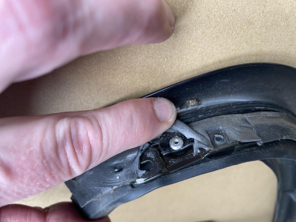

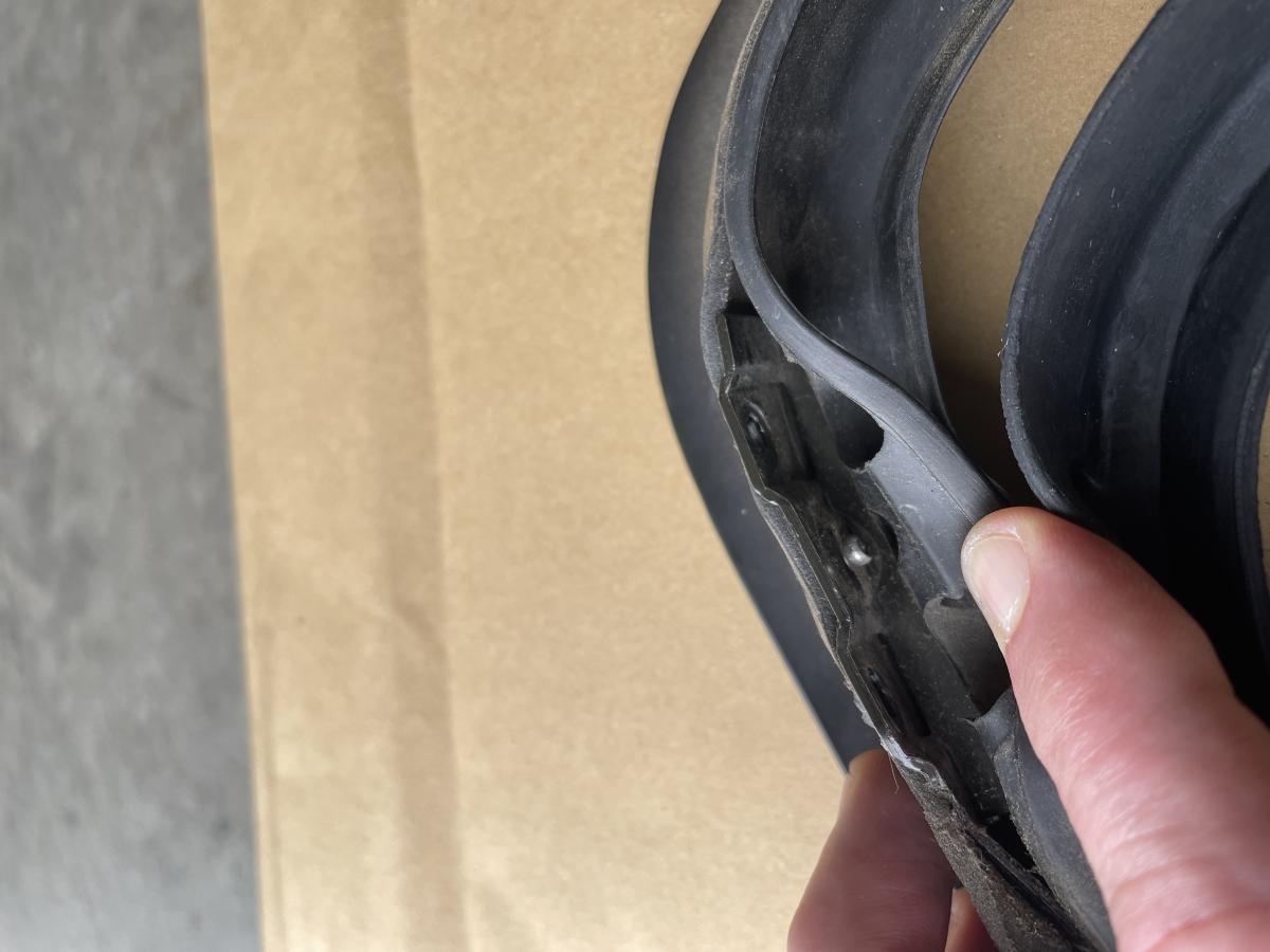

    The rivet fastens a bracket to the aluminum finisher to allow the finisher to attach to the body and probably provide some degree of seal position control. The way the bracket fits is such that there is an interference with the rubber seal making it tough to position into place with a new seal. I’m still wondering if there wasn’t a better design—like integrate the bracket shape and mounting points into the aluminum trim and make some shape change on the rubber seal if necessary . Here are some photos of the area…

                    Well you just drill out the rivet. I bought a Quinn rivet gun and rivet pack from harbor freight--1/8" Aluminum rivet back in, no problem. The issue is, seating the bracket. That bracket allows the finisher to attach to the body. Anyway, it's not THAT bad, it's just finicky. Make sure you line up your new seal to the tick mark in the trim finisher and stretch it to fit; hotter is better. And put a new foam seal over the riveted area to keep your paint from getting scraped by the bracket upon reassembly.
                      NO NEED TO REMOVE RIVET AND THE BRACKET ! JUST PULL OLD RUBBER OUT, SPRAY WD-40 AND SLIDE NEW STRIP IN.
                          I'll try that method when I do the other side. The side I did do, there was no way the new rubber was going in there as far as I could see; but, I'll give your method a try.
