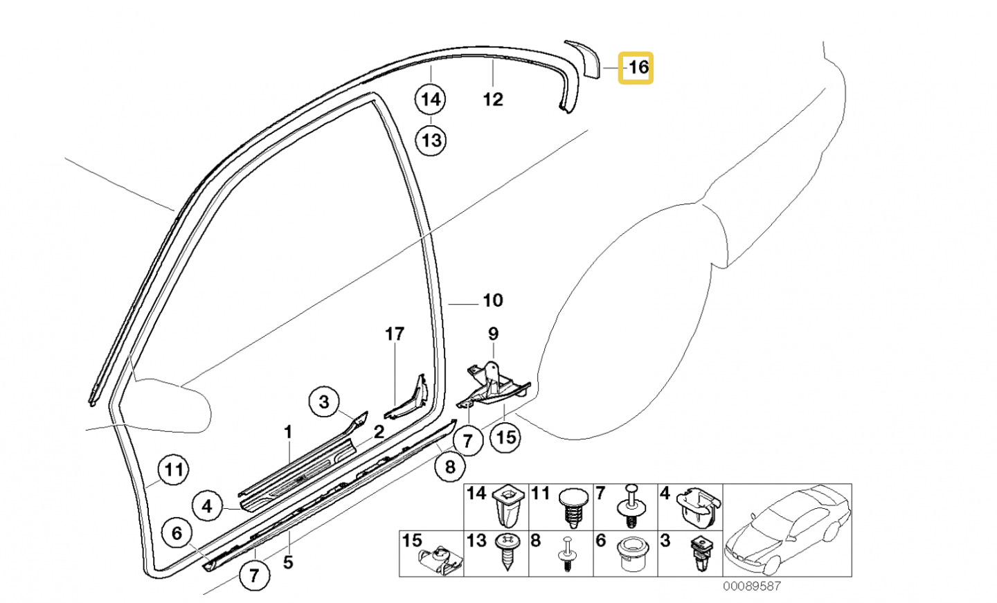

                      It's optional. Goes between the metal trim and the body of the car. It should be fine to reuse. I'm replacing it because mine's a bit torn and bc of my OCD.
                      Edit: number 16 in realoem diagram shows you location.
                      Edit 2: optional as in if your original foam gasket material is okay to reuse then you can reuse it.
                        Thanks man, appreciate it
