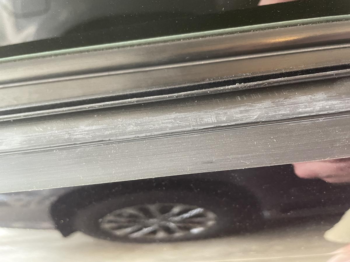

      Originally posted by Keith_MN View Post
      Either I'm being dense or these are wrong. Can someone confirm? I couldn't find any other pics of these or issues with them.
      Ordered these last year and prepping for install now. The tops of both of these weatherstrips have double sided tape on them. It's not just a protection film, it's double sided tape. From top to bottom on the pic: bottom of passenger side with 2 strips of tape (correct), top of driver side with one strip of tape (is this a QC error?), top of OEM driver side.
      Click image for larger version Name:	1000056784.jpg Views:	0 Size:	144.8 KB ID:	318716
      I made the same mistake. The ones Matt sells are only for cars that have the extra chrome gloss black trim pieces unfortunately. Was able to sell my set locally but I'm stuck w/o a driver-side bottom rear trim now😓
      EDIT: jsut realized he's now finally selling the matte finish sets. hopefully he'll correct the mistake if that's what you ordered
        Yep that's what I did, just made a dumb mistake when ordering and didn't understand what i received.
          For anyone who needs to replace both sides, Matt Navis' shop finally has the matte/shadow bottom piece available: https://matthewnavis.com/product/all...r-matte-black/
          I guess for people like me who ended up getting the pass/right side, its better to ahve the 1 spare than cracked/missing strip

                              I ordered the seals from Matthew Navis and only did one side.
                              The seal feels thicker (and hopefully more robust).
                              I just feel that the motor struggles a bit when closing the window now.
                              It will hopefully settle...
                              UPDATE:
                              I heated the new seal with a hairdryer and applied some Swissvax "Seal Feed" and it helped the window opening/closing.

                                Originally posted by Alx007 View Post
                                Thank you all for your advice on this thread.
                                It has been very helpful.
                                UPDATE:
                                I had this same experience/observation. Nice note on heating the seal/Swissvax, I'll try that when/if I do the other side.
