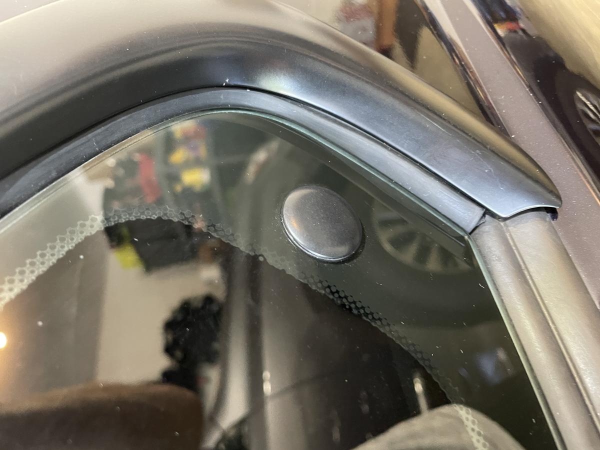

                          Finished product...definitely a difference from the original, the fit is a little different--maybe because it's new? But overall, a great go at this price. I fought the aluminum trim gap to the body at the kink, and just ultimately gave up. I'm not sure if it was like that originally, or there is some magic method to positioning this thing, but, it's one and looks better than the rot that was there.
