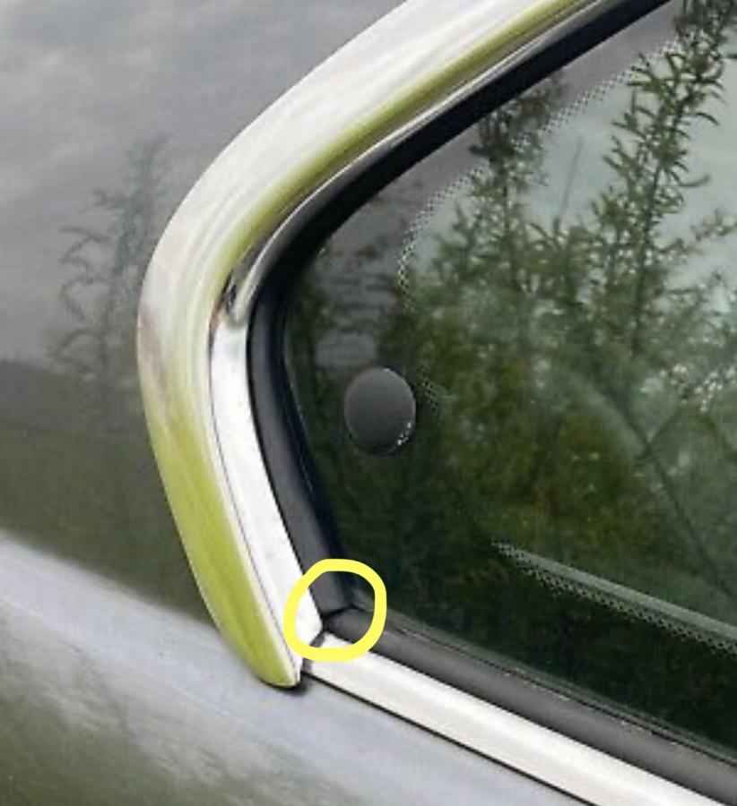

                        Hi, found this replacement on eBay.
                          #87
                          Good find. I don't need it since I already did mine but would love to hear feedback from anyone you buys this.
                            #88
                            I've got to do this, thanks for bumping this thread!
                              #89
                              Probably better off DIYing the seal cutting step and saving $160. Not worth it at $200 IMO.
