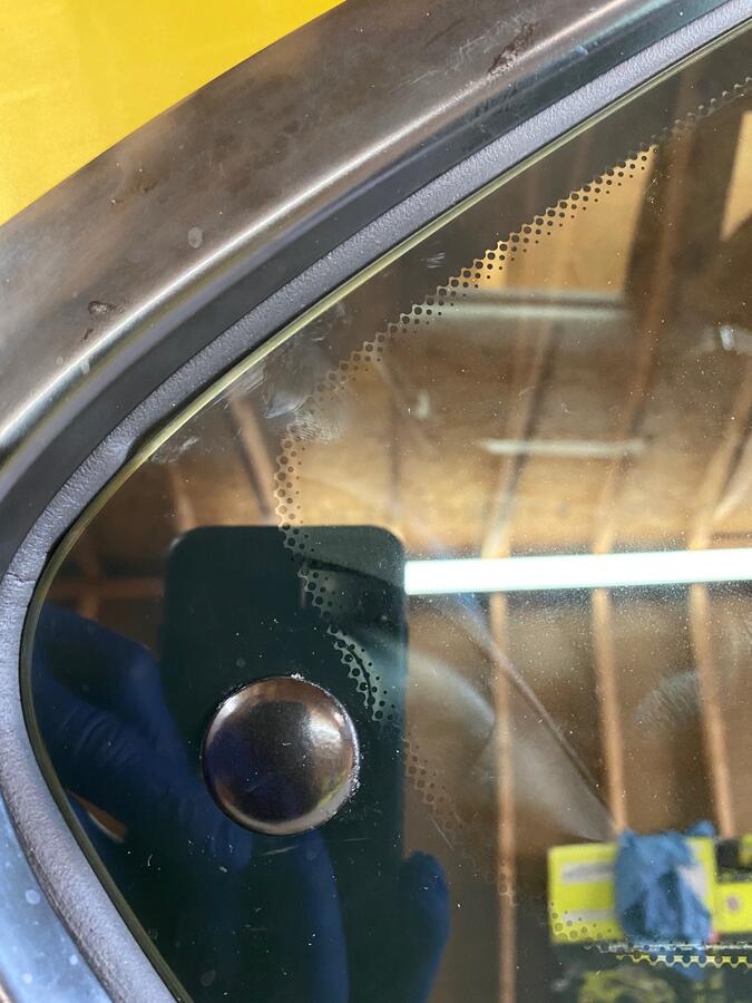

    the 7/16" tubing worked great. i did the passenger side but the glass doesnt seal against the new weatherstripping. I even loosened the glass bolts and moved it around and just can't seem to get a 100% water tight seal. anyone else have this issue? in this pic you can see the buldge created in the weatherstripping by the inner 7/16 tube... maybe i should have pushed it in further?
        Click image for larger version Name:	IMG_1465.jpg Views:	0 Size:	75.4 KB ID:	52059
        I had this same issue and had to push the tubing in further. Check out my post (#42) on page 3 in regards to this.

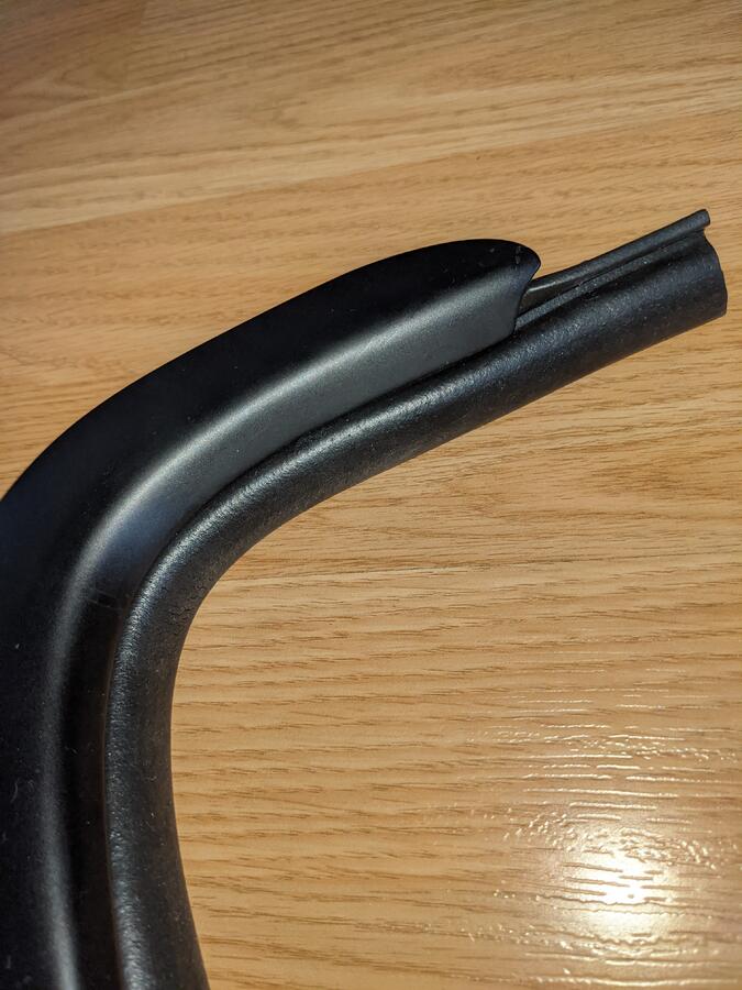

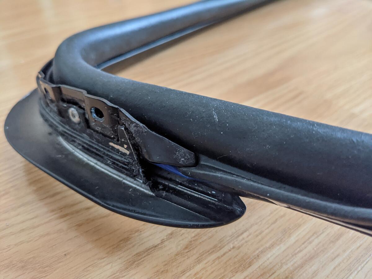

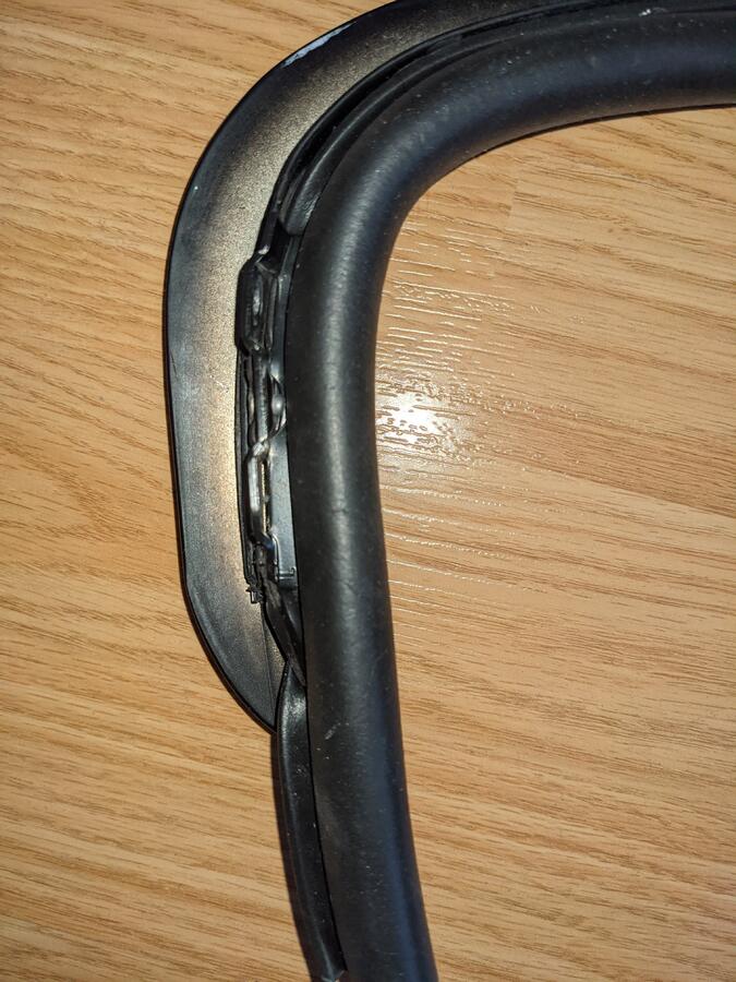

                        I'm in the middle of replacing the weatherstripping - can someone take a look at these pictures and tell me if I've done it right? I'm waiting on the quarter window horizontal trim, so I haven't attempted reinstalling the side finishers yet. My weatherstripping didn't kink and I didn't use any plastic tubing. I've been reading comments about getting a perfect "bulge" with the tubing, so at this point I'm wondering if this will fit or seal right since I didn't use any. I did trim the spine around the screw holes everywhere except the last two screw holes where the rail is. Does this sound right?
                          #72
                          that looks really good. no kinking at all. which tubing did u purchase?
                          2007 Imola Red Z4M Coupe
                            #73
                            This is the AmeriSeal multi-purpose bulb seal. I did heat it up for a few minutes with a blowdryer beforehand. It seems to fit really awkward around the rail at the end, but I don't know if I can get it to sit any flusher without damaging the rubber.
