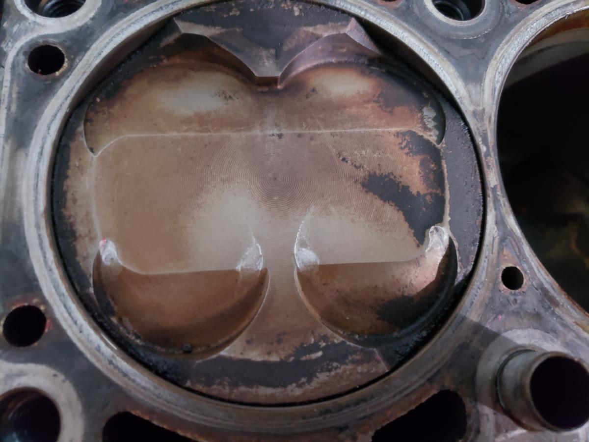

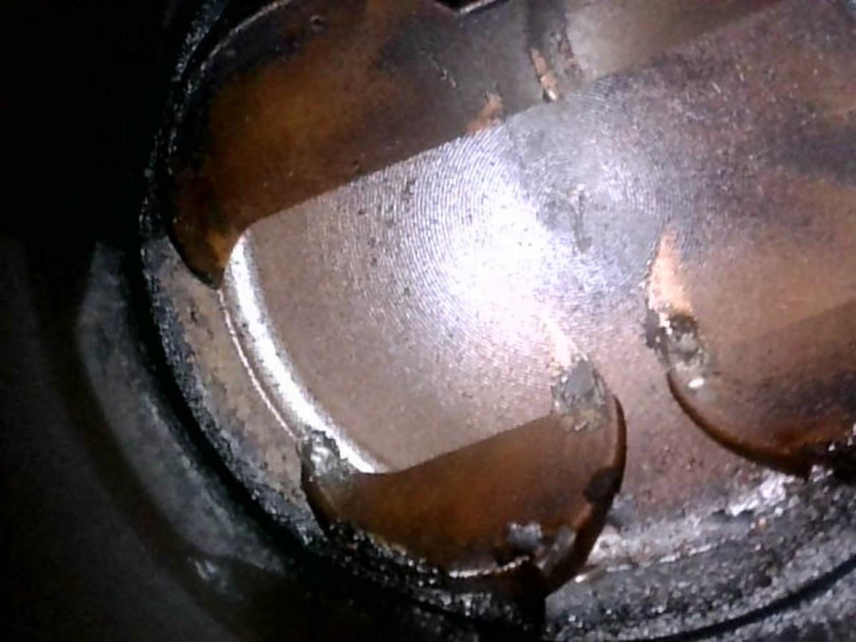

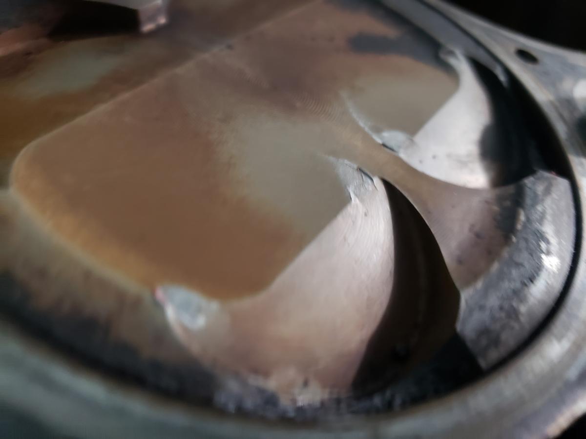

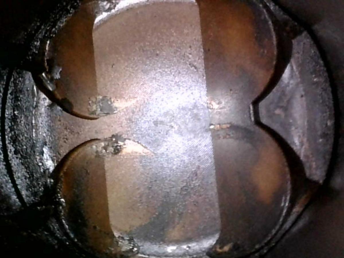

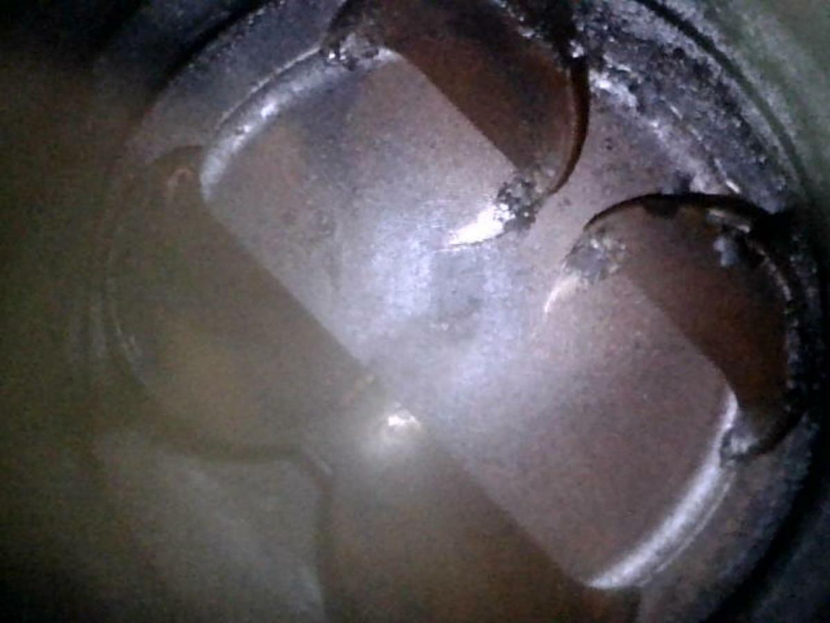

    So I have two bent exhaust valves and they hit the top of the piston (cyl 6). This happened when going through timing/cam install (engine out of car). Pics are below but want to ask...
    1.) Will the valve indents effect compression? Currently I'm at 190 all 6 cylinders before this incident.
    2.) Will removing/reinstalling the head effect compression?

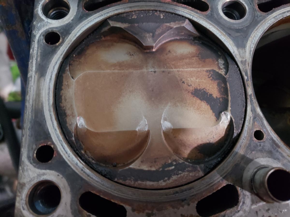

    Additional pics before head uninstall
      Won’t affect compression, I’d smooth out marks to minimise hot spots.
      None of them are direct above ring groove and might have pinched a ring ?
            Will do, thanks for the input.
            Any suggestions on how?

                    The marks I'm fine with... I'm just worried that the perfect compression in now ruined (with piston marks and new valves).

                        do a leakdown test to see if there's any leaks on the valve seats. If leak down test is good, then consider yourself lucky.
