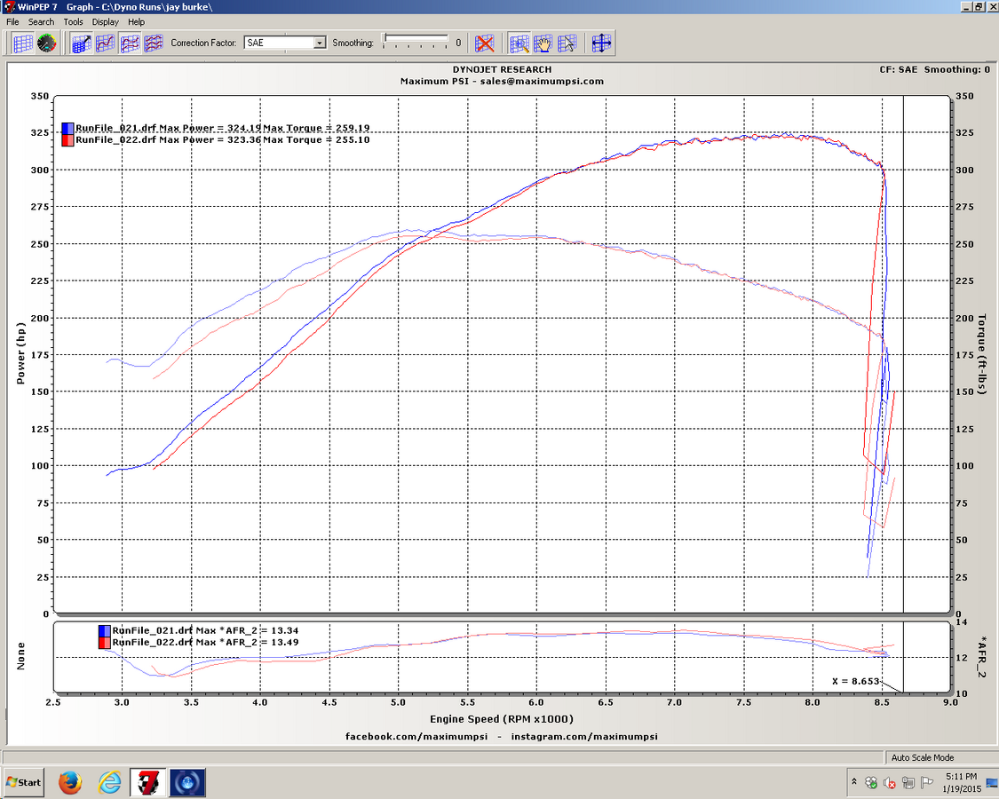

      Alpha N, BW Elbow, Intake, Ebay Headers, 3" Single Exhaust, 87k on the motor
        ^^^ Thanx for posting and providing mod details...and nice max power results for the relatively simple mods. However, low end torque figures look typical for an S54 w/single exhaust. How many miles on the car?

            87k
            Cool, thanx!

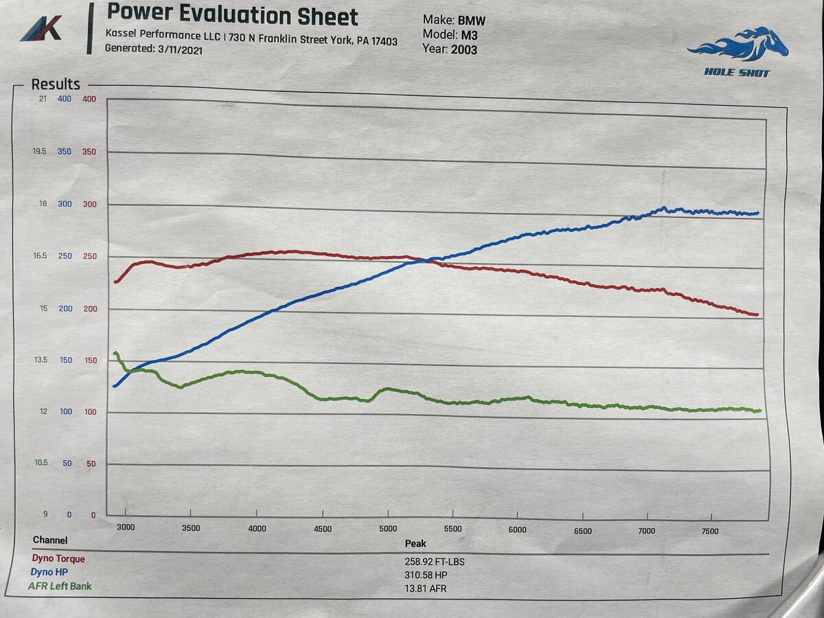

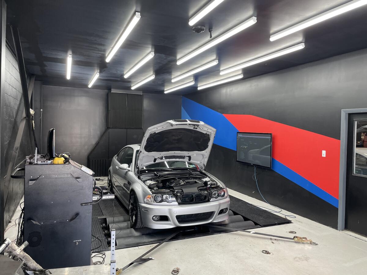

              Full Supersprint (Stepped headers, race cats, sport Muffler)
              Kassel MAP conversion, CSL Conversion
              Turner CSL air box
              Kassel dyno tune (mustang dyno)
                Thonas Congrats bro, really nice numbers. Excited to see your torque figures as I'll be going SS stepped and oversize dual throughout. Im at 325/250 whp/wtw on dynojet now (turner csl map, oe euro header, scza) , a little more oomph in the midrange never hurt anyone.

                      Congrats, nice gains, and thanx for posting!

                              So what should I do next for more NA HP? Is the next step cams?
                                Yep. Though, I think that the current setup is solid as is. The funds might be better spent on a few DEs or track days.
