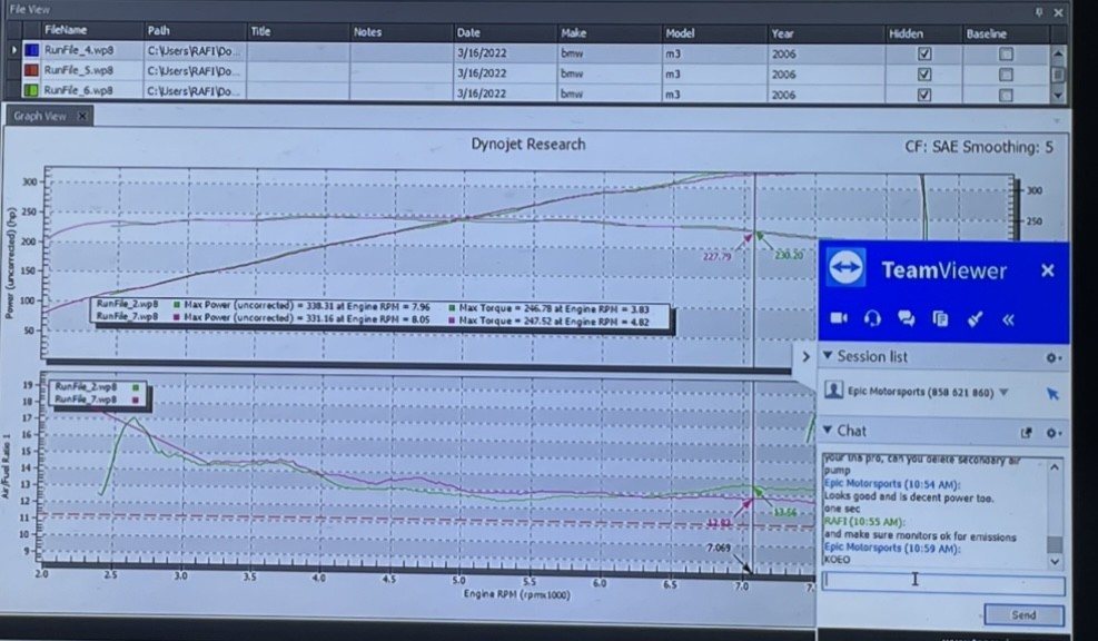

                              Evolve CSL airbox and full SS exhaust with cats, made ~331whp/ 247 torque…not bad. Did a run at ~338whp but decided to dial it down a bit for safety. This was on dynojet with AlphaN tune from Epic.
                                Stock cams?
