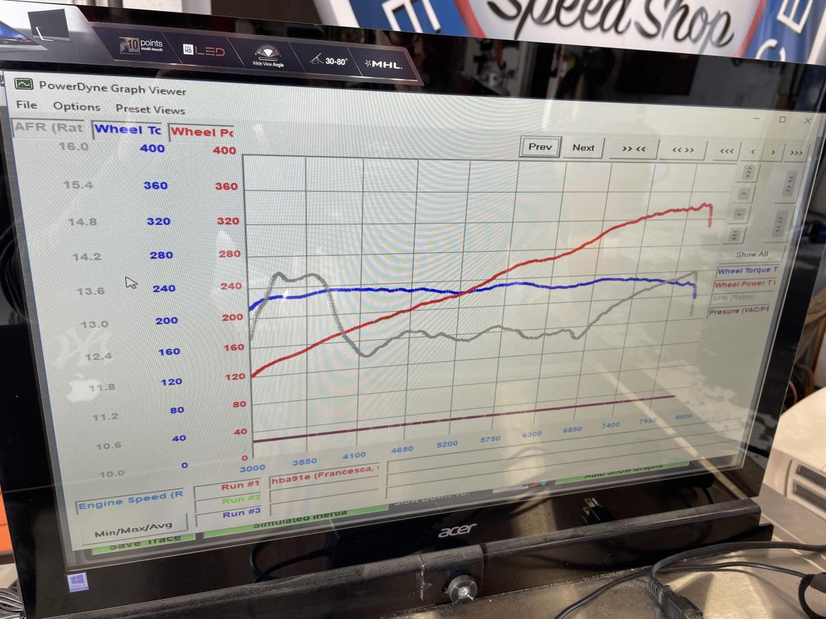

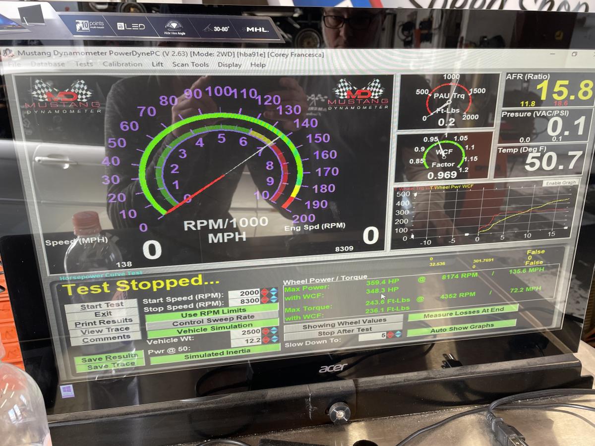

    359whp on a mustang dyno and the stock injectors are completely maxed out because the head is too efficient lol. I will be going back for another round once I figure out what injectors to run.
    Also before anyone complains, the load is at 2500lbs because the car was running lean on the initial pulls. After the final pull we raised it to 3500 to simulate real world conditions and got within 2hp.

      I'm not the ultimate dyno guru or anything, but I believe that the WCF number is the generally accepted one to go by...someone please correct me if I'm wrong? The WCF number is the weather correction factor figure, and I KNOW that you can't directly compare dyno numbers, but I believe that the WCF number would more closely equate to the Dynojet SAE correction STD J1349. Who knows though how that Mustang dyno was even scaled in the first place...you can't directly compare numbers from a Mustang to a Dynojet...unless the operator calibrates his dyno to 'approximate' Dynojet figures. Again, just trying to educate and learn here folks!πŸ˜‰πŸ˜Ž Glad to see the car healthy again btw, and thanx for posting up the graphs man!

        Yeah you can’t compare dynos directly at all. It’s solely a datapoint but I’m still very happy especially given my injectors were a limiting factor.
        I think you hit it dead on with the comparison or lack there of statement. WCF is indeed weather correction factor. I know for sure a dynojet will read higher, I believe 5-8%? In that case I’d still be in the mid 360whp range which is fairly impressive for a 125k mile stock bottom end if you ask me! Bottom end has impressive leak down but it’s still orignal. I’m happy either way.

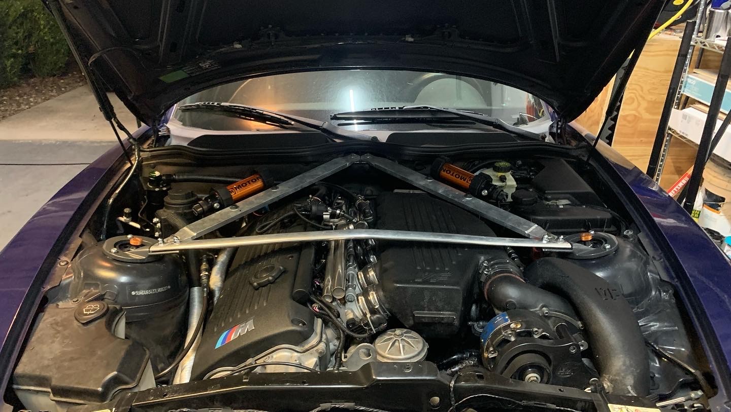

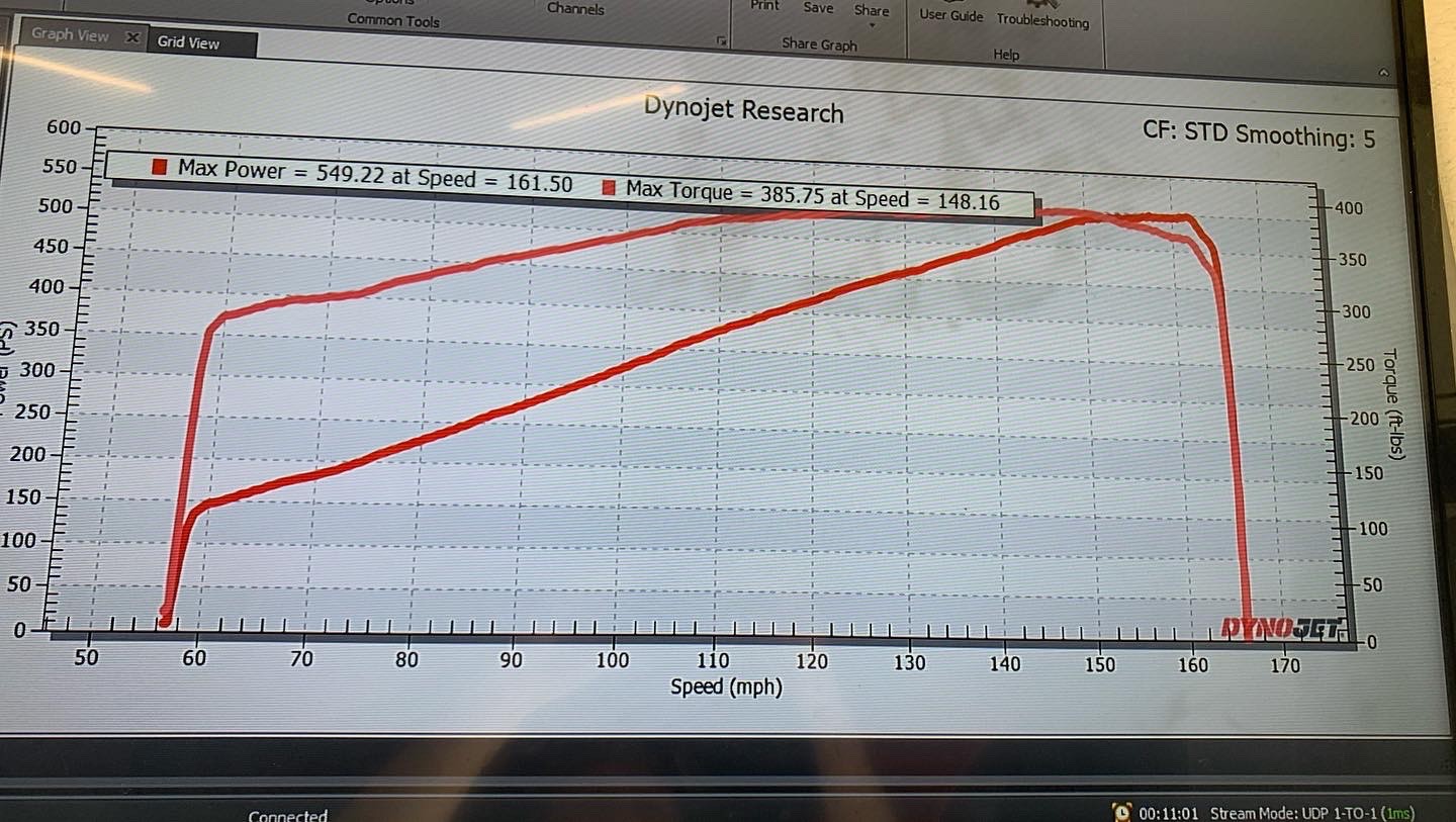

                    Finally got the supercharged Z4mc back on the dyno after 5 years of work on the Frankenstein supercharger kit.
                    Thanks to the mss70 master Severn tuning really happy with the car as we now approach tune iteration 85.
                    12psi, e85, high rpm contoured Si trim impeller, stock pullies, id1050Xs, walbro 450, gigantic AtW heat exchanger
                    Car weighs in at 3125 full fluids (no driver), and is running low 8 60-130s and trapping mid 120s. Excited to get it back on track this fall for some sub 2:20s at Sebring.
                    video on my ig: _SB__Garage_
                    car made 308/280 when na with euro headers and a TTFS tune way back in the day.

                      Yes actually. Runs were initially done at 2500lb load and the final run was raised to 3500lbs to make sure the tune was still safe on the road. Difference in power between the load changes was only 2hp which is pretty damn good when you factor in some heat soak.

                          Nice numbers, congrats, and thanx for contributing to the thread!

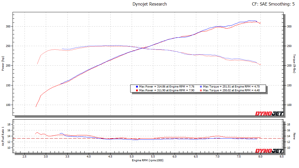

                              I know I said I was done chasing power (and I am!), but I have all this incremental dyno data and recently got lighter wheels (~6 lbs per corner), so I couldn't help myself. Was back at the dyno this morning to see what effect they had on the whp.
                              Updated setup:
                              • 130000 mi
                              • US spec pre-facelift M3
                              • Karbonius full carbon intake with carbon snorkel
                              • Kassel MAP
                              • Stock CSL IAT location and sensor
                              • HP converted MSS54
                              • SSV1s and SS oversized section 1 with HJS cats
                              • Stock section 2 and 3
                              • All engine maintenance done
                                • Rod bearings replaced ~17k mi ago
                                • VANOS done ~17k mi ago, passes VANOS test with no issues
                                • Engine retimed ~6k mi ago
                                • Valve adjustment done ~6k mi ago
                                • New front and rear TPSs ~2500 mi ago
                                • New precat O2 sensors ~1500 mi ago
                              • No mechanical fan, just aux
                              • Rogue engineering water pump and power steering pulleys
                              • Dynoed at Sonoma racetrack so altitude is ~sea level
                              • 52ΒΊF ambient temp
                              • 90% (!) humidity
                              • Running Shell V-Power 91 octane
                              Dyno graph comparing the run with 19" wheels (blue) vs today's run with 18" wheels (red):
                              Click image for larger version  Name:	19 vs 18.png Views:	0 Size:	37.3 KB ID:	156505
                              312 max WHP, 250 max WTQ
                              Yes, you're reading that right. The car made less power with the lighter wheels. Or maybe more accurately, the car made less power today than the last time I was at the dyno. Would not be surprised if the 90% humidity played a big role in it. I'll mess around with correction factors and all that to see what I can learn from these plots, but I think it's pretty clear that doing these sorts of comparisons in different conditions (even with the same dyno, same operator and same car setup) is not very meaningful.
                              One thing I don't love is the AFRs. Car is leaning out a lot at 7k rpm. The AFR curve looks pretty similar between the two runs, except that today's is shifter up. Maybe also related to humidity? Definitely not an equipment problem, as we swapped out the AFR probe's O2 sensor for a brand new one when we saw how lean it was measuring. I'll reach out to Paul to see what his thoughts are on this.

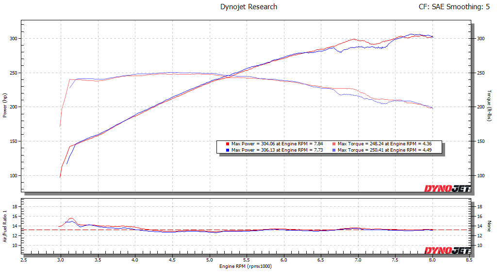

                                And just for fun, we ran a quick experiment. I had the operator do a run with the AC compressor off and then do another with it on immediately after.
                                Dyno graph comparing the run with AC off (red) vs the run with AC on (blue):
                                Click image for larger version  Name:	AC vs No AC.png Views:	0 Size:	39.1 KB ID:	156507
                                The runs were done at the very end of the session, so car was heat soaked by this point. Not an issue really, as I was just interested in the delta between the two.
                                And once again, yes you're reading that right, the car made more whp with the AC on.
                                Pretty interesting that you can see at which point the compressor becomes a real problem (~6.5k rpm). At around 7250 rpm, it seems like the DME disengages the clutch and the power jumps back up. I can't confirm that the clutch actually disengaged (since the airbox is so damn loud), but that's what it looks like from the plots.
                                So even though I didn't get the results I was expecting today, I did learn a couple things:
                                1. Comparing data from different days is basically meaningless. Even if most variables are controlled for (dyno, dyno operator, correction factors, car setup, etc.), the variance in conditions from one day to the next is enough to completely skew the numbers.
                                2. The numbers themselves are pretty much meaningless too. There are just way too many variables that are constantly changing for this sort of measurement to be precise and repeatable. Numbers are nice for ballpark figures, but the shape of the curve and AFRs seem to be much more meaningful.
