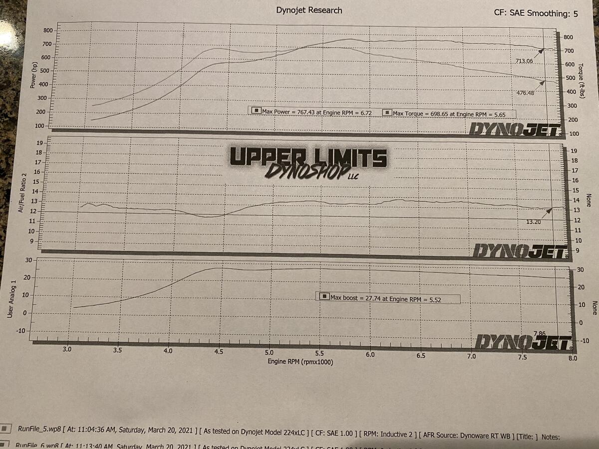

    373 KW is 500hp.
    Custom VF engineering kit (modified intake + water Meth).
    3.91 Diff
    Fully built Vac Motor with CP pistons and HPF Crower Rods
    ARP L19 studs and bolts.
    Cometic Headgasket
    Euro Stock Exhaust. No Cats

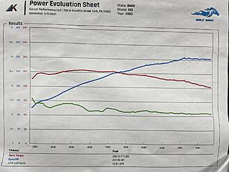

    Kassel thought it was plugs being a bit old. I replaced them but will not be able to get back to them for another run.
    How many miles on your plugs? Might want to perform a VANOS test as well.
    Leave a comment:
  • Thonas
    replied
    Originally posted by stash1 View Post
    Why is it nosing over at 7,000rpms? Have you performed a VANOS test recently?
    Leave a comment:
  • stash1
    replied
    Originally posted by Thonas View Post
    So what should I do next for more NA HP? Is the next step cams?
    Leave a comment:
  • Slideways
    replied
    Yep. Though, I think that the current setup is solid as is. The funds might be better spent on a few DEs or track days.
