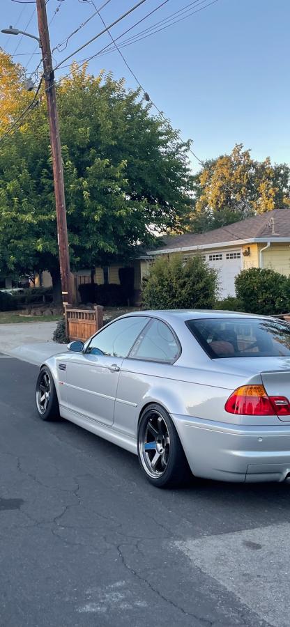

        I'll be honest... he recommends not going lower than 13" front and 12.5 rear or whatever it is that is common knowledge to be min height for proper travel and control arm angles, etc. I talked to him about this for 2hrs and he said what people don't realize is that below that min 13" height up front the suspension efficiency gets EXPONENTIALLY worse and he explained the dyno curve to back up that claim. Well when I threw the FCM setup on I think I was 12.5 front and I forget the rear because it was a quick and dirty setup and I really just got overly anxious to try the setup out. Also camber was eyeballed so ride height could only be so particular until an alignment. Well the car was already so much better than the MCS setup that I was really happy, but during our call I mentioned some things about the car getting into the bumpstop too early and he asked "what are your ride heights?" then explained the theory above about how crucial this variable truly is to car setup. Well I raised the car 1/4 of an inch all around and I shit you not it was drastic. The car is no longer hitting the bumpstop like it was and it just works beautifully AND I'm still technically too low lol. That is wild.
        The sig pic is on the old suspension and idk what it was honestly but the whole "set ride heights to look cool" is retarded. This is calculated science to be done right if you care about performance. I think I'm currently at 12 7/8 front and 12 3/8 rear and I actually am eventually planning to raise the car maybe 1-4-1/2" all around. I have no real issues as is no matter how hard I push the car, which is part of why I haven't done anything yet along with the fact that my 6" spring may coil bind up front if I go any taller. It does not right now. I do want to do some more experimenting later on with some spring rate changes, maybe even softer than 425/850 which would necessitate the raise in height, but every time I think about doing it I drive the car and it just works so well as is that I procrastinate touching it because I can't find anything to complain about that that is truly bothering me anymore like the old mcs suspension.
        This is current height on an aggressive TE37SL setup on track tires and the car functionally takes everything I throw at on very sprinted canyon runs and me chucking it into every corner I can get my hands on and it does not rub. I got the top of the tire to just barely rub the fender liner on a VERY aggressive dip at like 60mph on a backroad with a friend in the car and that is amazing. The MCS setup would have launched me off the road.
        Here are some pics of the current functional height. Idk I'm getting old and at times I think its a tad too low aesthetically but Shaikh did such a good job with this setup with how well it works that I've just been to lazy to touch it because it DOES work. Lol
