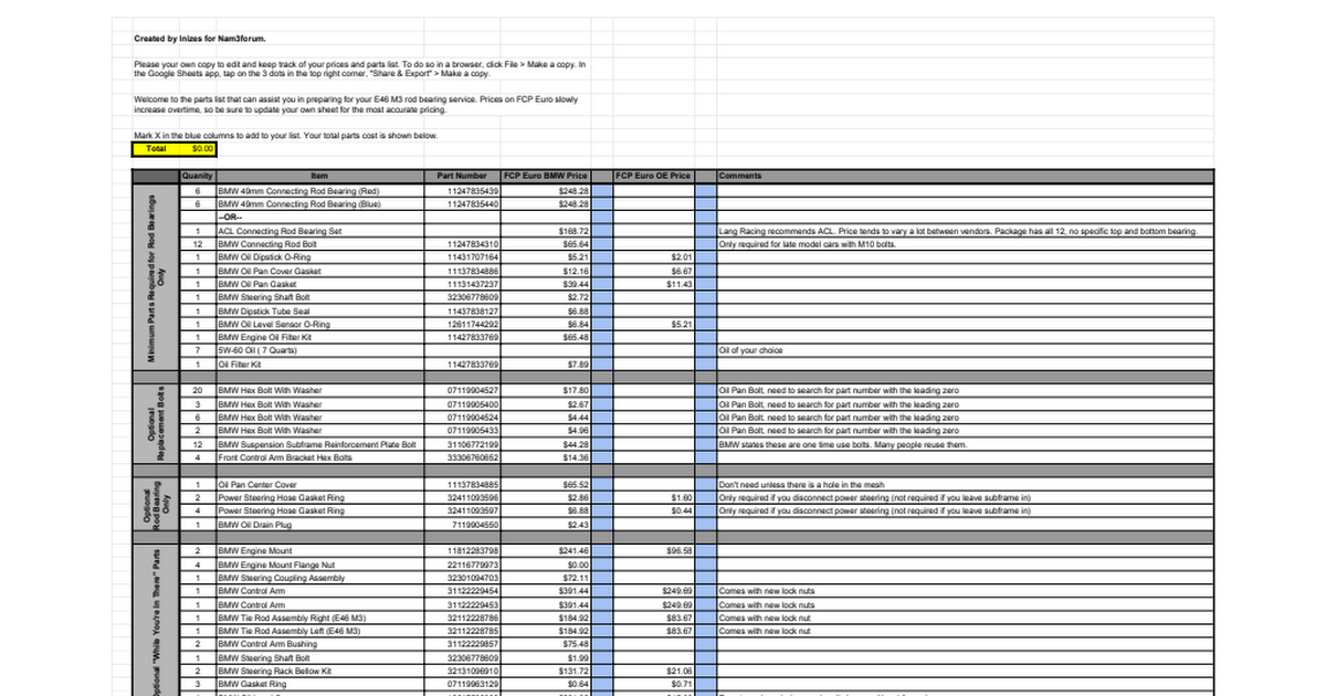

                    I put together a spreadsheet when I was figuring out what parts to order based on the DIY instructions. I thought this might be helpful to others so I changed the formatting a little so you can mix and match parts a little easier.

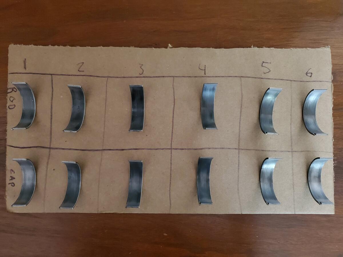

                      Finally made some progress on my bearing DIY. These are recall bearings from 2004 time frame with somewhere around 75k on them.
                        Those look almost exactly the same as what came out of my car. Mine were also replaced in 2004 under the service action and had about 78k mi when I replaced them.

                          I guess we could have both gone longer!
                            Here’s some original on a 2005 with the change completed at 107,010 miles. There was a tiny bit of copper on the edge of 1, 4 and 5 rod side.
