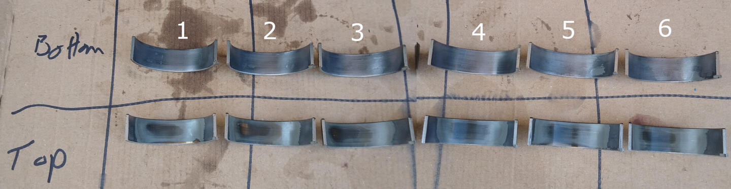

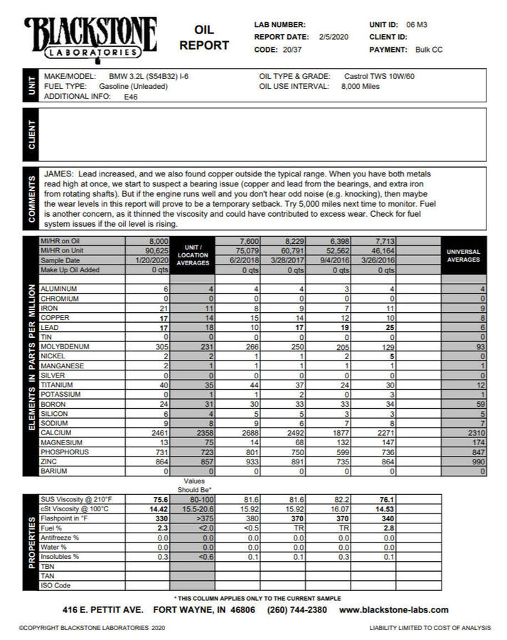

            Just did my rod bearing job at 92k miles. Car had 30k miles in 9 years (oil changes approx one a year) when I bought it, and I've done changes with TWS every ~7500 miles since, plus LiquiMoly MOS2. I've attached my latest Blackstone with the history, along with pictures of the rod bearings. You can see from my oil analysis history that my car has always run relatively high lead and copper numbers. I don't think this is from the 7500mi intervals, but the consistency until the most recent one has made me comfortable with the numbers. The recent spike is likely related to the 2 months that the car sat in a shop in Oct-Nov (another story), often getting at least 2 cold starts/day to move cars around and never letting the engine warm up. It got just a few hundred miles after that before I did that oil change. Interesting that the fuel % spiked since I brought the engine up to temperature driving around before doing the oil change, but oh well. I decided with work-from-home downtime to go ahead and do the rod bearings (and other things) for peace of mind.
            The bottom bearings appear good, with just a slight hint of copper starting to show.
            The top bearings 1 & 2 show the most wear to copper. Check out the striking copper sheen on the edge of bearing 1.
            What do you think? Full-size picture attachments are included as well for the curious that want to see some close-ups.
            Click image for larger version  Name:	bearings.jpg Views:	0 Size:	78.6 KB ID:	44107 Click image for larger version  Name:	blackstone.jpg Views:	0 Size:	135.6 KB ID:	44108
              #81
              Originally posted by JamesSJ1 View Post
              The bottom bearings appear excellent I think, with just a slight hint of copper starting to show.
              That looks like some decent wear. The bottom doesn't look excellent and the top looks close to the end of its life. It's good you changed them. What's weird is most bearings seem to opposite of yours where the bottom is worn and the top looks better. I'm not sure what that's about
                #82
                I just looked at a couple other pictures. I put mine on the board flipped compared to those. Most people put the top bearings on the "top" of their picture, whereas mine are the bottoms. Does that explain it?
                  #83
                  You really need to reread your post before posting. The first half of what you said does not match the second half. If the top is "close to the end of its life," then how does the "top look better" as you stated in the second half of your post?
                    #84

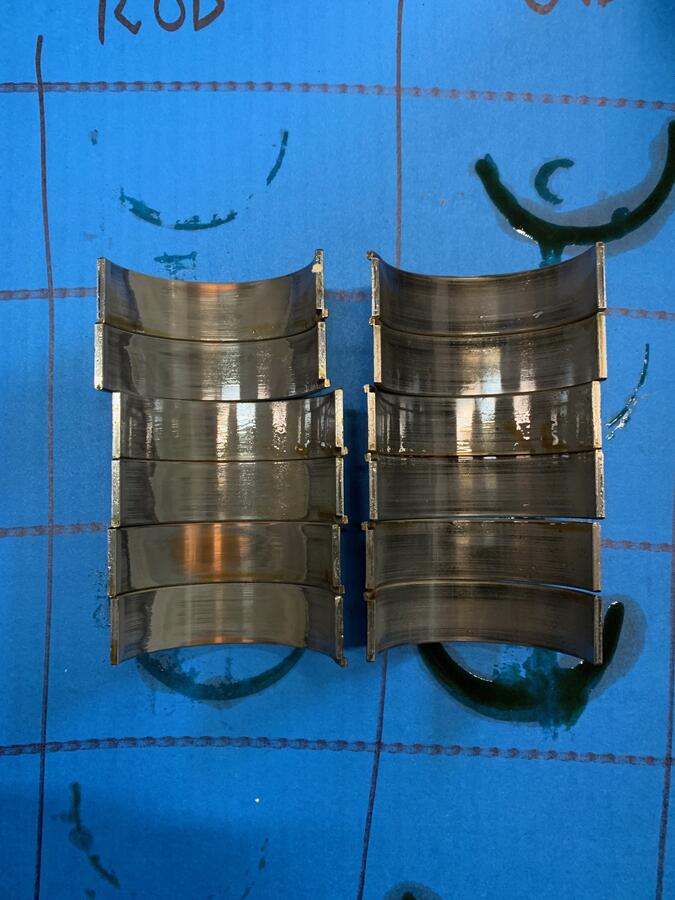

                    Here are mine. Done at 124k miles. I thought they were the original bearings, but kaiv noticed some evidence of a previous bearing job when he was in there. They had not been done in my ownership since 2011 at 50k miles and I do not recall or have the previous owner's records on hand to see when the original work was done.
                      #85
                      Lol, you really need to reread his post before replying to it.
                        #86
                        He said the bottom looks worse and the top looks better which is not true. Most have the tops worn, not the bottoms.
                          #87
                          Hi said the bottoms are "not excellent" which is what I originally said (edited to just say I think they look "good"). He went on to say the tops look end of life, which is a lot worse than "not excellent." Just interpretation. Either way...plenty of copper showing, and I hope this adds to the community knowledge with another another data point comparing Blackstone results and a real look at the condition of the bearings.
