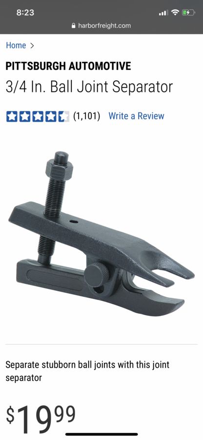

                This tool? Is pretty easy to use. Just don’t remove the nuts all the way. (Leave nut flush with threads)
                I think there is a 20% off single item floating around. (I might have it in my computer) I went 3 different times to purchase the 3 things I needed with the same coupon.

                  Oh, ball joint separator, you can borrow that from like O'Reilly's if you dont want to buy one just for one job.

                      And if I use the above tool(joint separator) will I have to get an alignment? Another cost?
                            You dont need one. I took the subframe, steering out as a unit.
