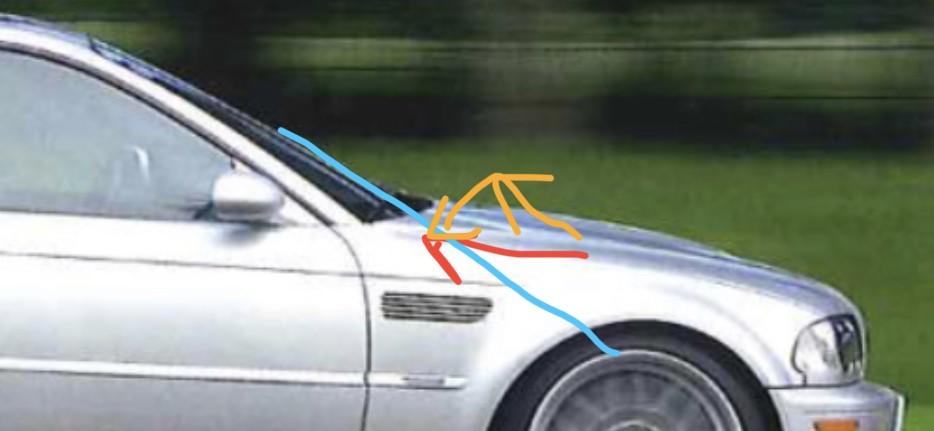

            The windshield cowl is actually quite stiff as the glass is bonded in and this design primarily adds to the shear load that the glass takes, particularly when in torsion. Glass is very effective in shear at adding stiffness. Triangulating to the cowl is effectively also tying into the A pillars and roof. A big bottom out bump would be the riskiest thing here as it might put a bending load on the cowl/glass (I’d have to look closer, it could be angled enough that it’s also pure shear but I doubt it).
            edit2: fun e46 fact: the tourings have bonded glass between the C and D pillars. This combined with their beefier RACP floor is likely why a touring is torsionally stiffer than a sedan or coupe
            I’m still personally pretty jazzed over this solution. Very clever.
            edit: FBD looks like this, so probably some bending loads going into the glass, as expected. I doubt it’ll be an issue, but I’m not a structural analyst. Force vector in red, constituent shear and moment generating forces in orange, plane of glass in blue. All approx just for visual representation.
            Click image for larger version  Name:	9D7B0F4D-5D98-4A9A-BE2E-8EE216A53126.jpg Views:	0 Size:	56.9 KB ID:	196198

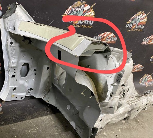

                    Pic from web, quick search to show the profile under the windscreen
Name:	1.c21VObax34Rjjl2JPxwsCoWa34DpkNWG.8ZbSW8XchdkzWL8krlzm5sgFJx_mOFAonWl3GINpiAU~2.jpg
                      Boxed in and gusseted, nice! Thanks for sharing that

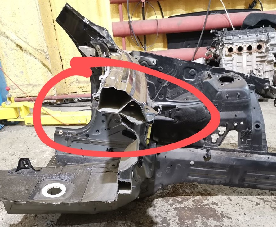

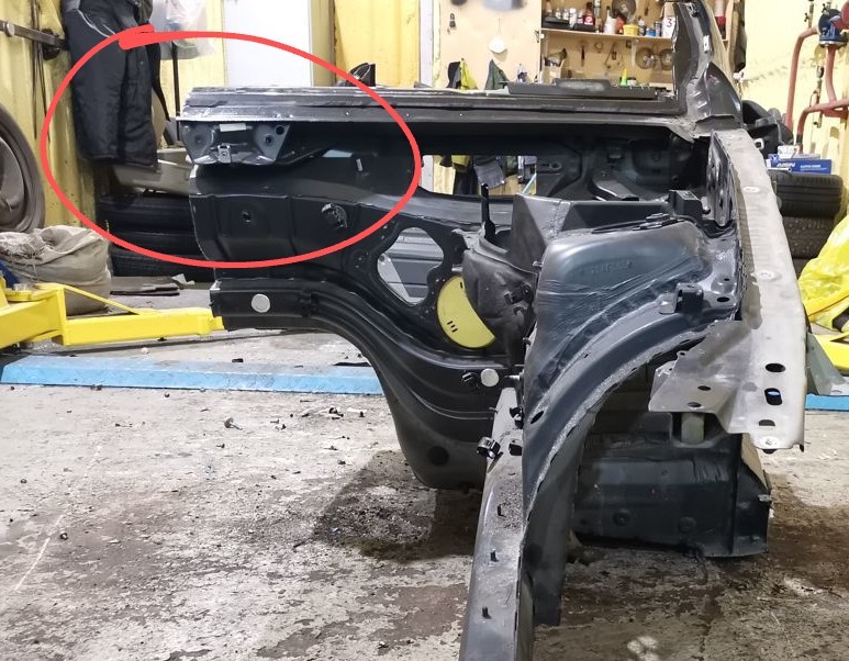

                        #71
Name:	1.aUSyEraxxa2EpUeg7GN-VXSxxakOu8-v.A64UVUiTr91JZiB-1Y0Jo-Hrri5kjJ34-1NGsagqasI~2.jpg
ID:	196210 Click image for larger version
Name:	1.fM4727ax0CcNbFIqT6pr3_140COHctol.5qUWCox_uzEbv95mzc-Dd4dVNqUvAtz70FRe7jM4J_s~2.jpg
                        didn't try to search pics like that previously, but nice for comparison)
                        This time e9x chassis (e8x 1 series the same) - all of them have center mount under the windscreen from factory.
