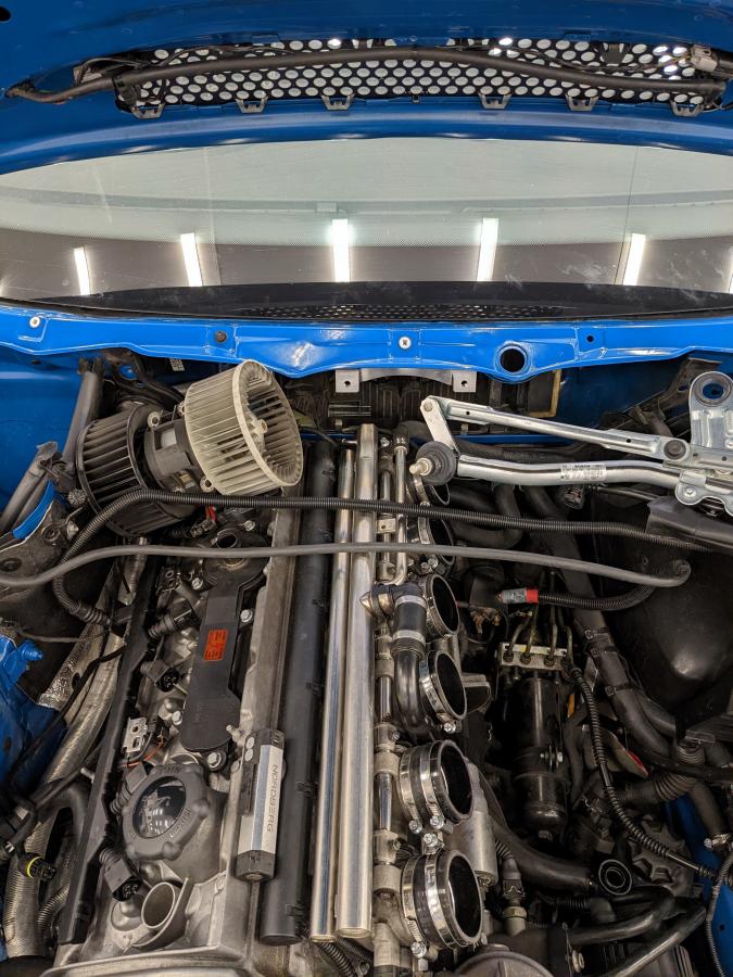

                    Beautiful Beautiful product. The things that concern me are access to blower motor, and ease of reversing install and mainly PRICE LOL
                    Test done
                      #55
                      Originally posted by Slonik View Post
                      Test done
                      Awesome! How was it? it’s already annoyingly tight in that area.
                        #56
                        Our "novice" mechanic made it for the first time, and with the strut removal etc it took less then an hour.
