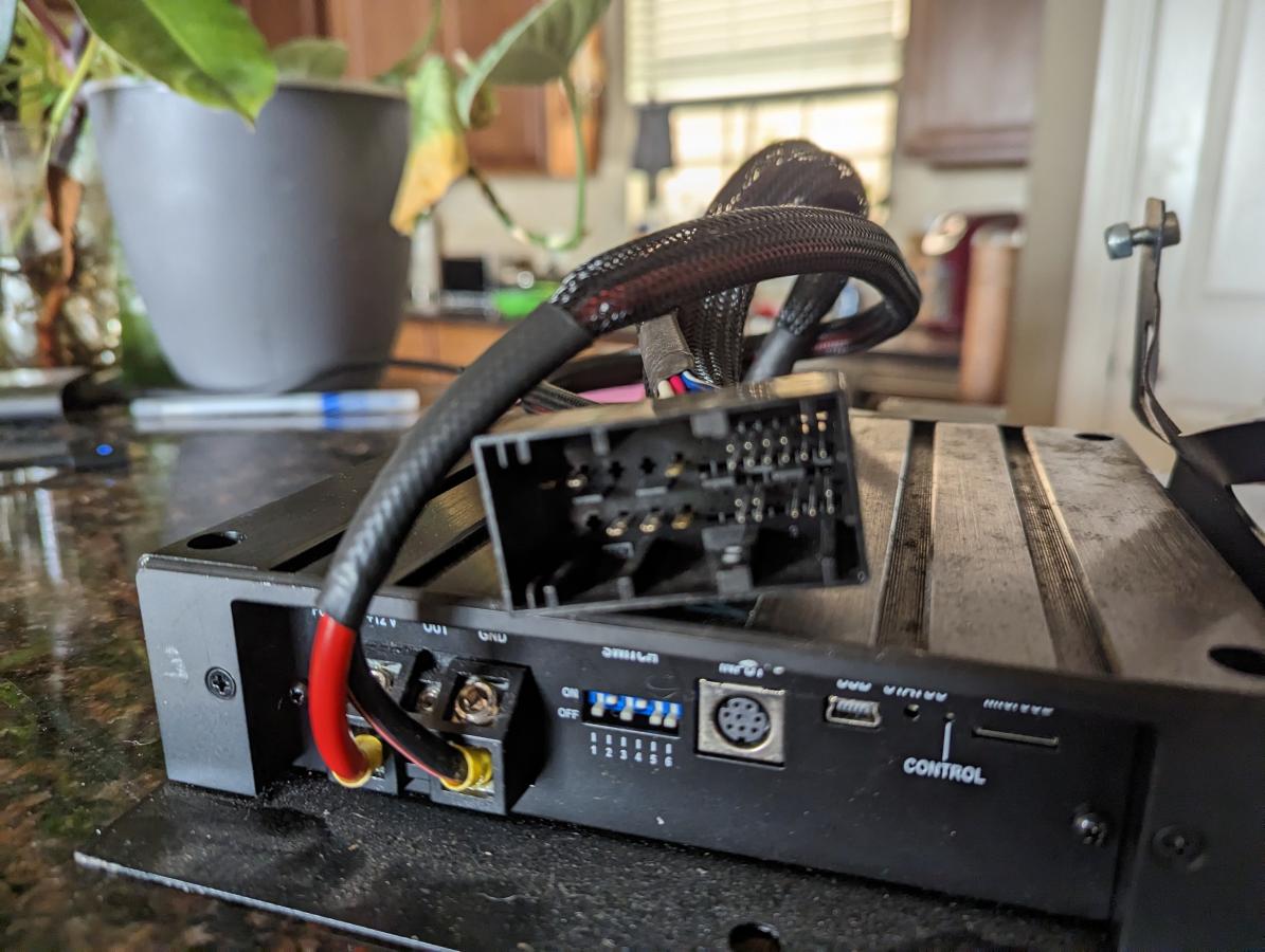

I wanted to update this post with my two new additions to the Match amp upgrade. The new Sony 6000 double din head unit and my Audison Prima 10” powered subwoofer. (yes i know the wires are ugly) lol Have something coming to cover that for the clean look. Also I would like to report I have had no issues with the Sony after the latest firmware. Now on to the subwoofer. This little subwoofer is amazing!, the sound is finally good in the M3. Hopefully this helps someone with their decision.

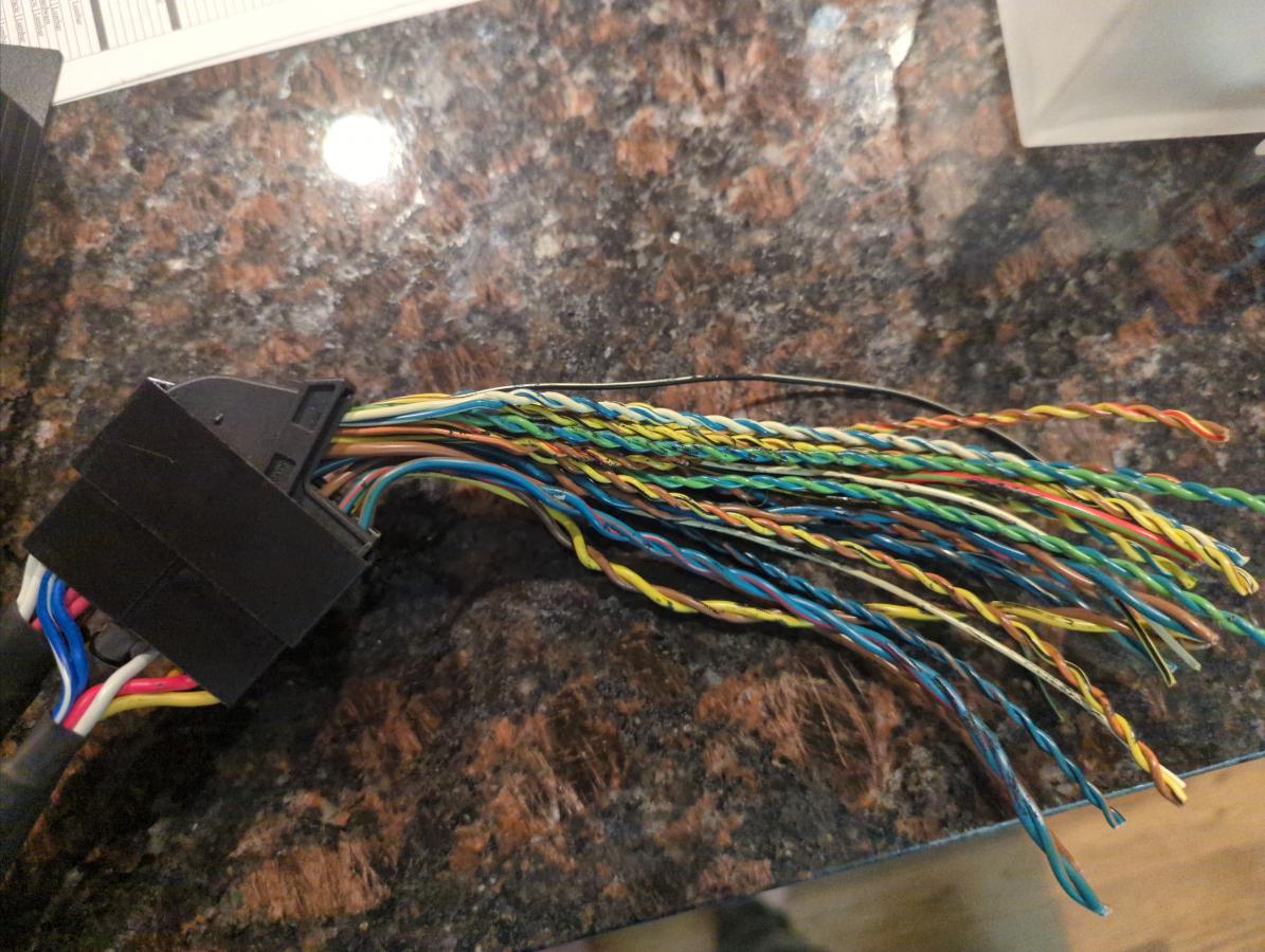

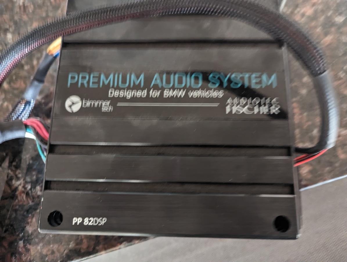

I have a pp82dsp 8 channel amp out of a f10 5 series with hifi and it appears to share a harness with the e46. I don't have my car with me but bought a hk amp pigtail to trace it out sofar it seems like it should work, not pnp. Bad pics attached for reference.
