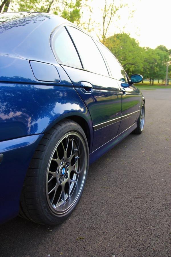

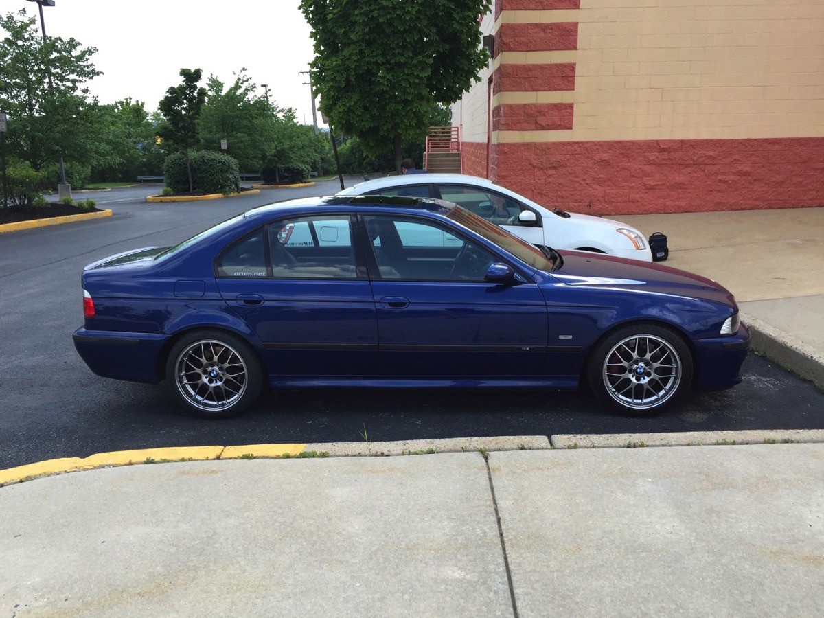

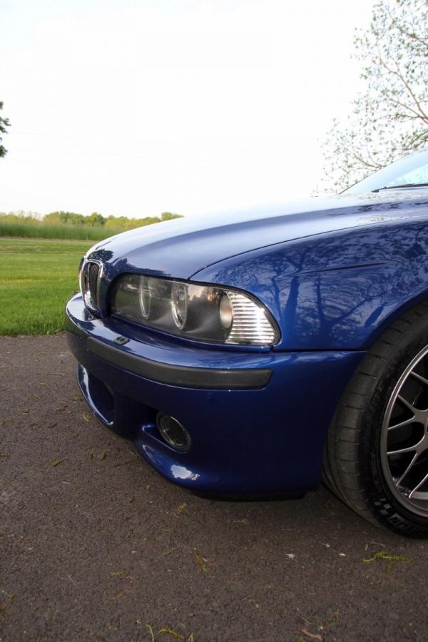

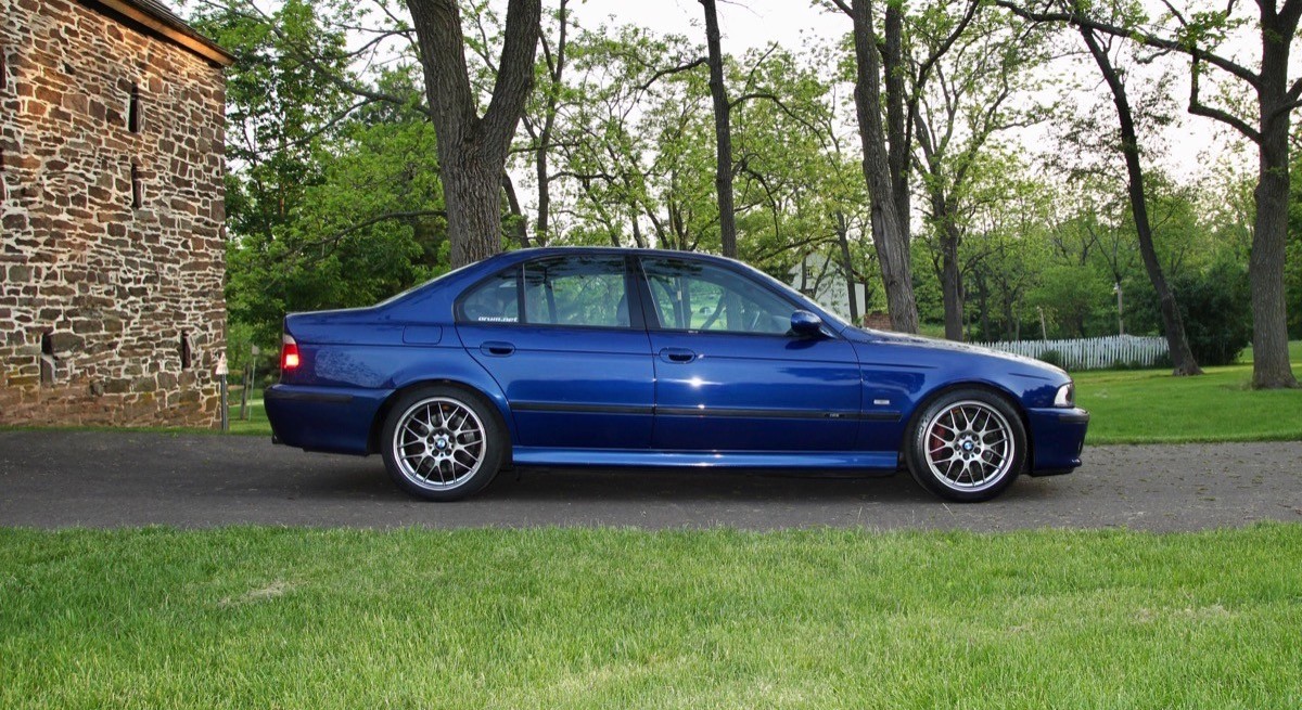

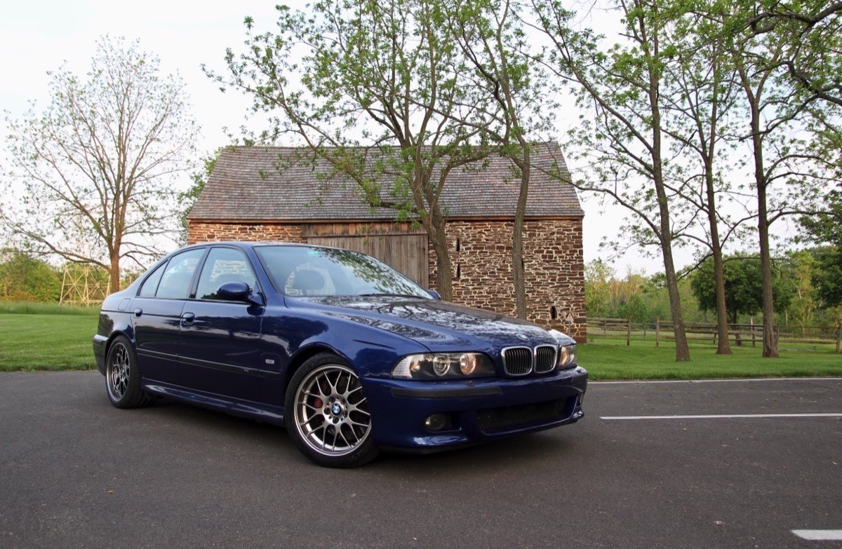

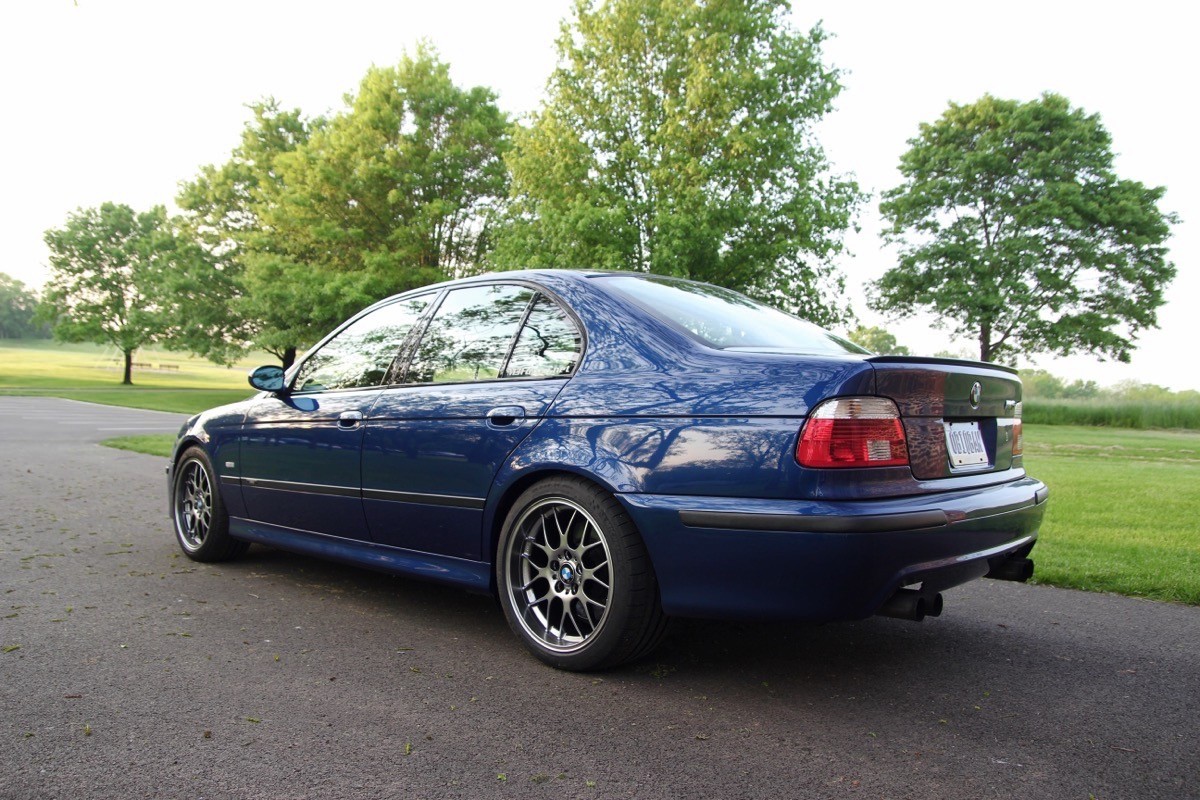

                              My RG-Rs, after I got them back from Prince (back in 2016):
                              Click image for larger version  Name:	IMG_7569.jpg Views:	3 Size:	339.2 KB ID:	196547 Click image for larger version  Name:	IMG_7564.jpg Views:	3 Size:	82.1 KB ID:	196548 Click image for larger version  Name:	IMG_7551.jpg Views:	3 Size:	64.3 KB ID:	196549 Click image for larger version  Name:	IMG_7550.jpg Views:	3 Size:	300.7 KB ID:	196550 Click image for larger version  Name:	IMG_7547.jpg Views:	3 Size:	332.8 KB ID:	196551 Click image for larger version  Name:	IMG_1302.jpg Views:	3 Size:	405.5 KB ID:	196552
                              Click image for larger version  Name:	IMG_1179.jpg Views:	0 Size:	269.6 KB ID:	196553
