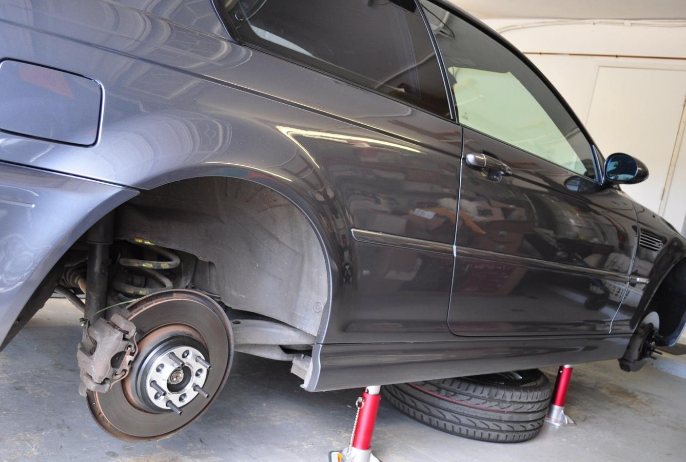

          Yes I did used jack stands for subframe reinforcement more than once. Here is a pic doing it on my Interlagos blue M3 Dinan S3R and my Estoril blue M3:​

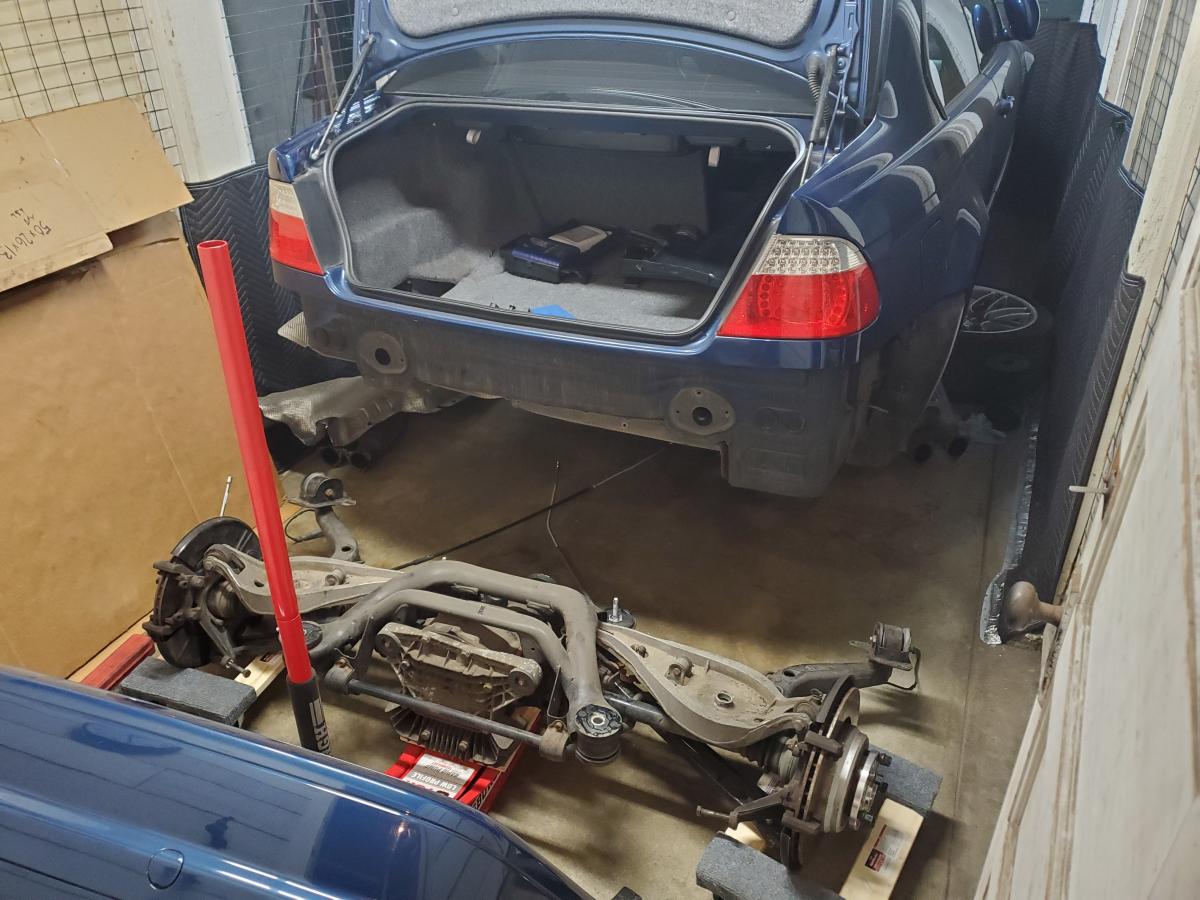

              IMO, jack stands are the best if you're pulling out the entire rear end. Just have a long reach jack and two harbor freight furniture dollies for the wheel hubs.

                        That's how I've done mine too:

                        Tip for others attempting this: don't rest the brake dust shields directly on the dollies unless you want to spend some time rebending them back into shape when you're done. Instead, stack a couple bits of scrap wood on the dollies and rest the hubs/camber arms on those.

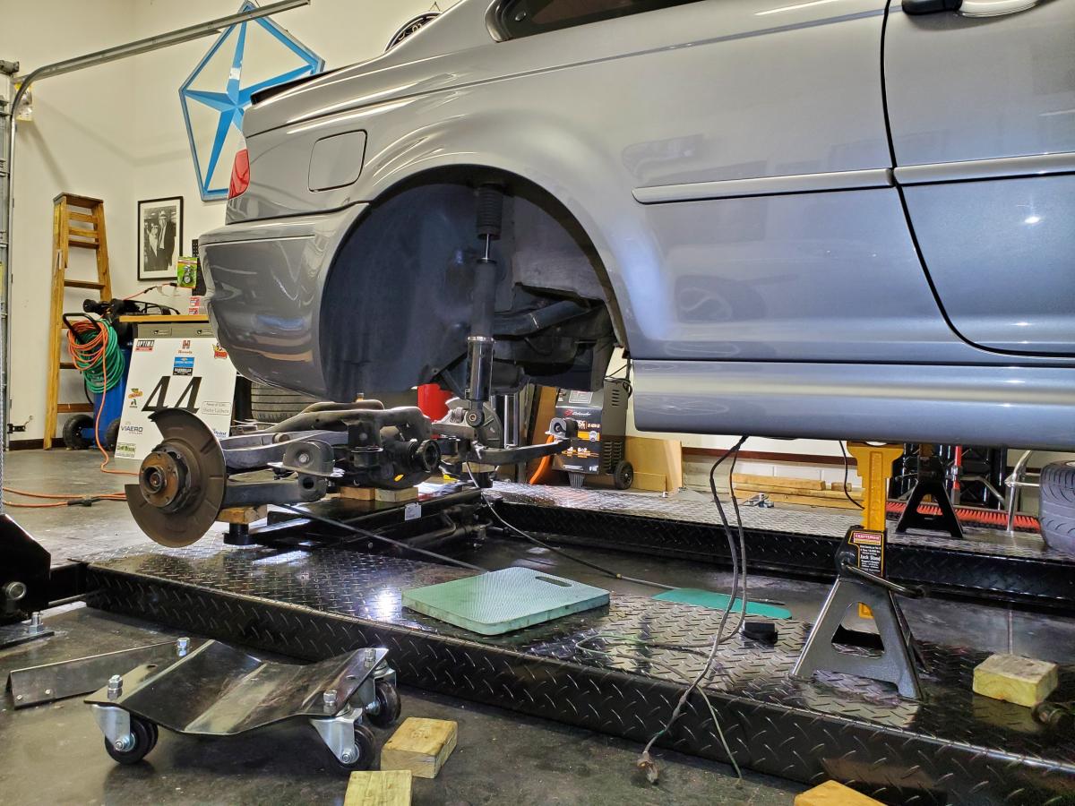

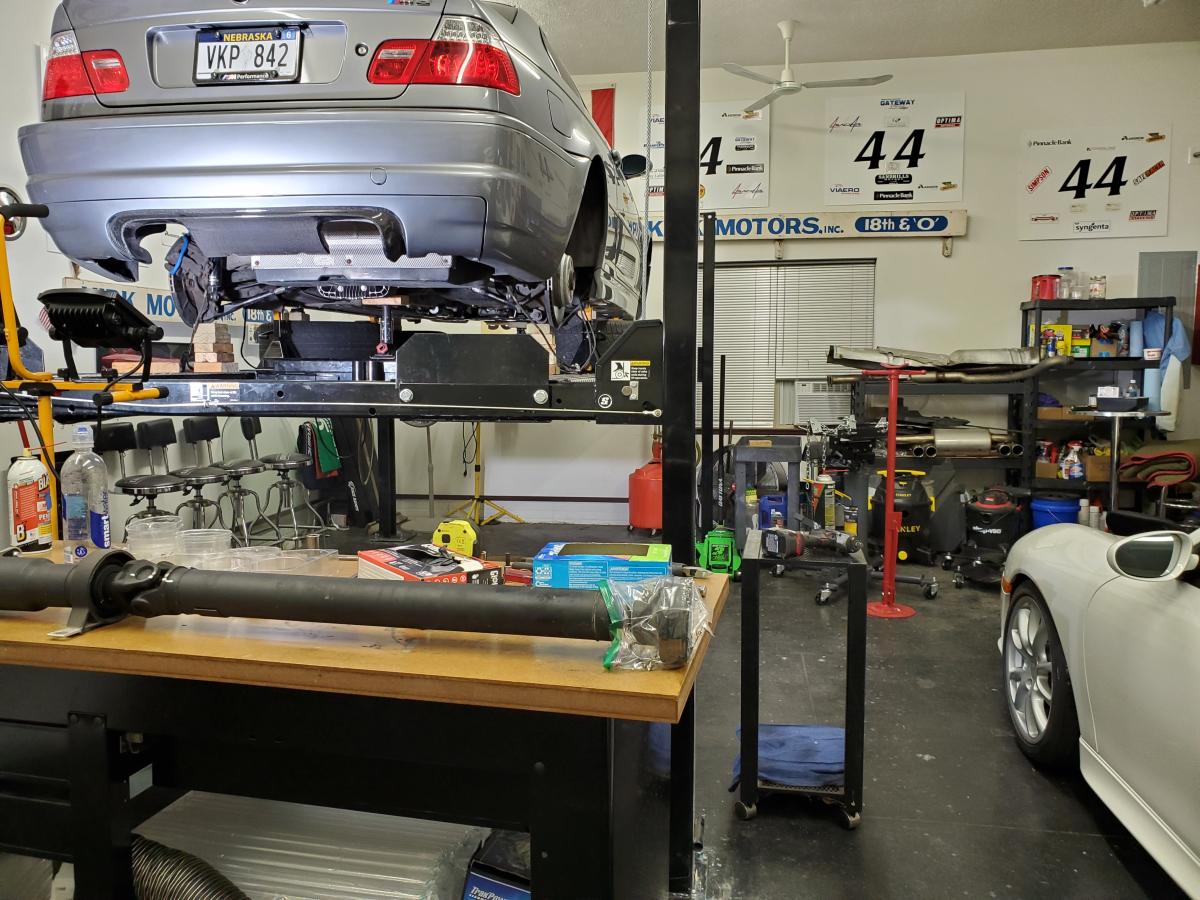

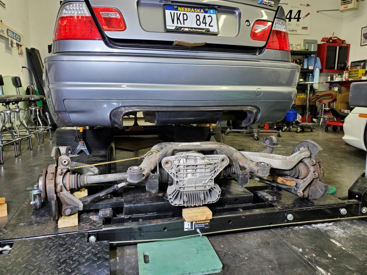

ID:	198832 I used a 4 post with jack stands, my 4 post has a sliding center jack which helped, the best thing would be a 2 post and a hydraulic table etc. as mentioned.
                          A lift is cool just for the fact you can disassemble while standing of course but a 4 post really gets in the way of suspension related items so the jack stands fix that.

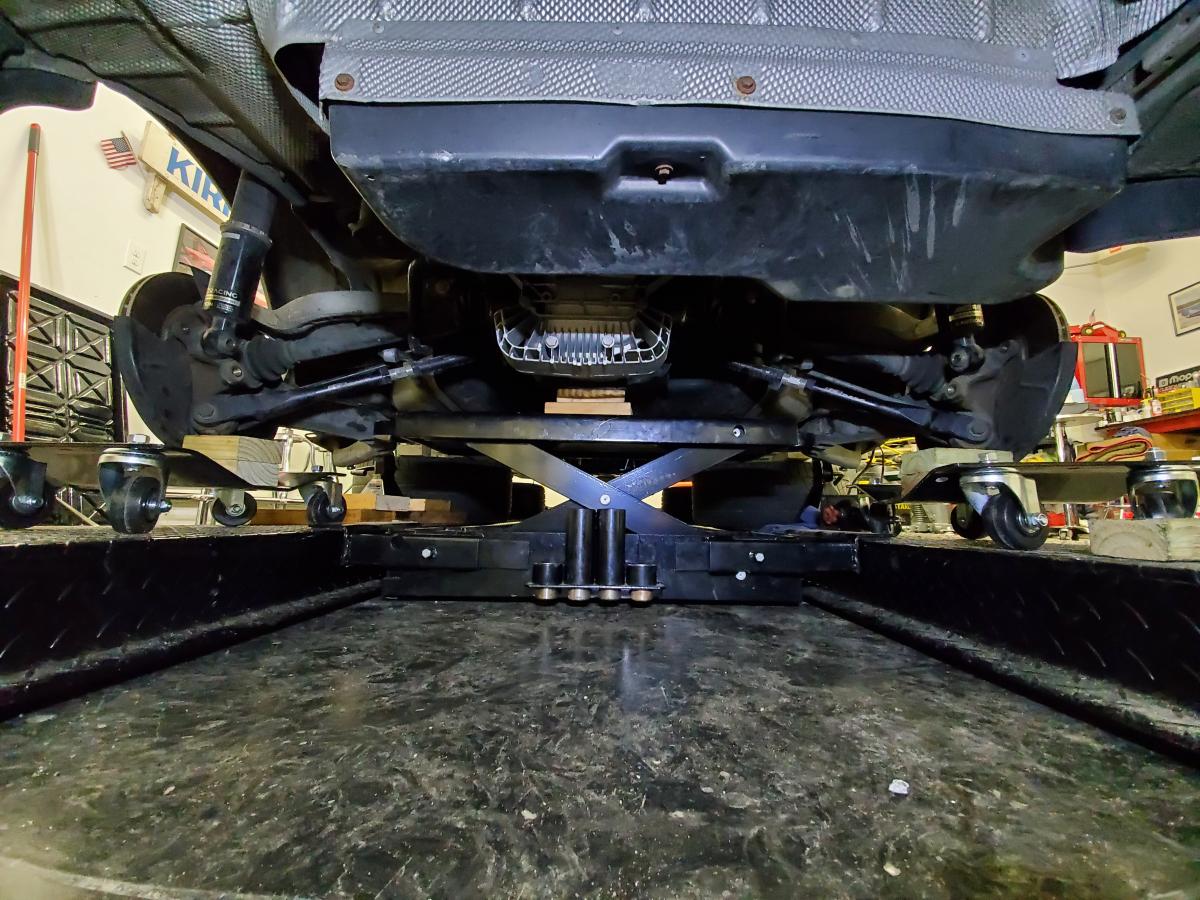

                          I guess I can't picture how a QJ gets in the way?

                            It doesn't for a subframe/rear end drop, zero issues with quick jacks for this specific task. Others are mentioning jobs unrelated to subframe or just their personal preference. Dropped mine on three separate occasions. Only tip is to make sure you can access the big v-shaped reinforcement bar edge bolts before lifting which is just a matter of positioning the lift rails.
