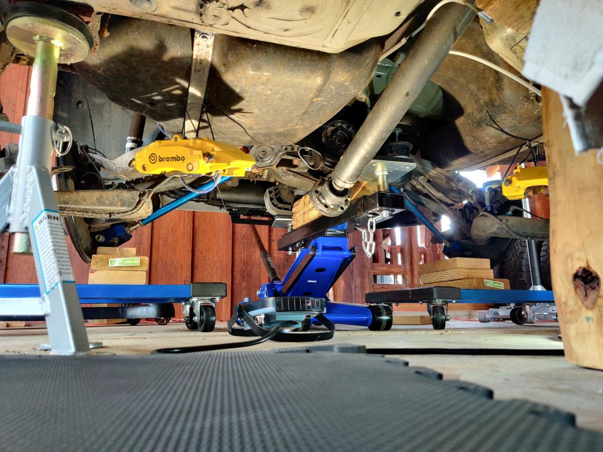

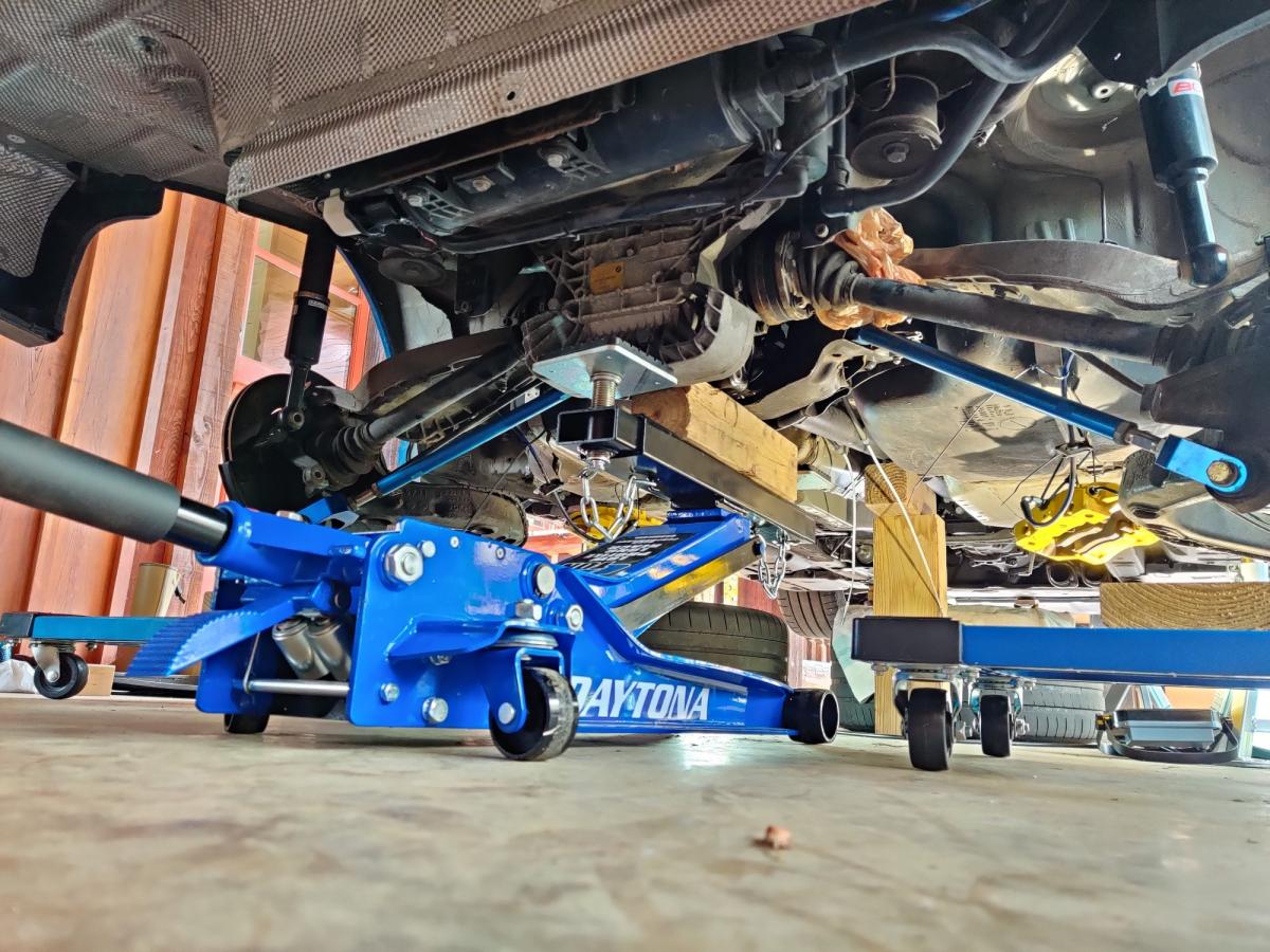

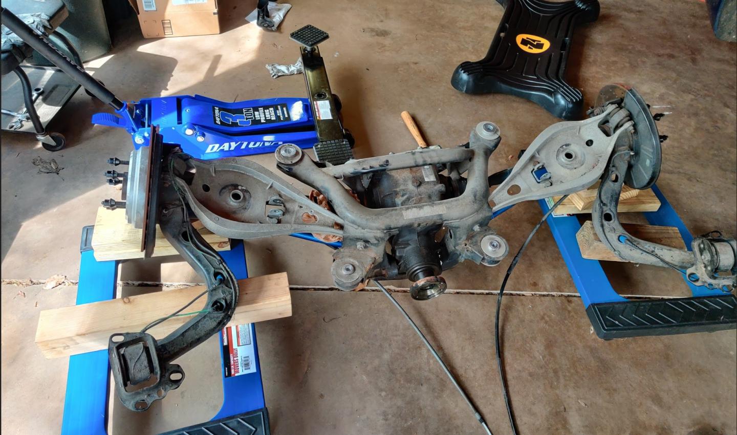

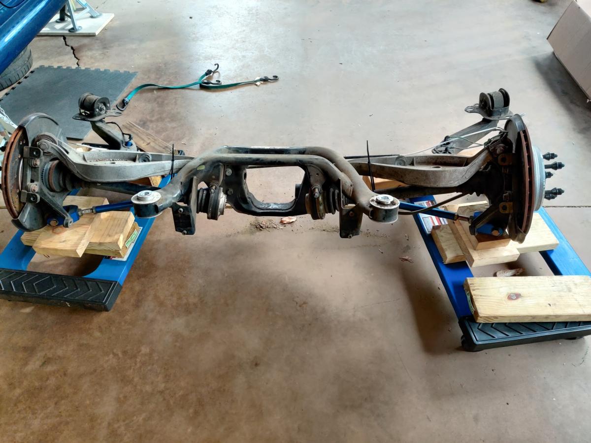

    I did it with jack stands too. Adding pics to show what heinzboehmer was trying to say, I believe.
    Also, it's good idea to keep the rear wheels under the car while you're banging away at stuff. If the car happens to fall (shouldn't be an issue if you have it supported correctly), the wheels will stop the car from pancaking you.
      Yep! That's exactly what I was talking about

            I did mine using the quickjack. I get the complaints about side access, and for a job where you are going to have her in the air for a long while then the hassle of getting it up high enough on jack stands is no big deal.
            The quickjack is nice when you want to get her up, well, quick. It was not a problem to get the subframe out with it on the quickjack.

              I did a complete RACP replacement on jack stands. it was a PITA but doable. I now have a quick jack and would not hesitate to use it for the job. Just get used to lying on your back and side a lot! A creeper makes a big difference. One thing I did that made life a bit easier was build a cart big enough to support the entire rear subframe. It was 2x4's and cheap HD casters, maybe $25 in the entire thing. It made life so much easier moving the subframe around after is was dropped. Also, do whatever bushings in the subframe assembly you think you will ever need to do. Now is the time. I regret skipping a few.
