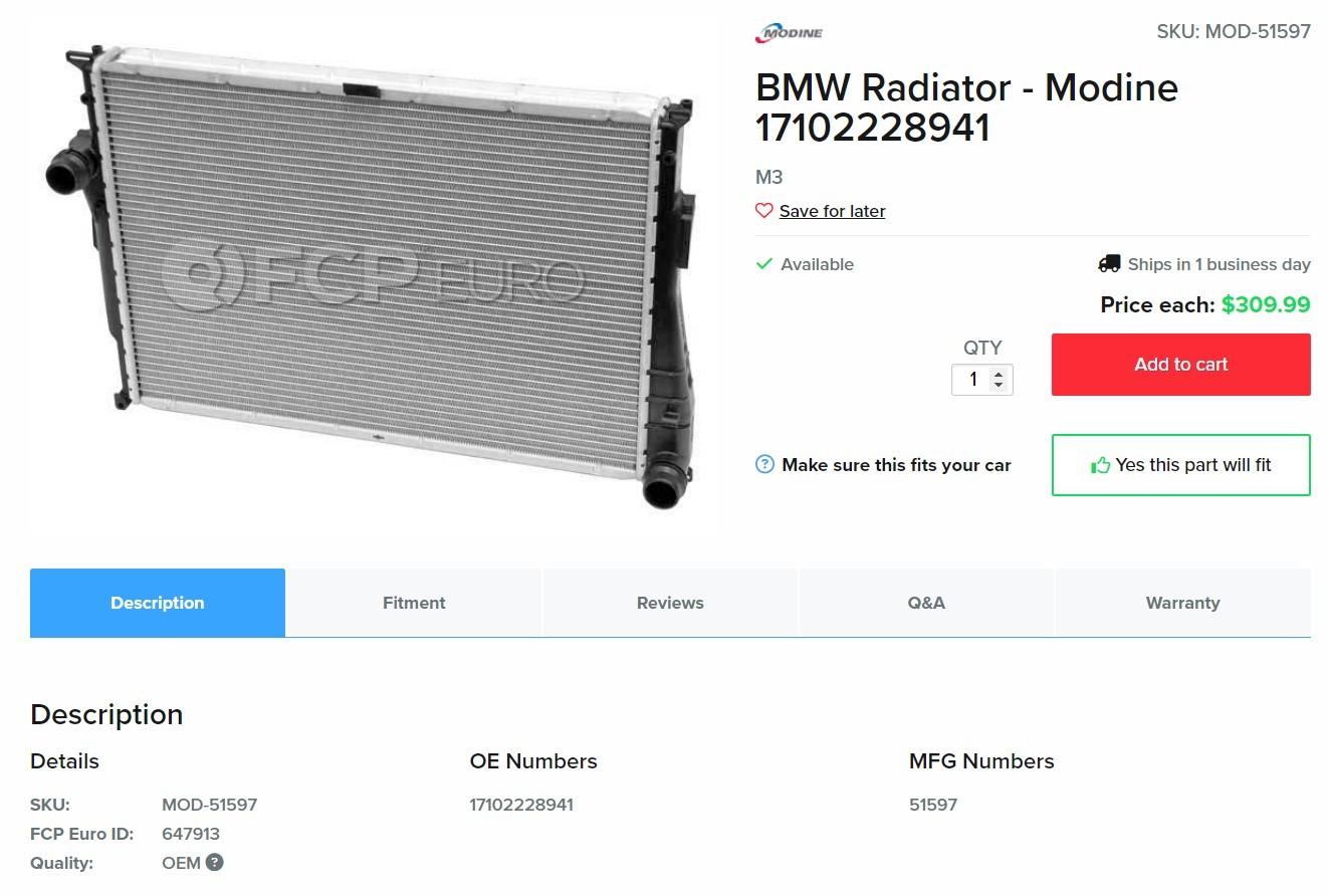

                          Click image for larger version  Name:	Screenshot 2023-08-17 190958.jpg Views:	3 Size:	163.6 KB ID:	229471

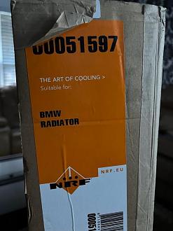

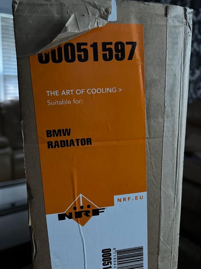

                          Checked yesterday and showed that they were back in stock, and is now classified as OEM. I decided to order one and see what shows up and sure enough, an NRF box got delivered.
                          Weirdly, I ordered it 3 pm yesterday (16th) and already showed up this morning (17th)
