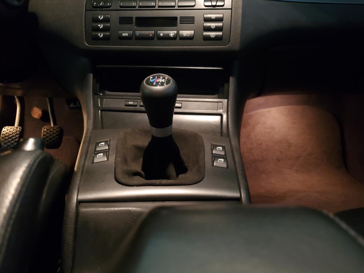

                      It won't. Just don't install the lever backwards. Test before you put everything back together 100% lol
                      You were right.
                      330d:
                      AutoSolutions:
