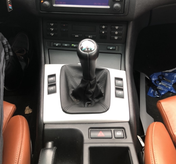

      For reference, here is where the longer version of the E60 shifter sits (cinnamon interior) versus stock. Feels the same to me. The bigger adjustment was the half inch or so shorter knob height.

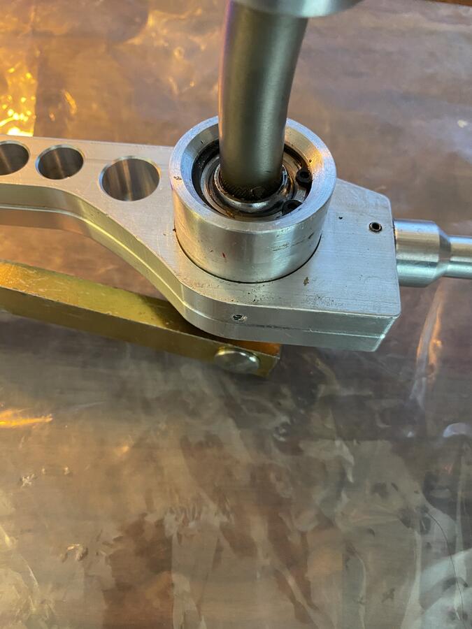

                      Bumping this as I'm confused between all the autosolution versions, some use the plastic cup, some seem to have some kind of bearing instead of the ball (ultra?), and most confusing of all the autocross version is just metal on metal ball sitting in the carrier? Anyone with good pics of their version, or which is generally regarded as smoothest?
                      Here's a picture of the autocross version, from the posts in this thread what I understand is this shouldn't use the nylon cup, but I don't see how that's possible (though its missing in the picture):

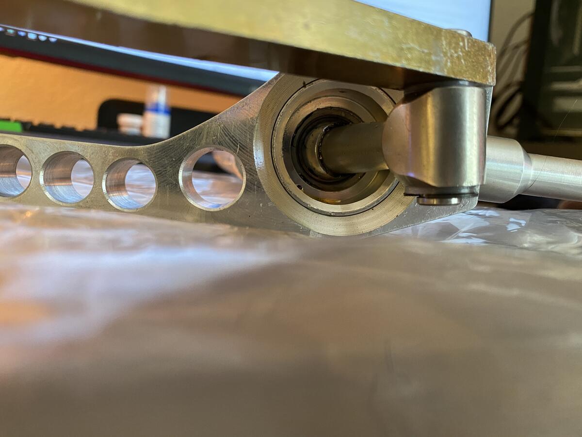

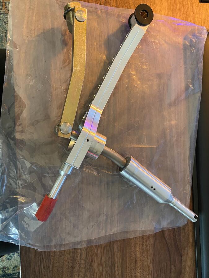

                          Here are a few pics of the AS AutoX shifter assembly I just received from Ronald. Don’t have anything to say about the installation or what it feels like, having only just unboxed it.
ID:	101486 Click image for larger version
                            Thanks a lot, weird that all the pictures I'd found were missing the bearing in them.
