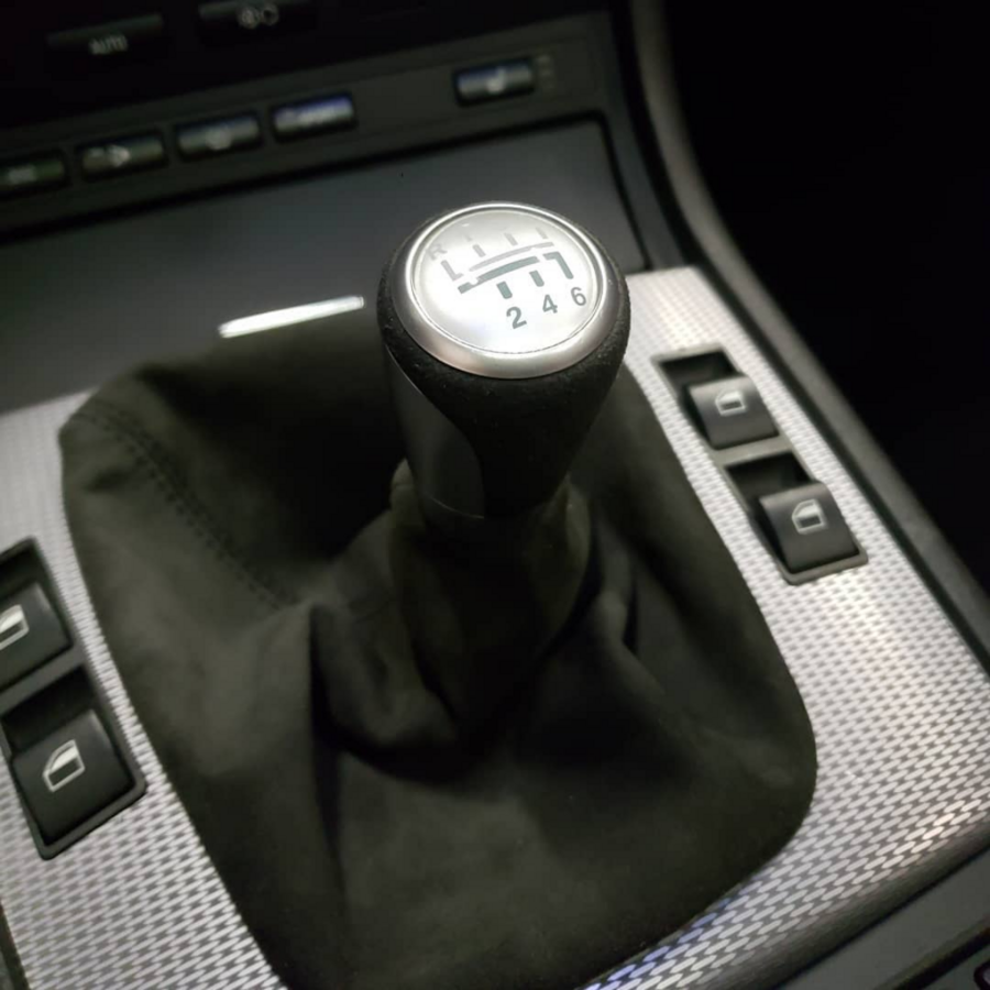

                          There are other dedicated threads to the shift knobs so won’t derail SSK topic other than this answer.
                          There isn’t any one-piece weighted M3 gooseneck knob and boot to my knowledge. There is a weighted gooseneck “knob”, it is NOT lighted like factory stock knob/boot (or F10 M5 stubby weight knob/boot) though. Its p/n 25117896884.

                              Not supposed to be.
                              I have a bmw lighted 6 speed knob with a divorced alcantara boot, that metal ring on the collar of the other knobs just bugs me.
