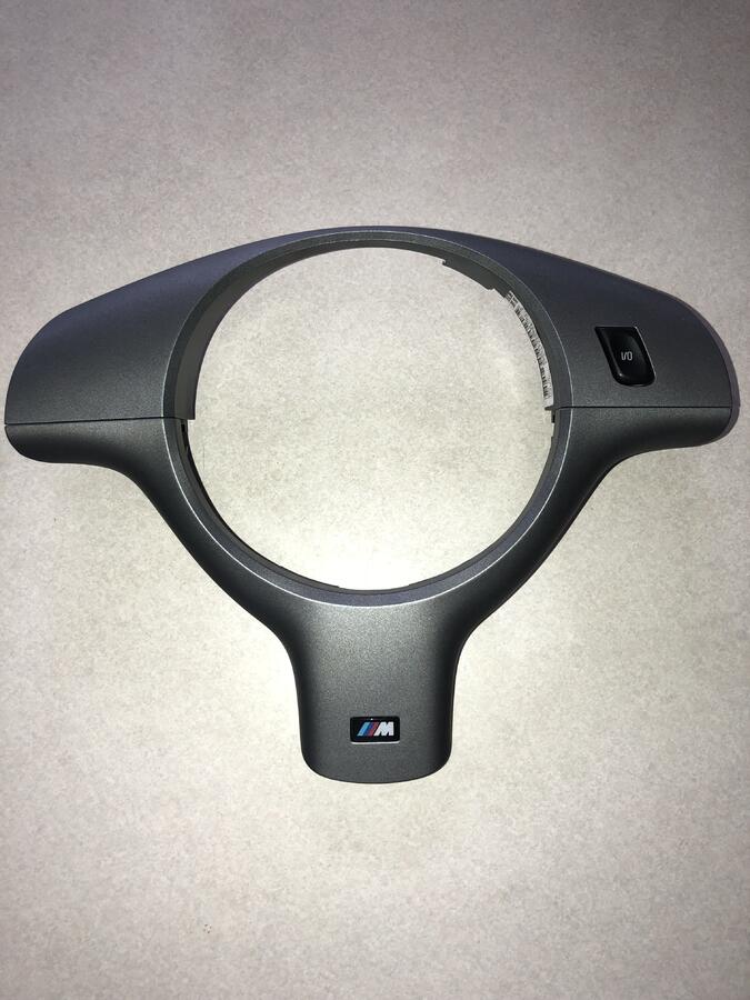

        I repainted parts of my trim a couple years back and got some good results. I used black primer, Dupli-Color Medium Gray Metallic GM, and Krylon Matte Finish.
        Can't remember exactly how many coats of each I used, but I do remember having some trouble getting everything right. Had to sand everything off a couple times because using too much base coat would not allow the black primer to show through and the color match would be off and using too much clear coat would make it hazy.
        ​Turned out pretty good, but I ended up spending close to what TexaZ3 charges because of how much I repainted. If I had to do it again, I would send it out to him instead.
        Edit: Actually, I was looking through pics and I originally bought the medium gray metallic, but I'm pretty sure I ended up using storm gray metallic, as I ran out and that's what my local auto parts store had in stock. Both were pretty close matches though, with medium gray being slightly darker IIRC.

          That's the formula that worked for me.
          Pretty much indistiguishable from OEM.
          It's been 5+ years and it still looks new..

                  3m matte grey metallic vinyl is almost identical to the oem trim
