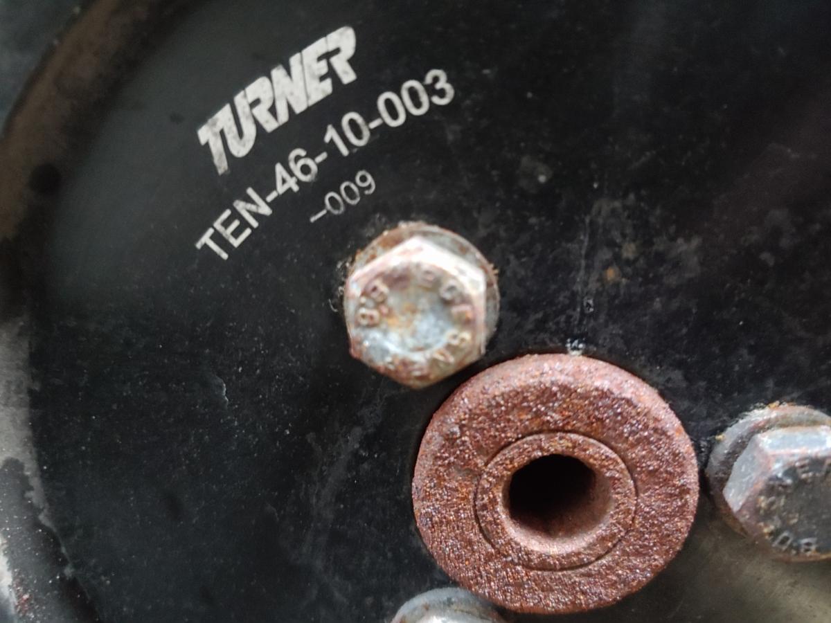

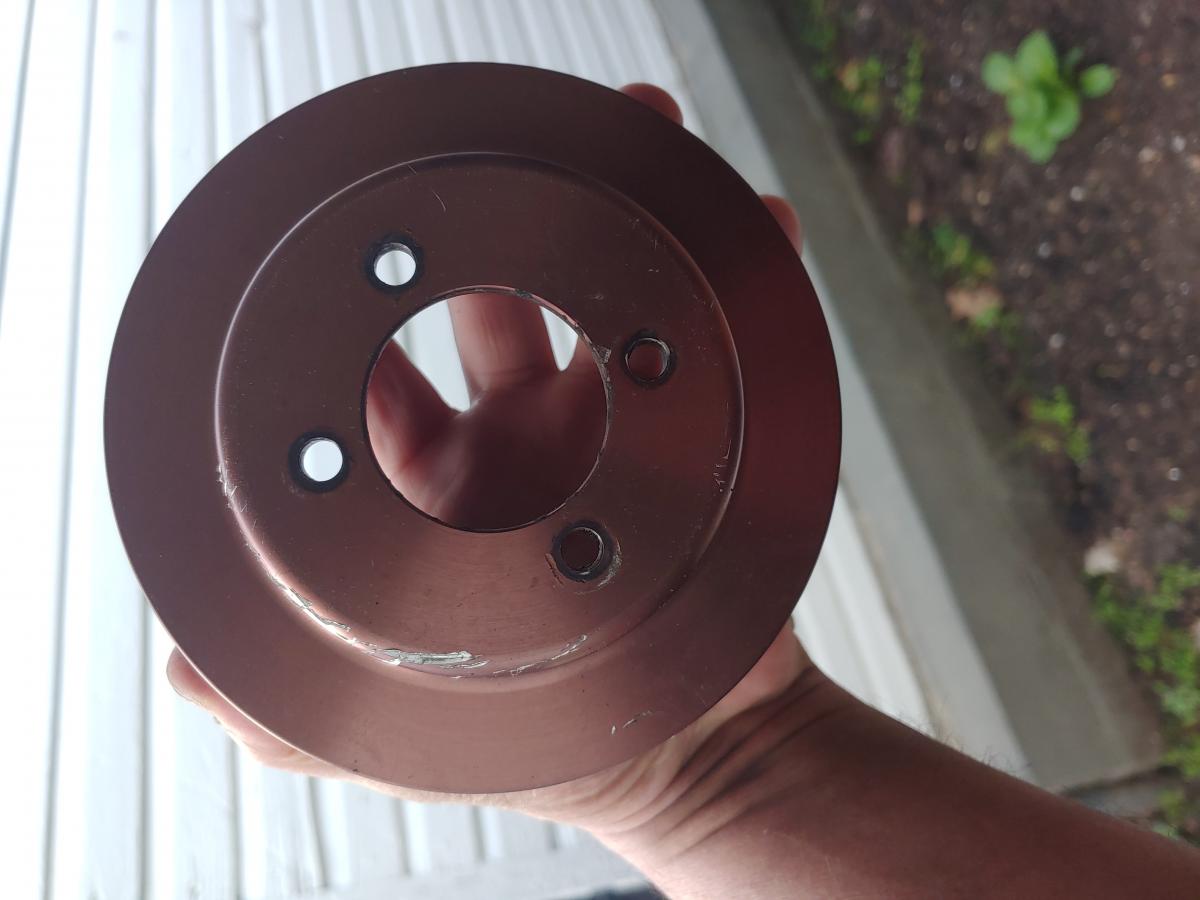

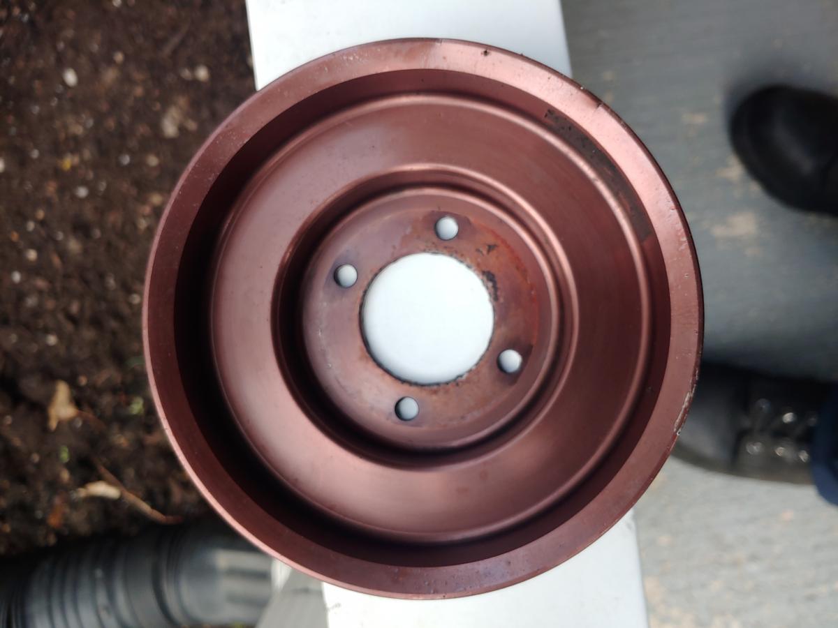

    So I decided to change the water pump, while I change the thermostat, upper and lower radiator hose, fan clutch and fan. So I realize that it's not a stock water pump pulley, Can anyone identify this pulley?
    I have the tuner power steering pulley, so I'm assuming it's a tuner water pump pulley.

                    Do anyone know what brand the what brand pulley that is in post#16. I need to get a new pulley. When I took out the old one I bent it, so if I go back to stock I gotta try to find which belt that fits, cause I have a aftermarket power steering pump pulley.
                      Looks like Turner Motorsport.

                            So I measured the diameter of the water pump pulley, and it reads 5.312inches or about 135mm. Does anyone know the size of the stock pulley? The belt on the car is 6pk1535.
                              Temp looks normal.
                                When i get home I'll look at my box. I saved the proper size belt for the Turner Power Pulley Street kit. I believe it is 1535 but I want to be 100% sure before I say for sure. It includes a larger power steering pulley and alternator pulley so just throwing a stock pulley on is a no go unless you make those stock as well. Ultimately I don't think you ever had a failure of your cooling system but you're not worse off with preventing a failure. I'm at my 4 year mark and it almost time to redo the thermostat and water pump. Coolant also has a 4 year service life per BMW.
