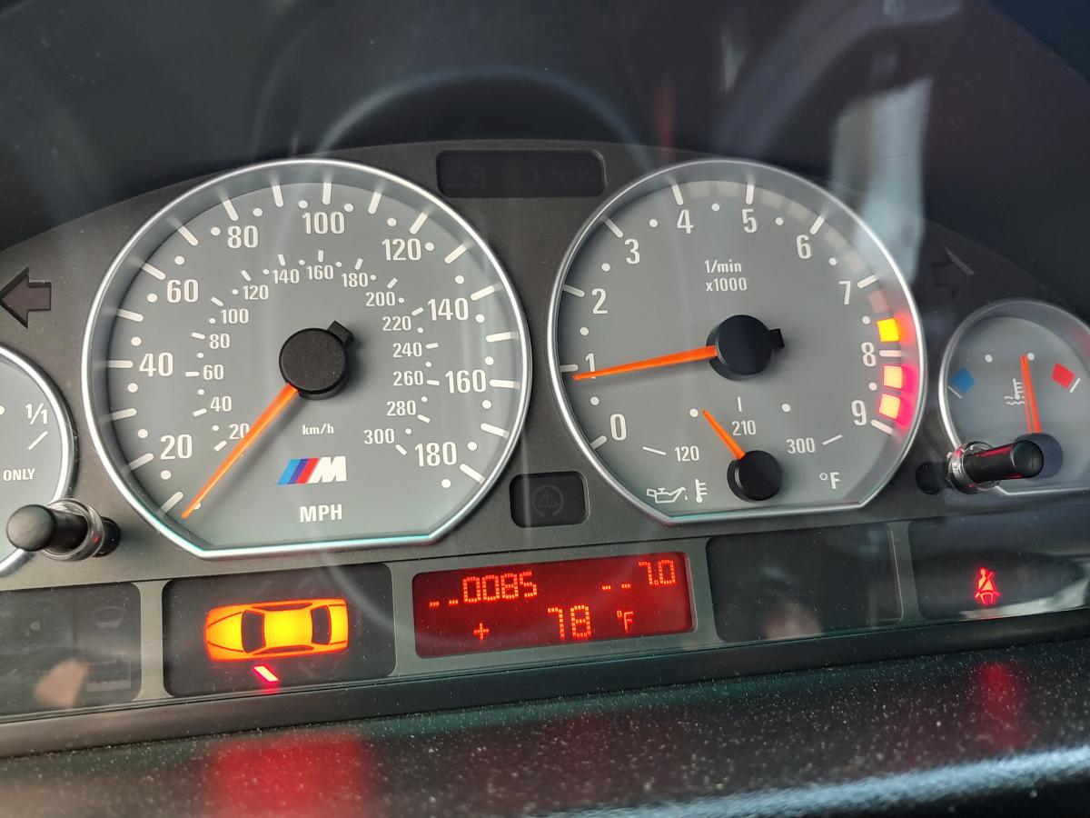

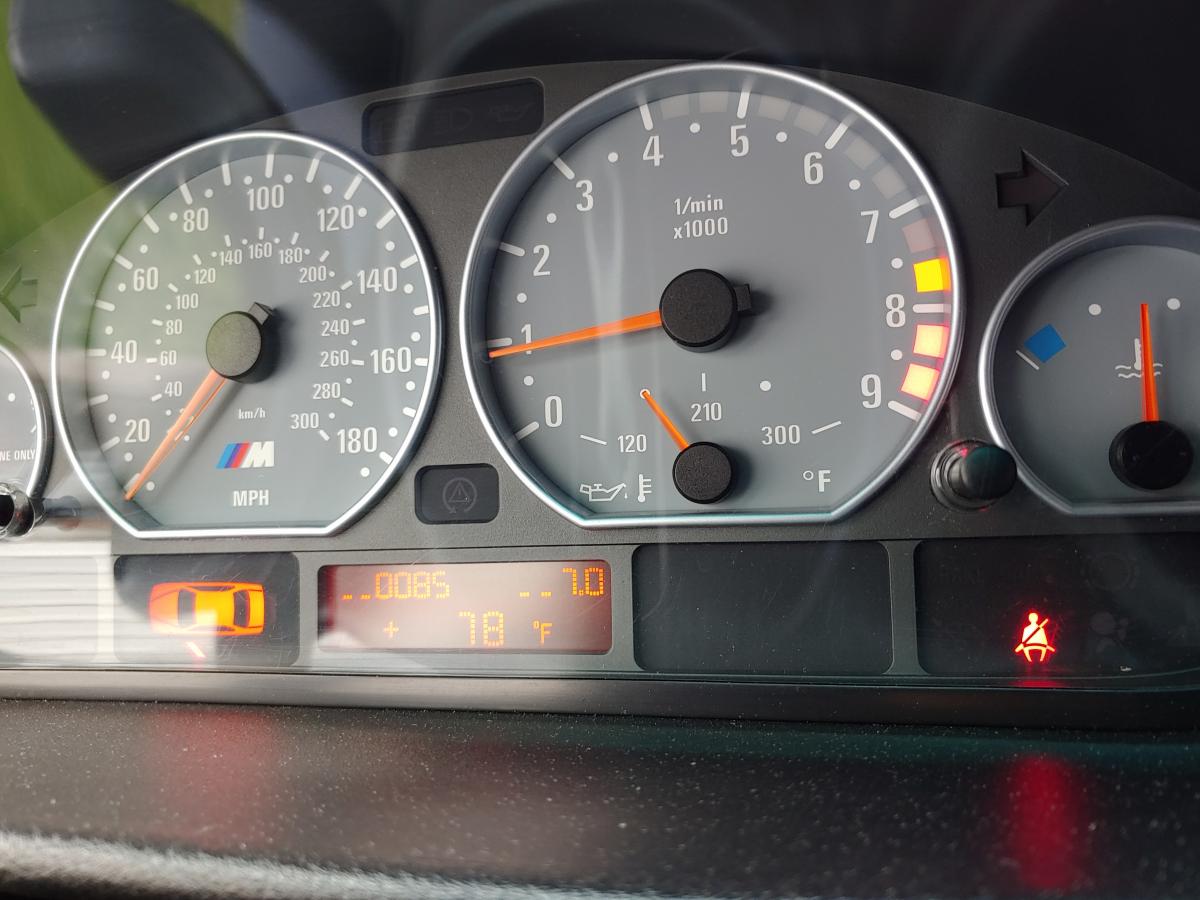

            #35
            Just finish putting after thing back together , here is the temps now.
              #36
              85C (maybe a little higher) is about where mine sits read via BlueBus from the Ibus (in normal daily driving). Oil temp should be bit higher though once fully up to temp IMO.

                  #38
                  After driving a bit. Temps were at 88-91c

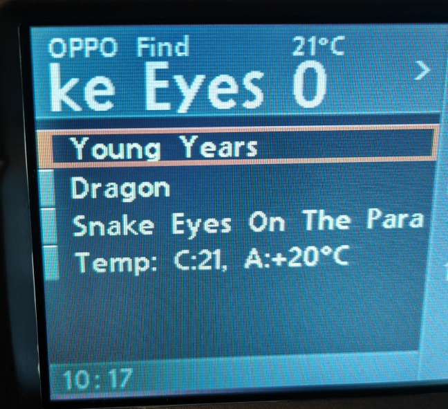

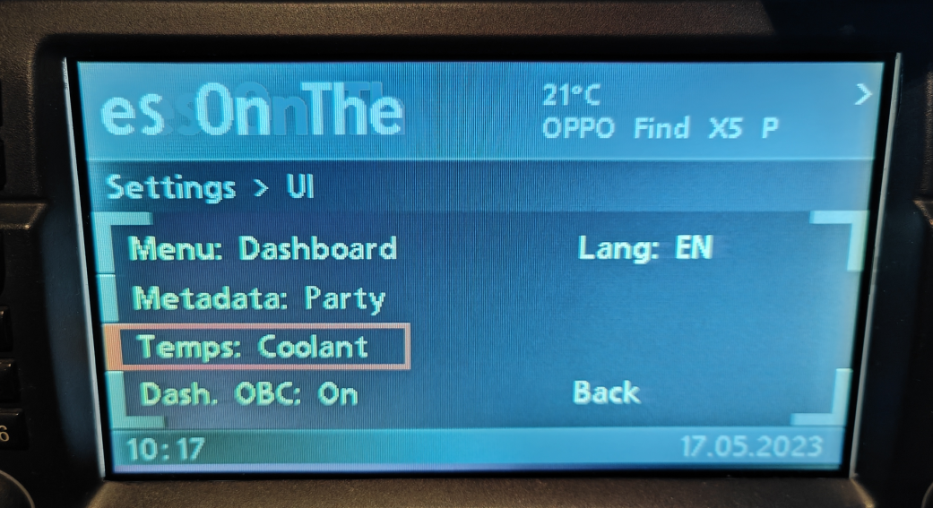

                    Originally posted by Grke46m3 View Post
                    How do you get bluebus to read water temp?
                    Settings -> UI -> Temps
                    On non S54 cars you can also get oil temperature
                    There is also a way to have them all on a line in the display like this but it sometimes just ​doesn't work for me (C=coolant, A=air, O=oil). I think that might be the Dash. OBC option above:
                      #40
                      Sounds right on.
