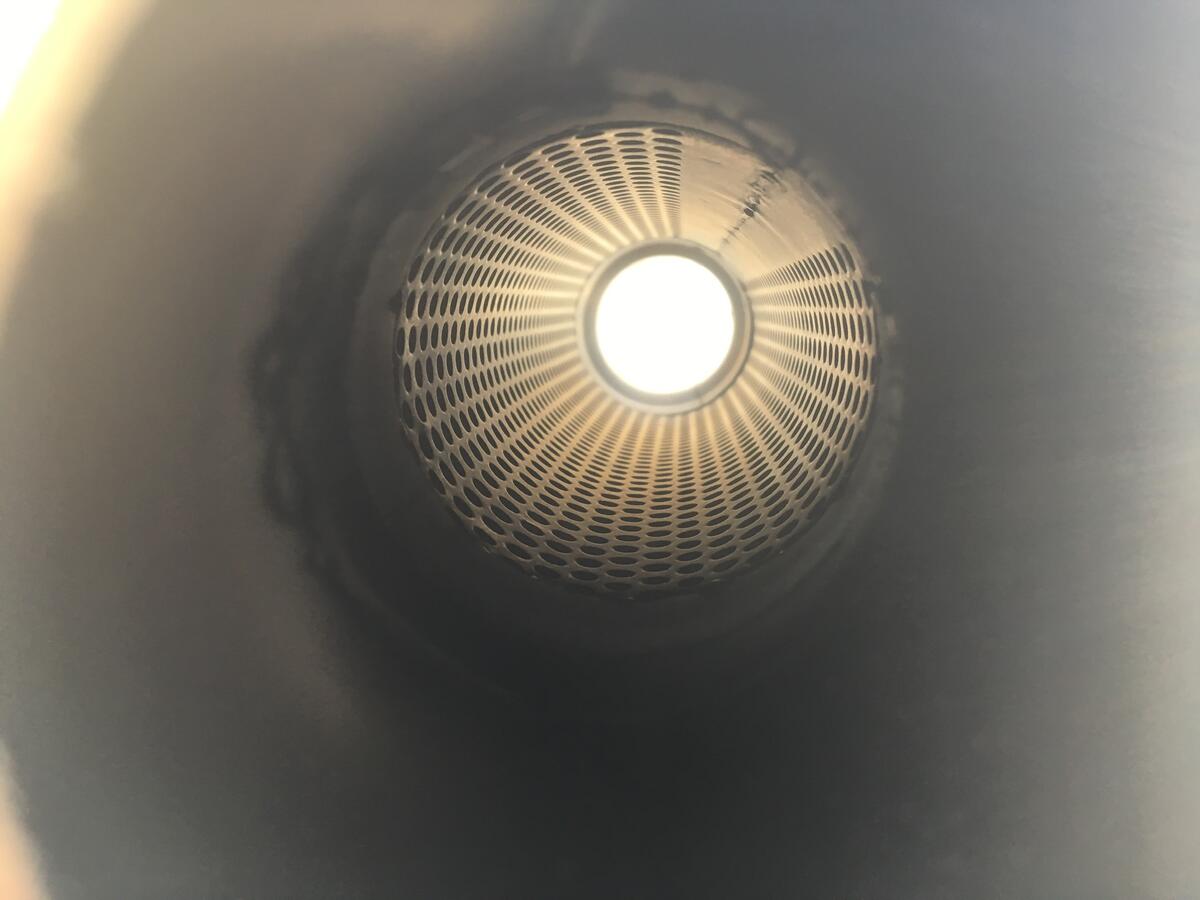

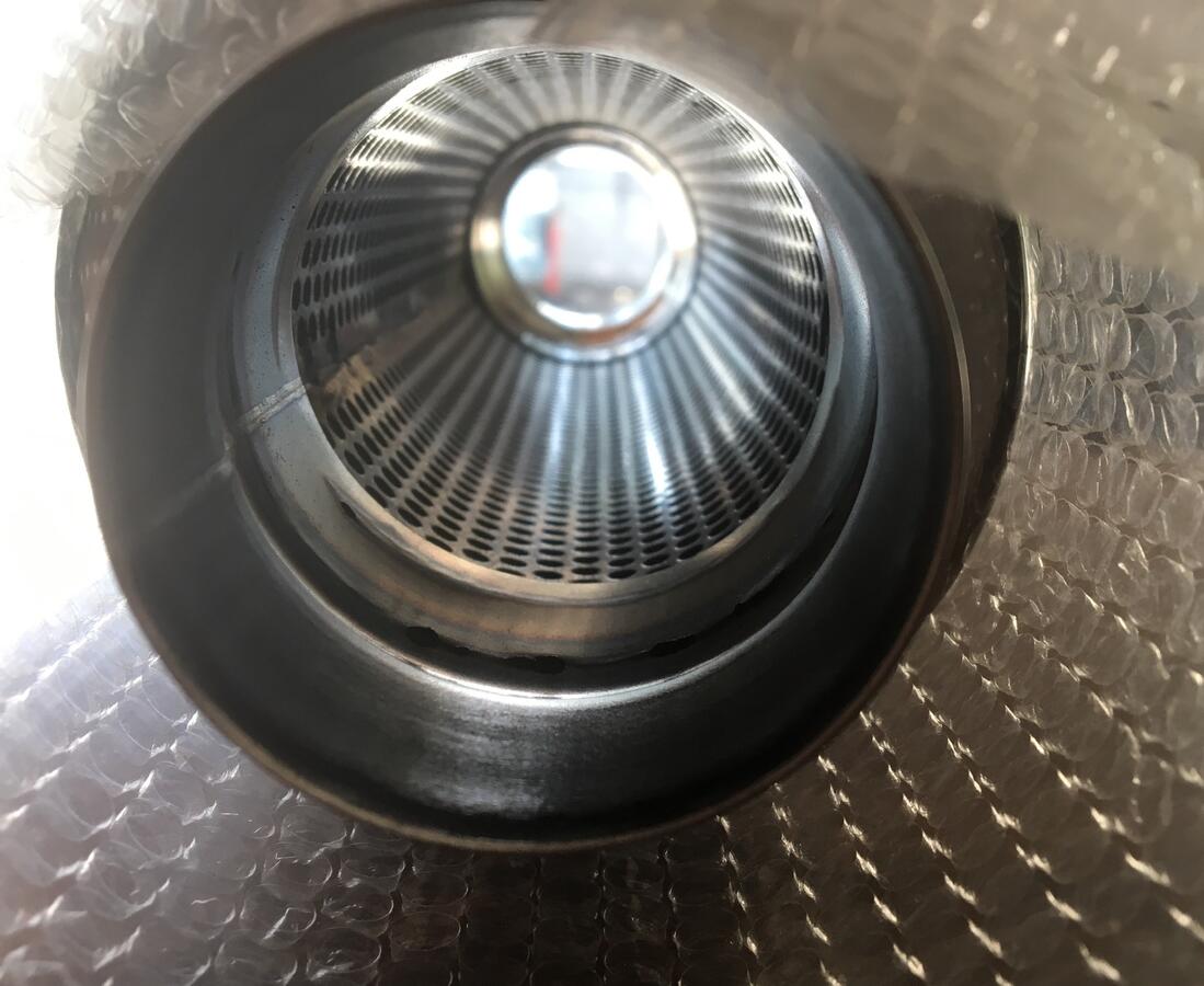

                  #53
                  Agreed the AR20 for the stock piping.
                  I actually had to replace mine after like 12 years, the internal perforation cracked and rattled.
                  old
