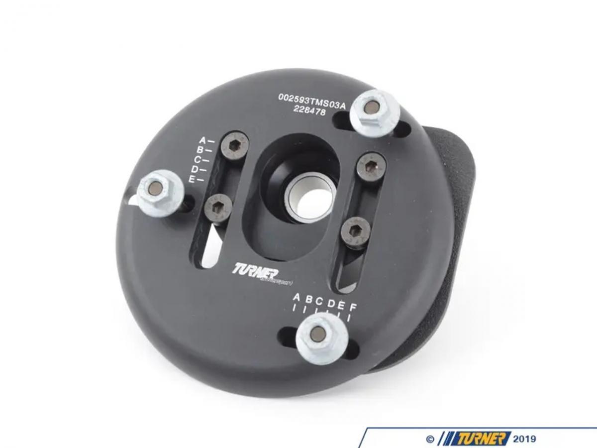

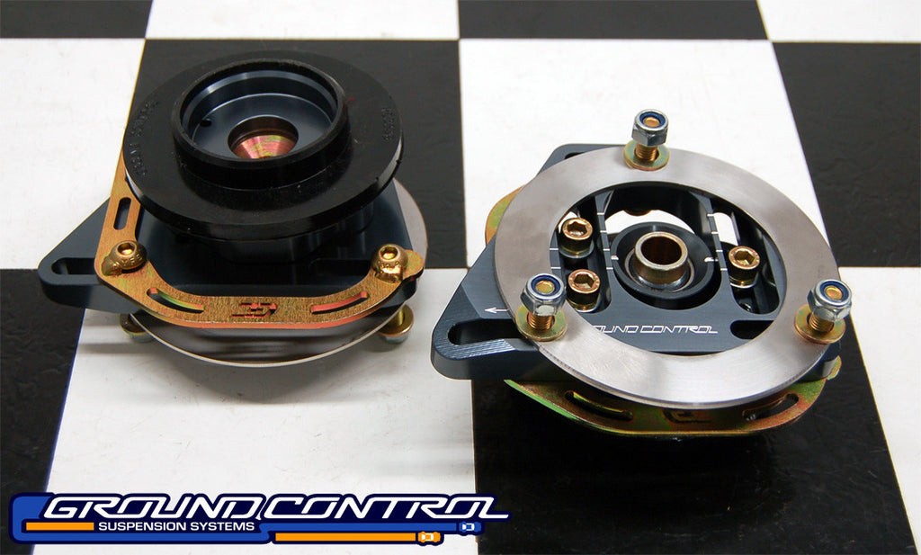

                  What about the TMS plates are different? I just installed GC and they look "the same" (functionally) as the TMS plates. Interested in learning more also...
                    Wondering the same thing. The GC has a metal plate that looks similarly sized diameter-wise to the TMS. Maybe because it's thinner it can flex and doesn't distribute the load as well as the thick billet TMS upper part?
                    Which is interesting because the strut tower reinforcement plates are thin sheet metal too.

                      Do your GC plates have the stainless steel reinforcement ring pictured above?
