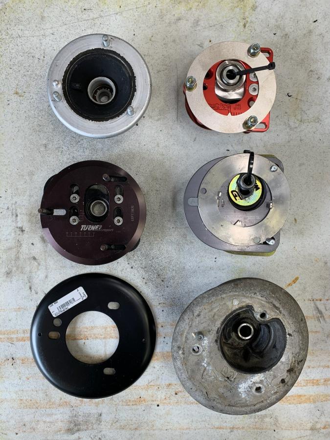

            Here are pics of:
            BMW reinforcement plate
            Stock Non-M mount
            Stock M3 mount
            GC Camber plate
            Vorshlag Camber plate
            TMS Camber plate
            Well no wonder these things are denting strut towers, look how small they are compared to stock!
              Look at the photos I posted from underneath of the GC plate indentation into the reinforcement plate. GC says they design them at an angle and I'm not sure that is helpful for the towers...

                  I don't see his post either... But I posted (2) strut towers that were cracked. One was a Vorshlag CP and the other was a stock Non-M strut mount.
                  To be clear I do not think this is a problem specific to ONE manufacturer that makes this style. I think it is when cars are driven hard or have increased spring rates on the front end WITHOUT reinforcement plates.
                  I think any of these with reinforcement plates are sufficient for 99% of the population. BUT I do also think you can get away without plates using the TMS CP as they are slightly larger in OD but the entire surface sits against the tower vs the others that is just a ring.
