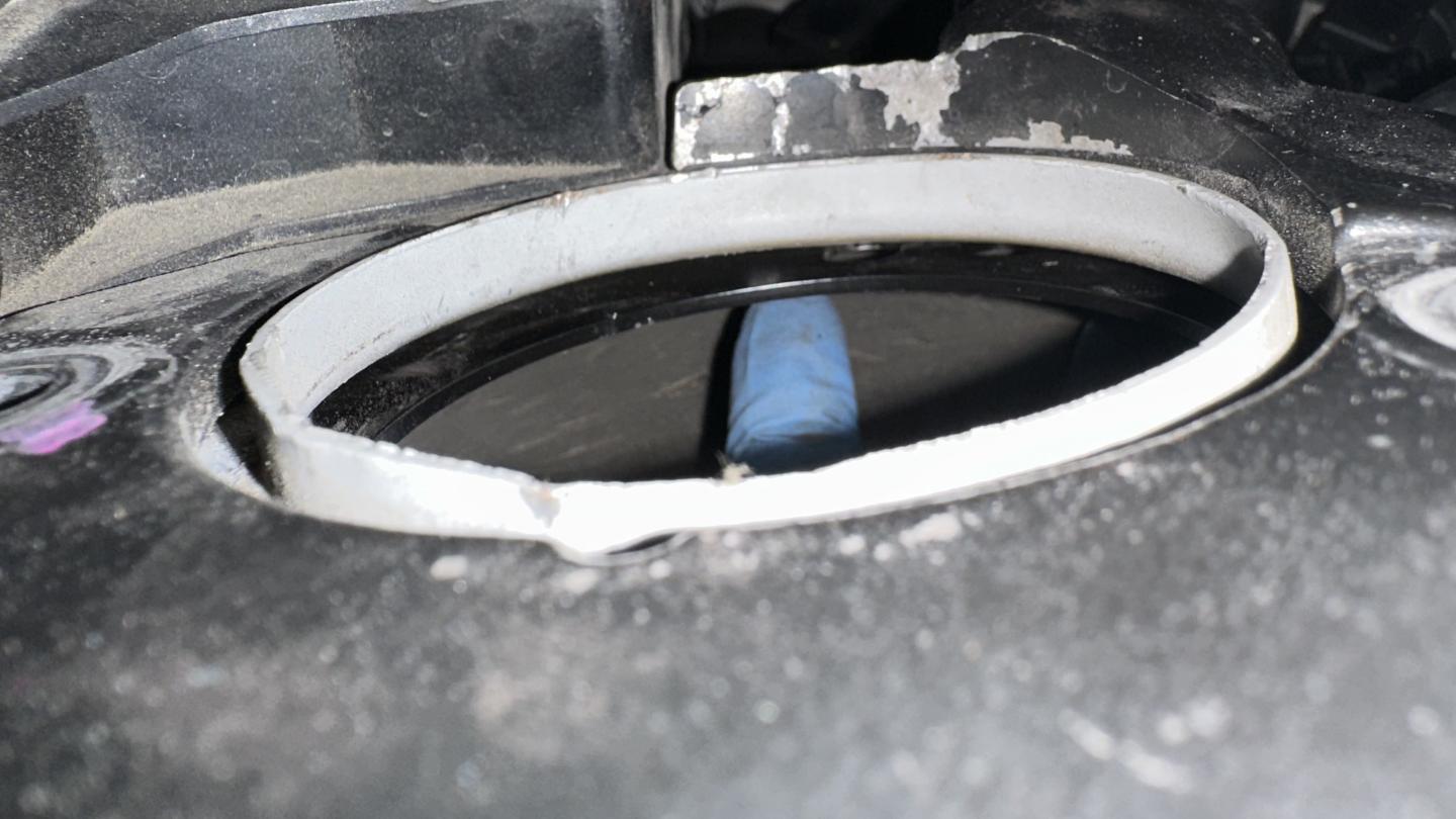

        So the reinforcement plates don’t seem to fit the shape of my 01 M3’s strut towers. Is this a known issue?

          #34
          Yes I think it's known. There are shims/spacers for the early strut towers for the top, but I don't know about the underside.
            #35
            SQ13 as mentioned in other thread, I don't think you have an issue and I'd line them up and see if they don't seat themselves. I'd bet you still have some stock top mounts you could use to test that theory
              #36
              False alarm y’all. I’m just dumb.

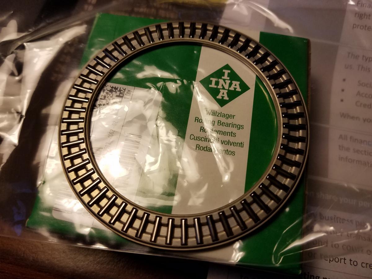

                      R1pilot those thrust sheets that SQ13 linked will do the job. I went a little more complicated with roller thrust bearings from McMaster-Carr. The setup is one bearing with 2 washers for each spring. I used the thinnest washer.Click image for larger version

                        Thank you. Now I need to measure the Ohlin spring diameter.
                        I wonder why this never happened with the stock springs/struts and the GC camber plates ... mechanically it should be the same?
                          I’m guessing you run the stock Ohlins springs up front? The lower part is 65 mm.
