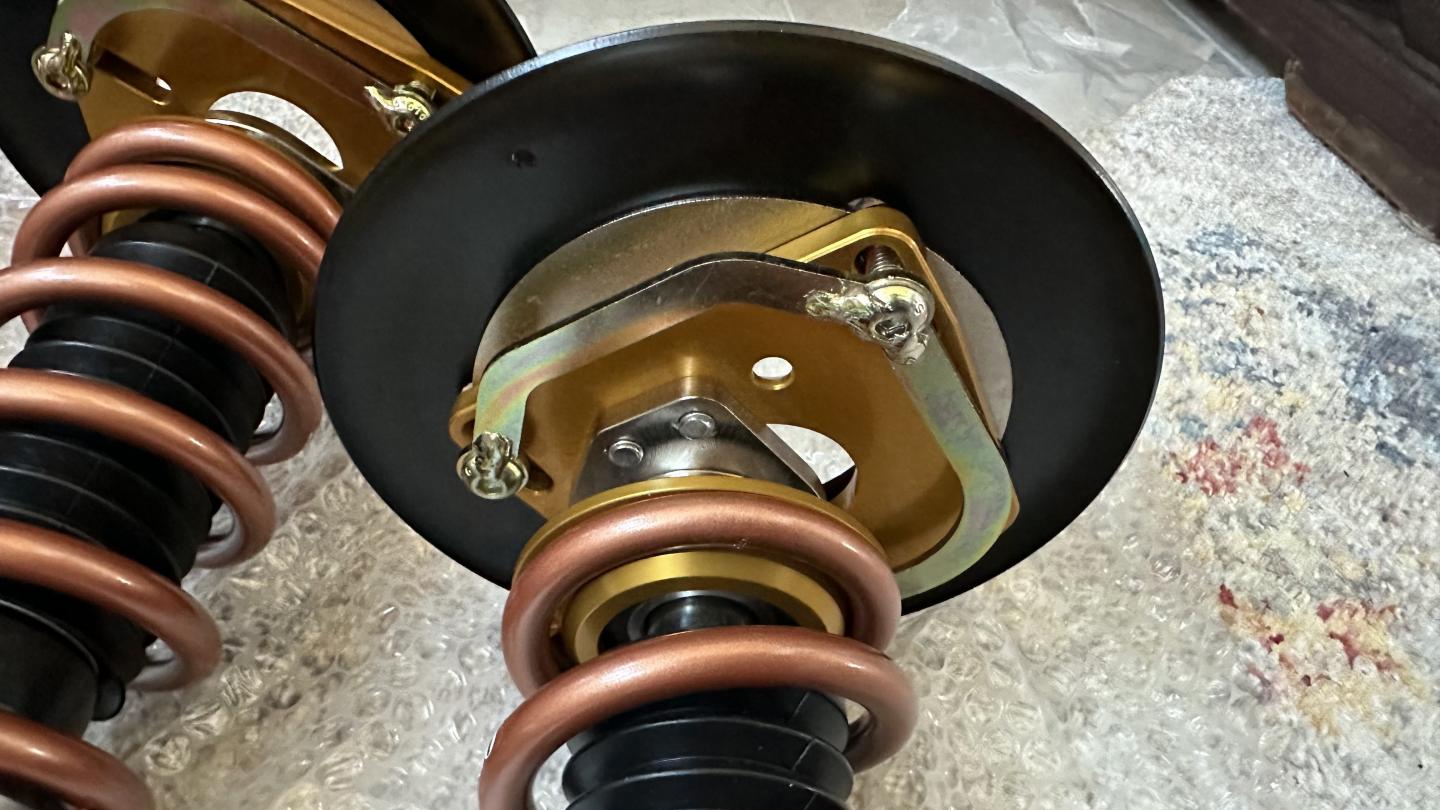

      Do your GC plates have the stainless steel reinforcement ring pictured above?
      What suspension and ride height are you running?
      I have the full GC Sport/street kit and it does have those metal rings. I'm lowered by abiut an inch vs stock height.
      The outline on the shock towers was from the outer edges of those metal rings

                Reinforcement plates with Vorshlag camber plates. Might be a good idea to get the reinforcement plates if you’re running Vorshlag or GC camber plates lol.

                  Dafuq is goin on with those welds son.
                    What exactly is wrong with the welds?
                    Most people can't tell a good weld from a bad weld. That is a tack weld. It is a good weld because the heat affected zone is small and there is fusion. Doesn't look good but does it really matter in this application? An ugly weld can be a lot stronger than a good looking weld.
                    Lots of misinformation about welds. It is common to think a good weld in titanium is colorful...actually a good weld is colorless. Color indicates loss of shielding which weakens the weld and results in corrosion. You can have a uniform pretty looking bead around and exhaust pipe and the weld will fail because it wasn't back purged.
                      Are you saying a good weld can't look good? Good and pretty aren't mutually exclusive my guy.
                        How about efficient and good? When you're making a thousand of these at a time, efficiency is key, not aesthetics
                        Though I like the new to me, pressed-in bolts that GC supplies now better than the tacked

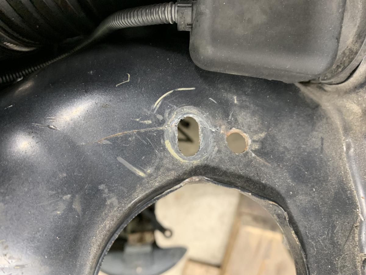

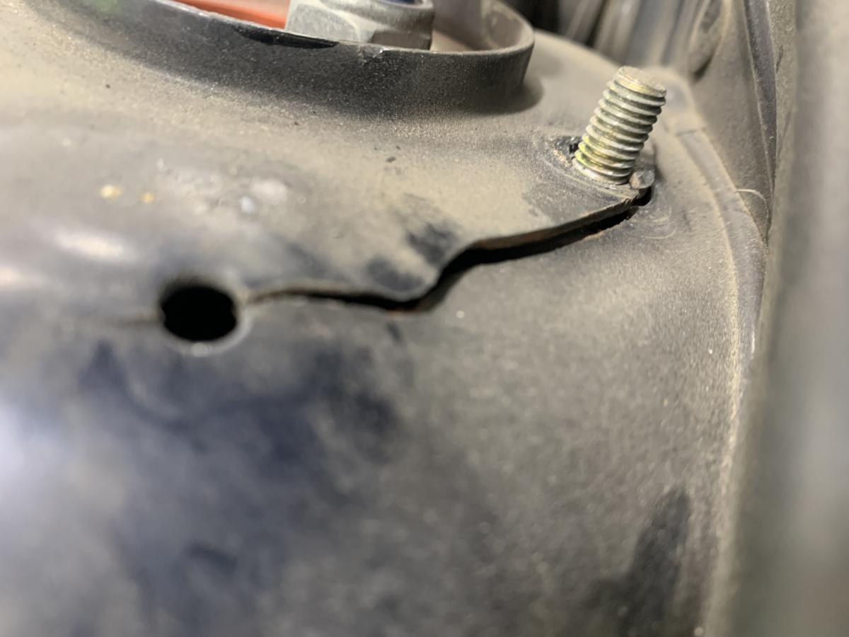

                          These are both '00 model tourings, one was on Bilsten PSS with stock Non-M strut mounts (same surface area roughly as the camber plates) and the other was on ASTs with M3 camber plates.

                            Yikes, those are scary pics.
                              You brought it up. Now please…do tell…what’s the issue with those welds?
                              but…a pretty weld can be good, can also be bad. There are many variables to consider. Sometimes, a weld has to be ugly to prevent failure.
                                This is what GC camber plates did to my strut towers after about a year.
                                I installed the reinforcement plates and it hasn't gotten worse since then, been over 10 years now.
